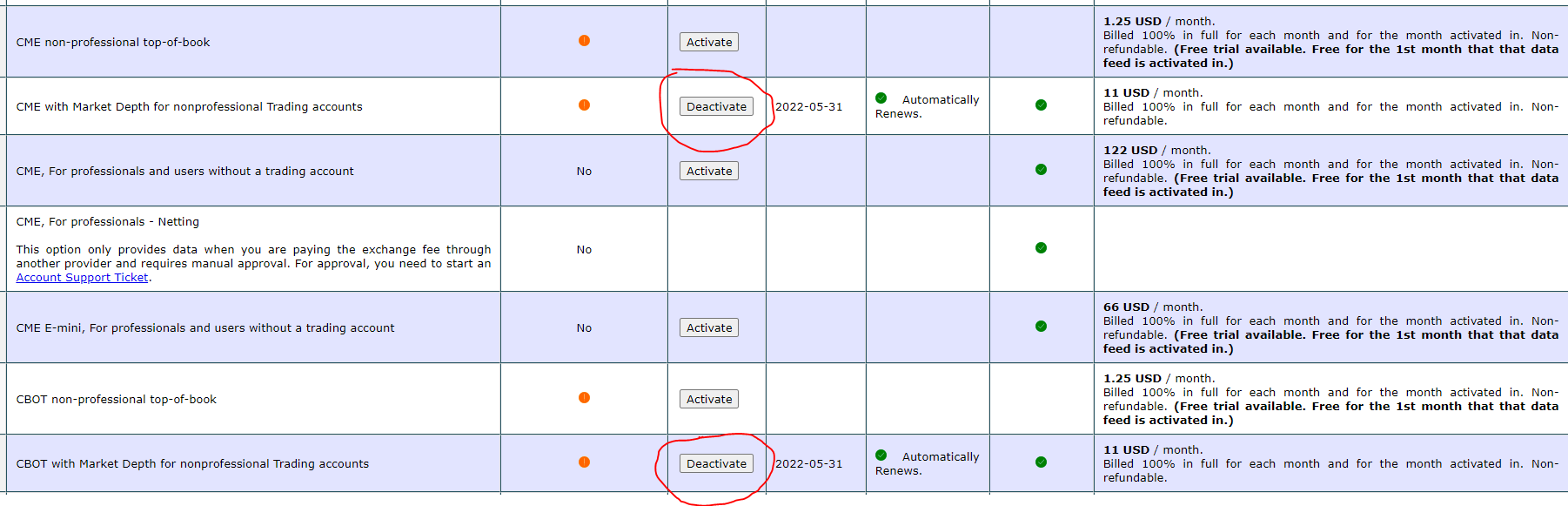

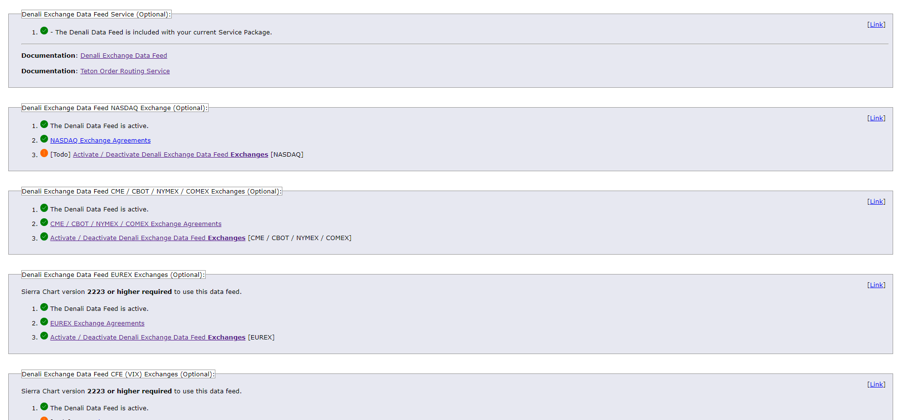

[2022-05-10 16:55:01]
Nkrastins - Posts: 38
I have a similar issue.
I have activated Denali data feed for CME/CBOT/EUREX
Eurex all good, but CBOT/CME is still delayed.
I found this
Easy Solution to CME Funded Trading Account Requirement
only I have an account with AMP, I and I had a verified account, do how do I re-verify?
imageexchanges.PNG / V - Attached On 2022-05-10 16:48:46 UTC - Size: 71.43 KB - 237 views
imageservices.PNG / V - Attached On 2022-05-10 16:48:52 UTC - Size: 50.53 KB - 212 views
imageverified.PNG / V - Attached On 2022-05-10 16:54:32 UTC - Size: 11.61 KB - 226 views
[2022-05-10 17:49:08]
John - SC Support - Posts: 48273
Nkrastins:
Since your account is with AMP, then you are most likely setup to use CQG for your order routing.
As such, you will go through the instructions at the link you posted, to connect once a month to your trading account, and at step #3 where you need to actually make the connection, you will then go through the following instructions:
CQG Trading Platform Service: Setup Instructions
[2022-05-10 18:06:16]
Ok, but that means I would have to pay every month for CQG just to get the verification done, correct?
[2022-05-10 18:13:00]
No, you would not need to pay anything for CQG. You do not need their data and if you already have an account, then you should not need to change anything - you just need to connect to that account.
