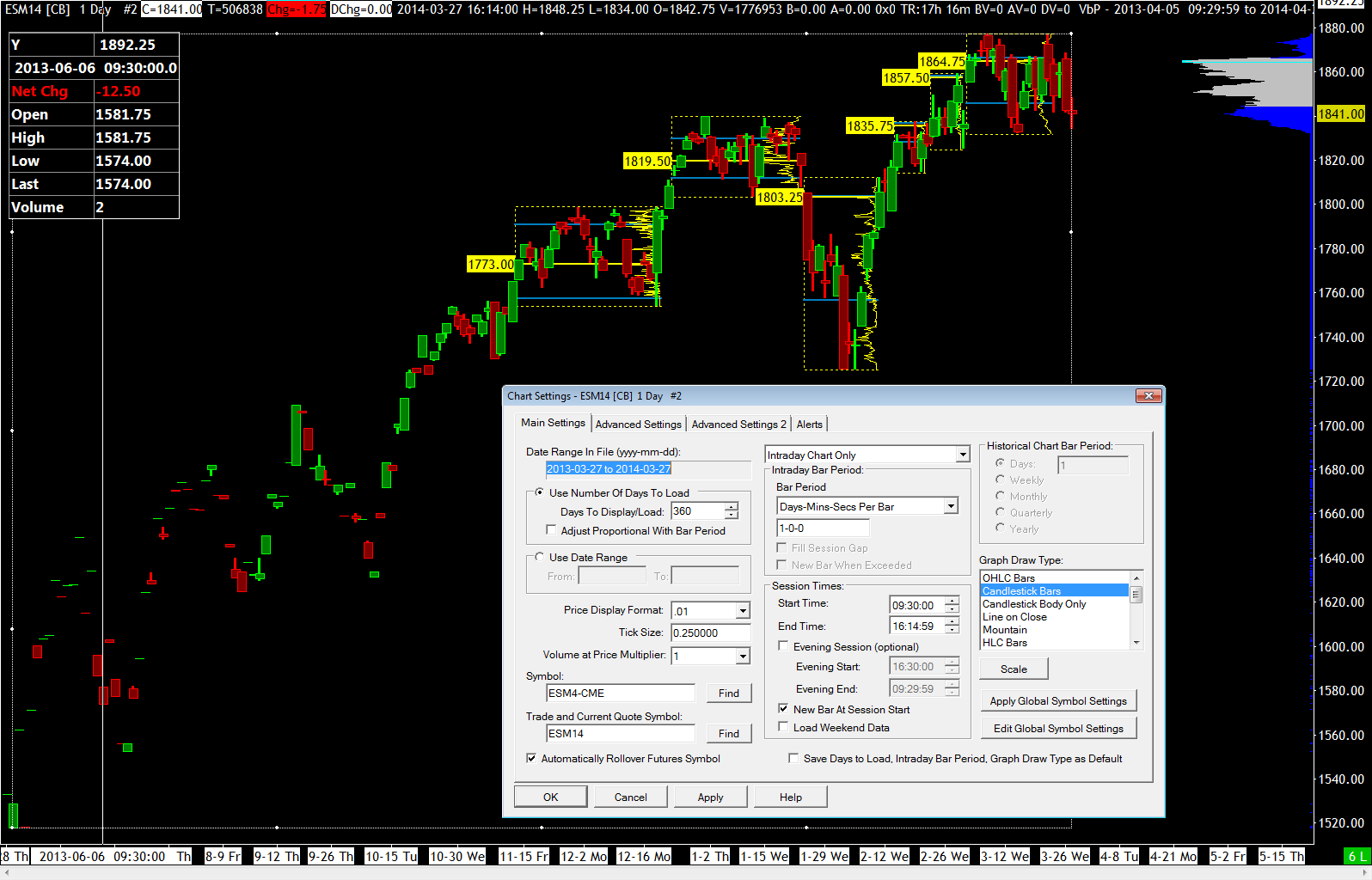

Here's a screenshot of a daily RTH chart, with 'bad' data; note the bars on the left portion of the chart, and the missing parts of the volume profile on the right margin. The real time data feed is Rithmic, and I have added the second symbol of ESM14 (not sure if this is correct or necessary for the SC Historical Data Service). The rollover choice on the first Advanced Settings tab is set to 'Continuous Futures contract - Date Rule rollover, Back Adjusted'. What am I missing.
Thanks.

[2014-03-28 00:32:52]
With Rithmic, we need to make it very clear. There is no reliable support for Continuous Futures Contracts. Unless you use the Sierra Chart Real-time and Historical Exchange Data Feed:
https://www.sierrachart.com/index.php?l=doc/SierraChartRealTimeFuturesStockDataFeed.php
This is the solution. It is an inexpensive feed. Please subscribe to it and you will solve the problems. We also need to convert your account to a normal account. Just let us know if you would like us to do that.

ESM4-CME [CB] 1 Day #1: Performing continuous futures contract back adjustment calculations. | 2014-03-28 16:47:35
ESM4-CME [CB] 1 Day #1: ESM3-CME Open price on 2013-06-13 is 1610.75. | 2014-03-28 16:47:35
ESM4-CME [CB] 1 Day #1: ESU3-CME Open price on 2013-06-13 is 1605. | 2014-03-28 16:47:35
ESM4-CME [CB] 1 Day #1: ESM3-CME price difference to ESU3-CME is -5.75. | 2014-03-28 16:47:35
ESM4-CME [CB] 1 Day #1: ESU3-CME Open price on 2013-09-12 is 1689.75. | 2014-03-28 16:47:35
ESM4-CME [CB] 1 Day #1: ESZ3-CME Open price on 2013-09-12 is 1683.25. | 2014-03-28 16:47:35
ESM4-CME [CB] 1 Day #1: ESU3-CME price difference to ESZ3-CME is -6.5. | 2014-03-28 16:47:35
ESM4-CME [CB] 1 Day #1: ESZ3-CME Open price on 2013-12-12 is 1780.75. | 2014-03-28 16:47:35
ESM4-CME [CB] 1 Day #1: ESH4-CME Open price on 2013-12-12 is 1774.25. | 2014-03-28 16:47:35
ESM4-CME [CB] 1 Day #1: ESZ3-CME price difference to ESH4-CME is -6.5. | 2014-03-28 16:47:35
ESM4-CME [CB] 1 Day #1: ESH4-CME Open price on 2014-03-13 is 1868.75. | 2014-03-28 16:47:35
ESM4-CME [CB] 1 Day #1: ESM4-CME Open price on 2014-03-13 is 1861.5. | 2014-03-28 16:47:35
ESM4-CME [CB] 1 Day #1: ESH4-CME price difference to ESM4-CME is -7.25. | 2014-03-28 16:47:35
ESM4-CME [CB] 1 Day #1: Back adjust amount for symbol ESM3-CME is -26. | 2014-03-28 16:47:35
ESM4-CME [CB] 1 Day #1: Back adjust amount for symbol ESU3-CME is -20.25. | 2014-03-28 16:47:35
ESM4-CME [CB] 1 Day #1: Back adjust amount for symbol ESZ3-CME is -13.75. | 2014-03-28 16:47:35
ESM4-CME [CB] 1 Day #1: Back adjust amount for symbol ESH4-CME is -7.25. | 2014-03-28 16:47:35
Date rule based rollover from ESH4-CME to next contract occurs at 2014-03-13 | 2014-03-28 16:47:35
Date rule based rollover from ESM4-CME to next contract occurs at 2014-06-12 | 2014-03-28 16:47:35
Checking Intraday data file for symbol ESH4-CME for the date range from 2013-12-12 to 2014-03-13 | 2014-03-28 16:47:35
Checking Daily data file for symbol ESH14 for the date range from 2013-12-12 to 2014-03-08 | 2014-03-28 16:47:35
Checking Intraday data file for symbol ESM4-CME for the date range from 2014-03-13 to 0 | 2014-03-28 16:47:35
Checking Daily data file for symbol ESM14 for the date range from 2014-03-13 to 0 | 2014-03-28 16:47:35
Symbols used for ESM4-CME continuous contract chart: | 2014-03-28 16:47:35
ESH4-CME | 2014-03-28 16:47:35
ESM4-CME | 2014-03-28 16:47:35
ESM4-CME [CB] Rev. 5t #7: Performing continuous futures contract back adjustment calculations. | 2014-03-28 16:47:35
ESM4-CME [CB] Rev. 5t #7: ESH4-CME Open price on 2014-03-13 is 1868.75. | 2014-03-28 16:47:35
ESM4-CME [CB] Rev. 5t #7: ESM4-CME Open price on 2014-03-13 is 1861.5. | 2014-03-28 16:47:35
ESM4-CME [CB] Rev. 5t #7: ESH4-CME price difference to ESM4-CME is -7.25. | 2014-03-28 16:47:35
ESM4-CME [CB] Rev. 5t #7: Back adjust amount for symbol ESH4-CME is -7.25. | 2014-03-28 16:47:35

ESM4-CME [CB] 30 Min #4: Performing continuous futures contract back adjustment calculations. | 2014-03-28 16:47:35
ESM4-CME [CB] 30 Min #4: ESM3-CME Open price on 2013-06-13 is 1610.75. | 2014-03-28 16:47:35
ESM4-CME [CB] 30 Min #4: ESU3-CME Open price on 2013-06-13 is 1605. | 2014-03-28 16:47:35
ESM4-CME [CB] 30 Min #4: ESM3-CME price difference to ESU3-CME is -5.75. | 2014-03-28 16:47:35
ESM4-CME [CB] 30 Min #4: ESU3-CME Open price on 2013-09-12 is 1689.75. | 2014-03-28 16:47:35
ESM4-CME [CB] 30 Min #4: ESZ3-CME Open price on 2013-09-12 is 1683.25. | 2014-03-28 16:47:35
ESM4-CME [CB] 30 Min #4: ESU3-CME price difference to ESZ3-CME is -6.5. | 2014-03-28 16:47:35
ESM4-CME [CB] 30 Min #4: ESZ3-CME Open price on 2013-12-12 is 1780.75. | 2014-03-28 16:47:35
ESM4-CME [CB] 30 Min #4: ESH4-CME Open price on 2013-12-12 is 1774.25. | 2014-03-28 16:47:35
ESM4-CME [CB] 30 Min #4: ESZ3-CME price difference to ESH4-CME is -6.5. | 2014-03-28 16:47:35
ESM4-CME [CB] 30 Min #4: ESH4-CME Open price on 2014-03-13 is 1868.75. | 2014-03-28 16:47:35
ESM4-CME [CB] 30 Min #4: ESM4-CME Open price on 2014-03-13 is 1861.5. | 2014-03-28 16:47:35
ESM4-CME [CB] 30 Min #4: ESH4-CME price difference to ESM4-CME is -7.25. | 2014-03-28 16:47:35
ESM4-CME [CB] 30 Min #4: Back adjust amount for symbol ESM3-CME is -26. | 2014-03-28 16:47:35
ESM4-CME [CB] 30 Min #4: Back adjust amount for symbol ESU3-CME is -20.25. | 2014-03-28 16:47:35
ESM4-CME [CB] 30 Min #4: Back adjust amount for symbol ESZ3-CME is -13.75. | 2014-03-28 16:47:35
ESM4-CME [CB] 30 Min #4: Back adjust amount for symbol ESH4-CME is -7.25. | 2014-03-28 16:47:35

HD Request # 4 - Downloading Intraday chart data for ESM4-CME to the file ESM4-CME.scid. Service: cme | 2014-03-28 16:50:10
HD Request # 4 - Truncating file to starting Date-Time of 2013-04-01 20:00:00 | 2014-03-28 16:50:10
HD Request # 4 - Download start Date-Time: 2013-04-01 19:59:59.0 | 2014-03-28 16:50:10
HD Request # 4 - Using server: scdf2.sierracharts.com port 10149 | 2014-03-28 16:50:10
Resolved address ds7.sierracharts.com to IP 8.18.161.133 | 2014-03-28 16:50:10
The network socket is connected. | 2014-03-28 16:50:10
HD Request # 4 - Sending historical data logon request message. | 2014-03-28 16:50:10
HD Request # 4 - Requesting Intraday data. Start Date-Time: 2013-04-01 23:59:59. Record interval: 0 | 2014-03-28 16:50:10
HD Request # 4 - Decompressing data. | 2014-03-28 16:50:10
HD Request # 4 - Receiving Intraday data for ESM4-CME starting at 2013-11-04 04:46:14 | 2014-03-28 16:50:10
HD Request # 4 - Timestamp of first Intraday data file record written: 2013-11-04 04:46:14 | 2014-03-28 16:50:10
Socket has been shutdown and closed. | 2014-03-28 16:50:18
The network socket for historical data has been closed. | 2014-03-28 16:50:18
HD Request # 4 - Received 5346265 records from 2013-11-04 04:46:14 to 2014-03-28 16:50:05 (144.5 days) and wrote 5346265 records for ESM4-CME | 2014-03-28 16:50:18
HD Request # 4 - Intraday download COMPLETE for ESM4-CME | 2014-03-28 16:50:18
Real-time Intraday chart data file updates started for ESM4-CME | 2014-03-28 16:50:18
HD Request # 4 - Reloading Intraday charts for symbol. | 2014-03-28 16:50:18
Reloading all charts with filename: ESM4-CME.scid | 2014-03-28 16:50:18

Intraday data file for ESZ3-CME exists and is empty. Skipping Intraday data download. | 2014-03-28 16:50:18
Checking Daily data file for symbol ESZ13 for the date range from 2013-09-12 to 2013-12-07 | 2014-03-28 16:50:18
Checking Intraday data file for symbol ESH4-CME for the date range from 2013-12-12 to 2014-03-13 | 2014-03-28 16:50:18
Checking Daily data file for symbol ESH14 for the date range from 2013-12-12 to 2014-03-08 | 2014-03-28 16:50:18
Checking Intraday data file for symbol ESM4-CME for the date range from 2014-03-13 to 0 | 2014-03-28 16:50:18
Checking Daily data file for symbol ESM14 for the date range from 2014-03-13 to 0 | 2014-03-28 16:50:18
Symbols used for ESM4-CME continuous contract chart: | 2014-03-28 16:50:18
ESM3-CME | 2014-03-28 16:50:18
ESU3-CME | 2014-03-28 16:50:18
ESZ3-CME | 2014-03-28 16:50:18
ESH4-CME | 2014-03-28 16:50:18
ESM4-CME [CB] [M] 1 Day #2: Performing continuous futures contract back adjustment calculations. | 2014-03-28 16:50:18
ESM4-CME [CB] [M] 1 Day #2: ESM3-CME Open price on 2013-06-13 is 1610.75. | 2014-03-28 16:50:18
ESM4-CME [CB] [M] 1 Day #2: ESU3-CME Open price on 2013-06-13 is 1605. | 2014-03-28 16:50:18
ESM4-CME [CB] [M] 1 Day #2: ESM3-CME price difference to ESU3-CME is -5.75. | 2014-03-28 16:50:18
ESM4-CME [CB] [M] 1 Day #2: ESU3-CME Open price on 2013-09-12 is 1689.75. | 2014-03-28 16:50:18
ESM4-CME [CB] [M] 1 Day #2: ESZ3-CME Open price on 2013-09-12 is 1683.25. | 2014-03-28 16:50:18
ESM4-CME [CB] [M] 1 Day #2: ESU3-CME price difference to ESZ3-CME is -6.5. | 2014-03-28 16:50:18
ESM4-CME [CB] [M] 1 Day #2: ESZ3-CME Open price on 2013-12-12 is 1780.75. | 2014-03-28 16:50:19
ESM4-CME [CB] [M] 1 Day #2: ESH4-CME Open price on 2013-12-12 is 1774.25. | 2014-03-28 16:50:19
ESM4-CME [CB] [M] 1 Day #2: ESZ3-CME price difference to ESH4-CME is -6.5. | 2014-03-28 16:50:19
ESM4-CME [CB] [M] 1 Day #2: ESH4-CME Open price on 2014-03-13 is 1868.75. | 2014-03-28 16:50:19
ESM4-CME [CB] [M] 1 Day #2: ESM4-CME Open price on 2014-03-13 is 1861.5. | 2014-03-28 16:50:19
ESM4-CME [CB] [M] 1 Day #2: ESH4-CME price difference to ESM4-CME is -7.25. | 2014-03-28 16:50:19
ESM4-CME [CB] [M] 1 Day #2: Back adjust amount for symbol ESM3-CME is -26. | 2014-03-28 16:50:19
ESM4-CME [CB] [M] 1 Day #2: Back adjust amount for symbol ESU3-CME is -20.25. | 2014-03-28 16:50:19
ESM4-CME [CB] [M] 1 Day #2: Back adjust amount for symbol ESZ3-CME is -13.75. | 2014-03-28 16:50:19
ESM4-CME [CB] [M] 1 Day #2: Back adjust amount for symbol ESH4-CME is -7.25. | 2014-03-28 16:50:19
Date rule based rollover from ESM3-CME to next contract occurs at 2013-06-13 | 2014-03-28 16:50:19
Date rule based rollover from ESU3-CME to next contract occurs at 2013-09-12 | 2014-03-28 16:50:19
Date rule based rollover from ESZ3-CME to next contract occurs at 2013-12-12 | 2014-03-28 16:50:19
Date rule based rollover from ESH4-CME to next contract occurs at 2014-03-13 | 2014-03-28 16:50:19
Date rule based rollover from ESM4-CME to next contract occurs at 2014-06-12 | 2014-03-28 16:50:19
Intraday data file for ESM3-CME exists and is empty. Skipping Intraday data download. | 2014-03-28 16:50:19
Checking Daily data file for symbol ESM13 for the date range from 2013-03-07 to 2013-06-08 | 2014-03-28 16:50:19
Intraday data file for ESU3-CME exists and is empty. Skipping Intraday data download. | 2014-03-28 16:50:19
Checking Daily data file for symbol ESU13 for the date range from 2013-06-13 to 2013-09-07 | 2014-03-28 16:50:19
Intraday data file for ESZ3-CME exists and is empty. Skipping Intraday data download. | 2014-03-28 16:50:19
Checking Daily data file for symbol ESZ13 for the date range from 2013-09-12 to 2013-12-07 | 2014-03-28 16:50:19
Checking Intraday data file for symbol ESH4-CME for the date range from 2013-12-12 to 2014-03-13 | 2014-03-28 16:50:19
Checking Daily data file for symbol ESH14 for the date range from 2013-12-12 to 2014-03-08 | 2014-03-28 16:50:19
Checking Intraday data file for symbol ESM4-CME for the date range from 2014-03-13 to 0 | 2014-03-28 16:50:19
Checking Daily data file for symbol ESM14 for the date range from 2014-03-13 to 0 | 2014-03-28 16:50:19
Symbols used for ESM4-CME continuous contract chart: | 2014-03-28 16:50:19
ESM3-CME | 2014-03-28 16:50:19
ESU3-CME | 2014-03-28 16:50:19
ESZ3-CME | 2014-03-28 16:50:19
ESH4-CME | 2014-03-28 16:50:19
ESM4-CME | 2014-03-28 16:50:19
ESM4-CME [CB] [M] 1 Day #1: Performing continuous futures contract back adjustment calculations. | 2014-03-28 16:50:19
ESM4-CME [CB] [M] 1 Day #1: ESM3-CME Open price on 2013-06-13 is 1610.75. | 2014-03-28 16:50:19
ESM4-CME [CB] [M] 1 Day #1: ESU3-CME Open price on 2013-06-13 is 1605. | 2014-03-28 16:50:19
ESM4-CME [CB] [M] 1 Day #1: ESM3-CME price difference to ESU3-CME is -5.75. | 2014-03-28 16:50:19
ESM4-CME [CB] [M] 1 Day #1: ESU3-CME Open price on 2013-09-12 is 1689.75. | 2014-03-28 16:50:19
ESM4-CME [CB] [M] 1 Day #1: ESZ3-CME Open price on 2013-09-12 is 1683.25. | 2014-03-28 16:50:19
ESM4-CME [CB] [M] 1 Day #1: ESU3-CME price difference to ESZ3-CME is -6.5. | 2014-03-28 16:50:19
ESM4-CME [CB] [M] 1 Day #1: ESZ3-CME Open price on 2013-12-12 is 1780.75. | 2014-03-28 16:50:19
ESM4-CME [CB] [M] 1 Day #1: ESH4-CME Open price on 2013-12-12 is 1774.25. | 2014-03-28 16:50:19
ESM4-CME [CB] [M] 1 Day #1: ESZ3-CME price difference to ESH4-CME is -6.5. | 2014-03-28 16:50:19
ESM4-CME [CB] [M] 1 Day #1: ESH4-CME Open price on 2014-03-13 is 1868.75. | 2014-03-28 16:50:19
ESM4-CME [CB] [M] 1 Day #1: ESM4-CME Open price on 2014-03-13 is 1861.5. | 2014-03-28 16:50:19
ESM4-CME [CB] [M] 1 Day #1: ESH4-CME price difference to ESM4-CME is -7.25. | 2014-03-28 16:50:19
ESM4-CME [CB] [M] 1 Day #1: Back adjust amount for symbol ESM3-CME is -26. | 2014-03-28 16:50:19
ESM4-CME [CB] [M] 1 Day #1: Back adjust amount for symbol ESU3-CME is -20.25. | 2014-03-28 16:50:19
ESM4-CME [CB] [M] 1 Day #1: Back adjust amount for symbol ESZ3-CME is -13.75. | 2014-03-28 16:50:19
ESM4-CME [CB] [M] 1 Day #1: Back adjust amount for symbol ESH4-CME is -7.25. | 2014-03-28 16:50:19
Date rule based rollover from ESH4-CME to next contract occurs at 2014-03-13 | 2014-03-28 16:50:20
Date rule based rollover from ESM4-CME to next contract occurs at 2014-06-12 | 2014-03-28 16:50:20
Checking Intraday data file for symbol ESH4-CME for the date range from 2013-12-12 to 2014-03-13 | 2014-03-28 16:50:20
Checking Daily data file for symbol ESH14 for the date range from 2013-12-12 to 2014-03-08 | 2014-03-28 16:50:20
Checking Intraday data file for symbol ESM4-CME for the date range from 2014-03-13 to 0 | 2014-03-28 16:50:20
Checking Daily data file for symbol ESM14 for the date range from 2014-03-13 to 0 | 2014-03-28 16:50:20
Symbols used for ESM4-CME continuous contract chart: | 2014-03-28 16:50:20
ESH4-CME | 2014-03-28 16:50:20
ESM4-CME | 2014-03-28 16:50:20
ESM4-CME [CB] [M] Rev. 5t #7: Performing continuous futures contract back adjustment calculations. | 2014-03-28 16:50:20
ESM4-CME [CB] [M] Rev. 5t #7: ESH4-CME Open price on 2014-03-13 is 1868.75. | 2014-03-28 16:50:20
ESM4-CME [CB] [M] Rev. 5t #7: ESM4-CME Open price on 2014-03-13 is 1861.5. | 2014-03-28 16:50:20
ESM4-CME [CB] [M] Rev. 5t #7: ESH4-CME price difference to ESM4-CME is -7.25. | 2014-03-28 16:50:20
ESM4-CME [CB] [M] Rev. 5t #7: Back adjust amount for symbol ESH4-CME is -7.25. | 2014-03-28 16:50:20
Date rule based rollover from ESM3-CME to next contract occurs at 2013-06-13 | 2014-03-28 16:50:20
Date rule based rollover from ESU3-CME to next contract occurs at 2013-09-12 | 2014-03-28 16:50:20
Date rule based rollover from ESZ3-CME to next contract occurs at 2013-12-12 | 2014-03-28 16:50:20
Intraday data file for ESM3-CME exists and is empty. Skipping Intraday data download. | 2014-03-28 16:50:20
Checking Daily data file for symbol ESM13 for the date range from 2013-03-07 to 2013-06-08 | 2014-03-28 16:50:20
Intraday data file for ESU3-CME exists and is empty. Skipping Intraday data download. | 2014-03-28 16:50:20
Checking Daily data file for symbol ESU13 for the date range from 2013-06-13 to 2013-09-07 | 2014-03-28 16:50:20
Intraday data file for ESZ3-CME exists and is empty. Skipping Intraday data download. | 2014-03-28 16:50:20
Checking Daily data file for symbol ESZ13 for the date range from 2013-09-12 to 2013-12-07 | 2014-03-28 16:50:20
ESM3-CME | 2014-03-28 16:50:20
ESU3-CME | 2014-03-28 16:50:20
ESZ3-CME | 2014-03-28 16:50:20
ESM4-CME [CB] [M] 30 Min #4: Performing continuous futures contract back adjustment calculations. | 2014-03-28 16:50:20
ESM4-CME [CB] [M] 30 Min #4: ESM3-CME Open price on 2013-06-13 is 1610.75. | 2014-03-28 16:50:20
ESM4-CME [CB] [M] 30 Min #4: ESU3-CME Open price on 2013-06-13 is 1605. | 2014-03-28 16:50:20
ESM4-CME [CB] [M] 30 Min #4: ESM3-CME price difference to ESU3-CME is -5.75. | 2014-03-28 16:50:20
ESM4-CME [CB] [M] 30 Min #4: ESU3-CME Open price on 2013-09-12 is 1689.75. | 2014-03-28 16:50:20
ESM4-CME [CB] [M] 30 Min #4: ESZ3-CME Open price on 2013-09-12 is 1683.25. | 2014-03-28 16:50:20
ESM4-CME [CB] [M] 30 Min #4: ESU3-CME price difference to ESZ3-CME is -6.5. | 2014-03-28 16:50:20
ESM4-CME [CB] [M] 30 Min #4: ESZ3-CME Open price on 2013-12-12 is 1780.75. | 2014-03-28 16:50:20
ESM4-CME [CB] [M] 30 Min #4: ESH4-CME Open price on 2013-12-12 is 1774.25. | 2014-03-28 16:50:20
ESM4-CME [CB] [M] 30 Min #4: ESZ3-CME price difference to ESH4-CME is -6.5. | 2014-03-28 16:50:20
ESM4-CME [CB] [M] 30 Min #4: ESH4-CME Open price on 2014-03-13 is 1868.75. | 2014-03-28 16:50:20
ESM4-CME [CB] [M] 30 Min #4: ESM4-CME Open price on 2014-03-13 is 1861.5. | 2014-03-28 16:50:20
ESM4-CME [CB] [M] 30 Min #4: ESH4-CME price difference to ESM4-CME is -7.25. | 2014-03-28 16:50:20
ESM4-CME [CB] [M] 30 Min #4: Back adjust amount for symbol ESM3-CME is -26. | 2014-03-28 16:50:20
ESM4-CME [CB] [M] 30 Min #4: Back adjust amount for symbol ESU3-CME is -20.25. | 2014-03-28 16:50:20
ESM4-CME [CB] [M] 30 Min #4: Back adjust amount for symbol ESZ3-CME is -13.75. | 2014-03-28 16:50:20
ESM4-CME [CB] [M] 30 Min #4: Back adjust amount for symbol ESH4-CME is -7.25. | 2014-03-28 16:50:20
[2014-03-28 21:14:57]
Follow through the procedure here to do a full re-download of the data:
https://www.sierrachart.com/index.php?l=doc/doc_ContinuousFuturesContractCharts.html#ReDownloading
Be sure to re-download the data for each contract. This may be necessary to clear out the older data from the previous Rithmic connection and get the fresh data from the Sierra Chart server.
If you still have a problem we could call in about 20 minutes.
[2014-03-28 21:35:57]
User83762 - Posts: 61
I tried that previously for each chart, it had no affect. This time it worked for all but one intraday chart. Please call.
