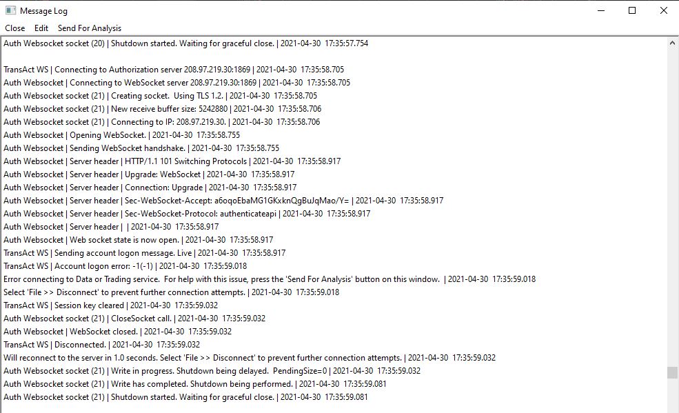

I followed the instructions but haven't been able logon to my Transact account. Is this an issue on my end or with Transact? I have attached the error and log.

imageMessage Log.JPG / V - Attached On 2021-04-30 17:52:09 UTC - Size: 137.81 KB - 454 views
imageLogonError.JPG / V - Attached On 2021-04-30 17:52:29 UTC - Size: 19.46 KB - 440 views

That is a TransAct issue. You need to let them know about it, and they can fix it for you. Refer to the information here:
https://www.sierrachart.com/index.php?page=doc/TransAct.php#AccountLogonError
