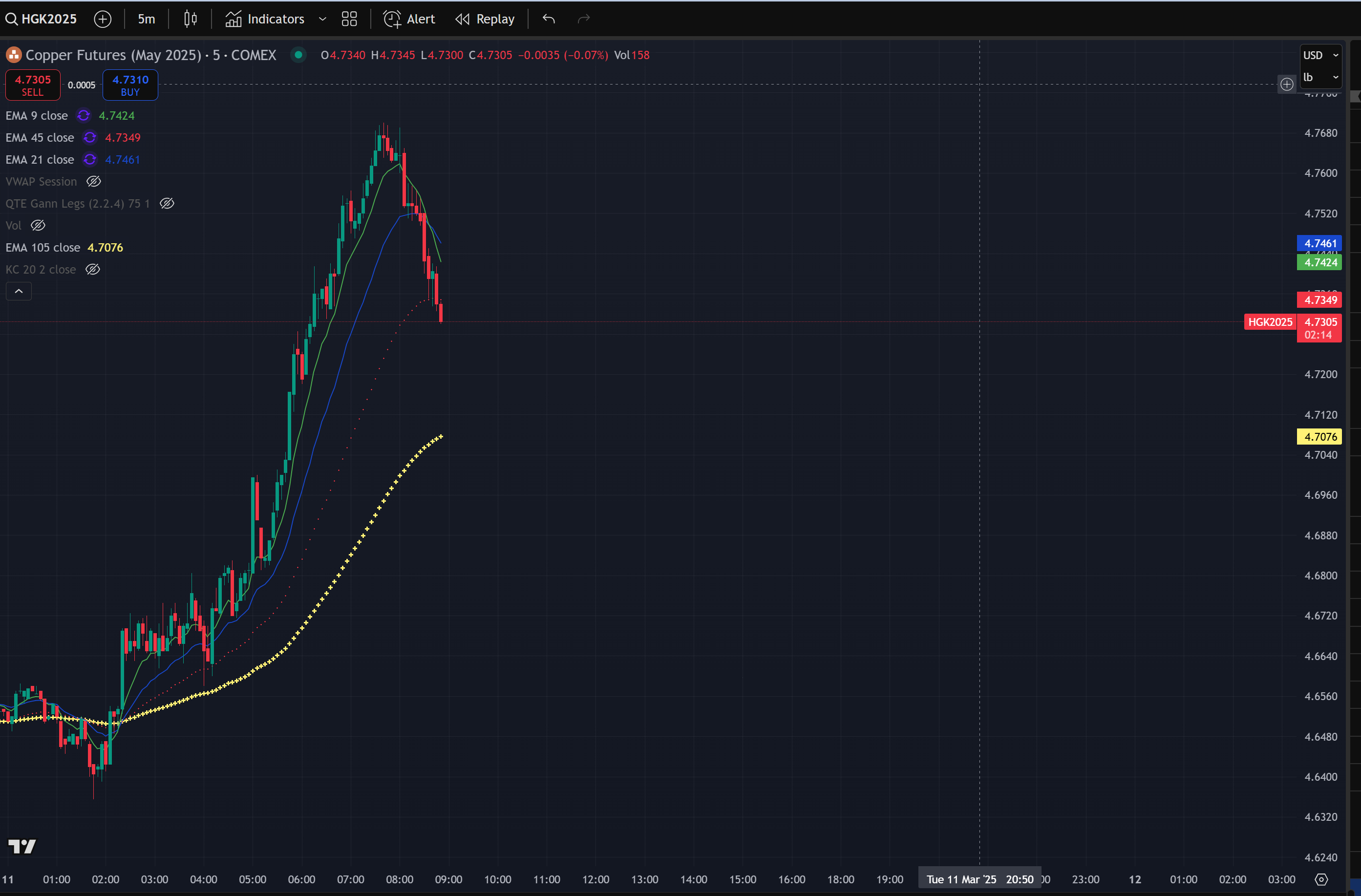

[2025-03-11 13:08:08]
goldstar_g - Posts: 1
I am having lagged data on my 5 minute charts. I have Denali activated and it was working till a few days ago. How do I debug why this is happening?
I tried to look at this ticket to "allow suport for sierra charts" Disconnected/Reconnected and I am still having issues.
I am not having data lag for NQ. Only for HG.
Date Time Of Last Edit: 2025-03-11 14:12:37
imagesierra_charts_HGK2025_5min.PNG / V - Attached On 2025-03-11 13:07:24 UTC - Size: 94.64 KB - 302 views
imagetrading_view_HGK2025_5min.PNG / V - Attached On 2025-03-11 13:07:28 UTC - Size: 374.86 KB - 303 views
[2025-03-11 15:44:05]
HG (High Grade Copper) is traded on the COMEX exchange. You only have the "CME with Market Depth for Non-Professional Trading Accounts" active, so you will get the HG data as delayed streaming data.
