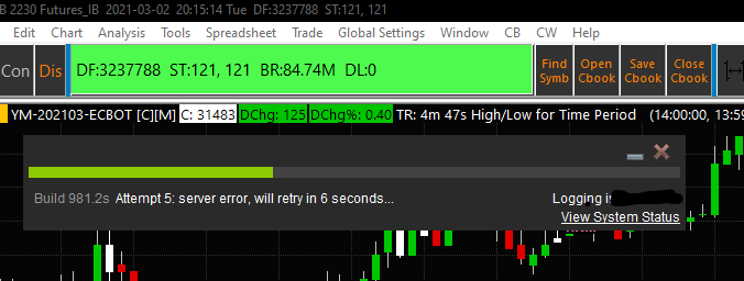

I uncovered a different big problem using SC with IB and SC data feeds (Denali or SC Historical/Intraday). You launch the IB Gateway (or TWS) then probably everyone, myself included, minimize it or it's in the background -- Sierra Chart becomes the focused trading platform. Last night I realized that the IB Gateway wasn't connected, it was trying to re-login (was minimized so couldn't see it), looked at Sierra Chart - green, still connected, still receiving data/quotes etc then it hit me, that's SC feed, orders are routed through IB. Unsurprisingly, I placed a few orders in the DOM, market moved right passed them, obviously they weren't submitted, no notification because the connection at IB was down. Last night IB was down for 30 min...
If the SC data feed(s) has problems you see and hear the disconnect, warning the user to take action. Using SC with your data feeds connected to IB, the end user has no way of knowing if IB's connection to send orders is down... Conversely if I was using SC and IB's data feed you'd see and hear the disconnect allowing users to take action (login to web portal, call broker manual trade, etc).
Thoughts besides don't use SC data feeds with IB? ;-) SC does check/verify the IB Gateway connection at startup but maybe doesn't monitor after? Could you all setup to monitor? Maybe a pop-up window alerting that it's not connected anymore?
Date Time Of Last Edit: 2021-02-27 01:44:31

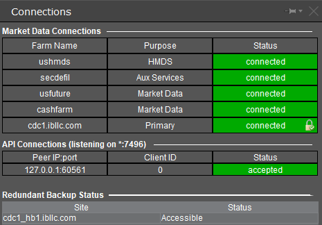

I don't want to speak in absolutes because maybe I'm doing something wrong, however, it happens every night. Here is a screenshot with the IB Gateway 'NOT' connected yet the status connection is green...
Tonight I watched this for 20 minutes to see if SC status would turn yellow and it did not.
imageIB Gateway.png / V - Attached On 2021-03-03 05:18:52 UTC - Size: 20.86 KB - 583 views

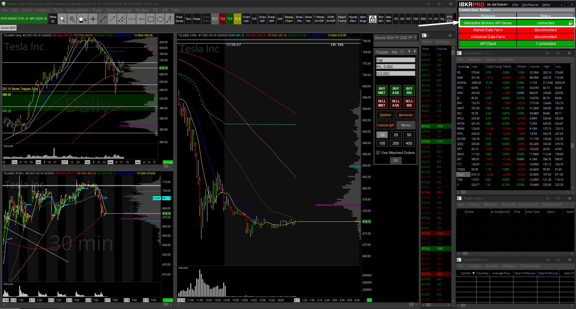

Using SC Since 2020 - Posts: 150
Neo, I use the IB Gateway, and from what I've noticed, when IB has trading interruptions, the "Interactive Brokers API Server" usually goes red. I haven't been able to test all situations of course, so I'm not sure it's a 100% indication of not being able to trade (apart from a SC -> IB interruption for some reason). My short-term solution is simply to keep the IB gateway visible. See attached screenshot. So far, if API Server goes red, then no order execution is possible.
imageIBKR gateway shows connection.png / V - Attached On 2021-03-17 01:04:31 UTC - Size: 227.16 KB - 773 views
[2021-03-17 02:55:08]
user_xyz - Posts: 529
Risk101 - Nice setup and dark theme! At first I thought how on earth did you get that then I realized I think you are using SC on Linux...? I have a dedicated trading rig and I'm getting pretty close to changing OS from Windows to Linux for that simple reason, the light grey borders drive me crazy!
Regarding IB, the Denali Feed & SC I think your suggestion and layout is a necessity you simply have to be able to monitor the IB connection since SC isn't and it happens daily (at 12am) and at least a few other times a month. You are correct if the API server is red, orders are not routed and if you are using the Denali Feed SC will still show green.
I am actually going to turn off the Denali Feed entirely on my IB SC instance and use IB's data feed connection. My situation is slightly different, I use another instance of SC/Denali with another broker as my primary and place trades based on that setup into the IB one. So in my case I'm not really relying on the Denali feed for that particular IB/SC setup. I'm curious too if SC will show yellow/disconnect during those times, I think so because I believe IB uses a single connection for Data Feeds and Order Routing...
Date Time Of Last Edit: 2021-03-17 02:55:41

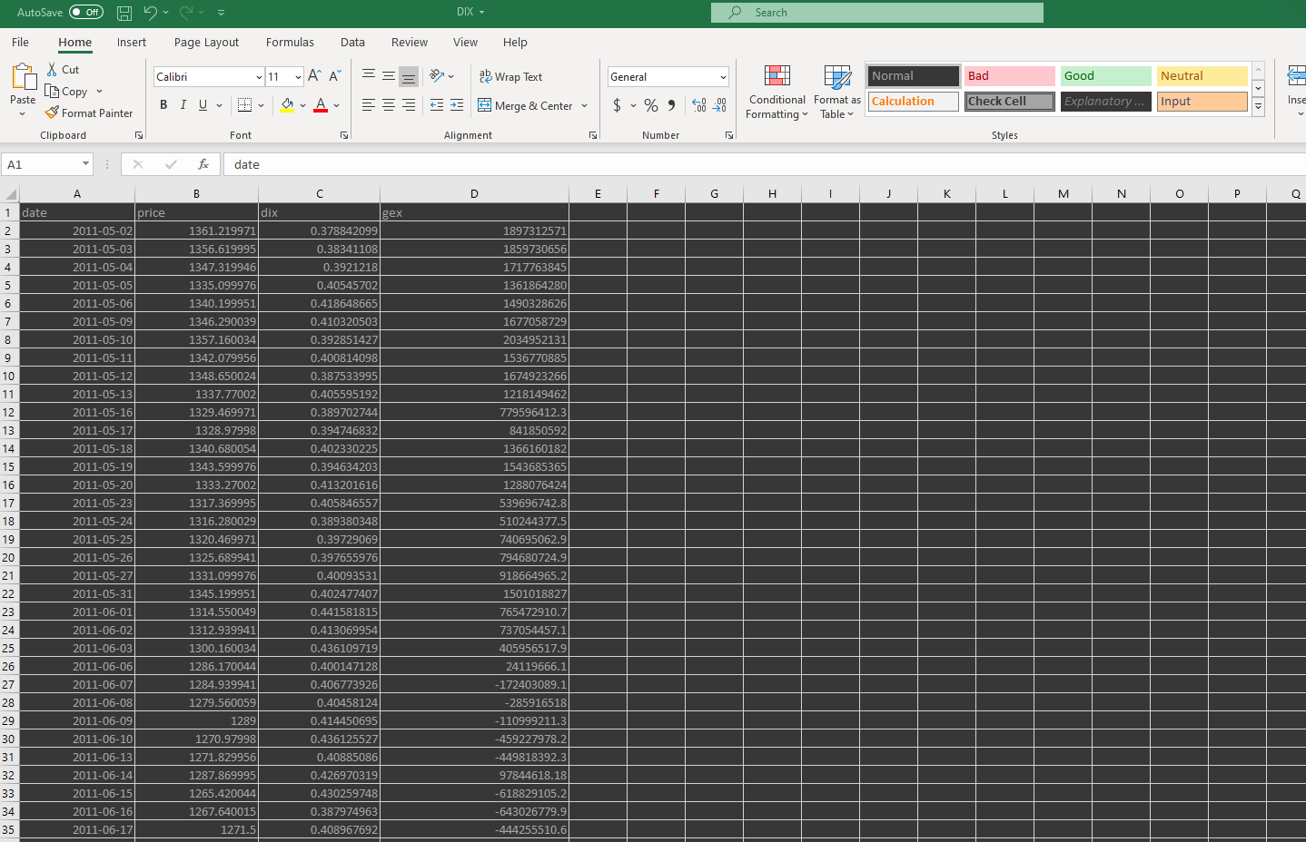

See attached for Excel. The theme does NOT use MSFT's High Contrast mode. But I have had to turn off the dark theme for things like, gulp, Turbotax. :)
imageExcel.png / V - Attached On 2021-03-17 05:11:22 UTC - Size: 98.53 KB - 632 views

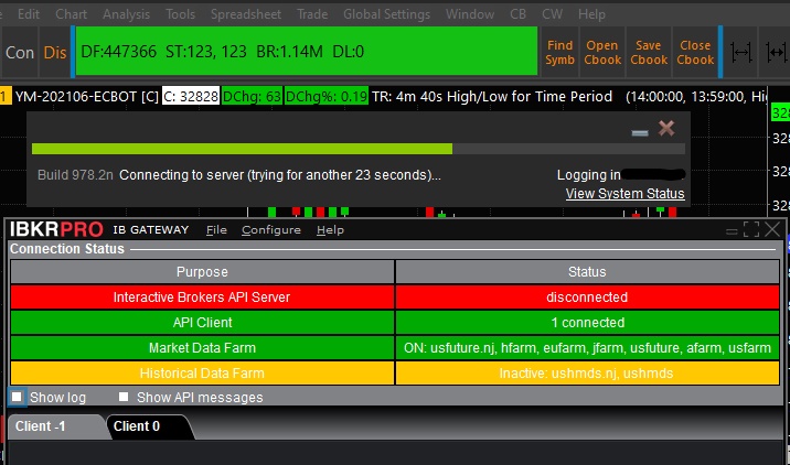

Welp see attached. I tested tonight with the same result. It appears that IB does not use the same pipe for market data & order routing, also checked with netstat and indeed different servers for market data and order routing. So in this case I was still getting market data from IB (green connection in SC) and as expected placing orders the market just moved through it without execution or any kind of notification.
NOTE: The order routing service was down for 20 minutes last night -- that's a substantial amount of time not being able to place orders
To clarify --> using Sierra Chart with Denali or IB's market data feed the problem remains, if IB's order routing server goes down there is no alert in SC. IB users need to keep up TWS or the IB gateway to keep an eye on connection status.
SC Engineers - Maybe update the IB documentation to alert users?
