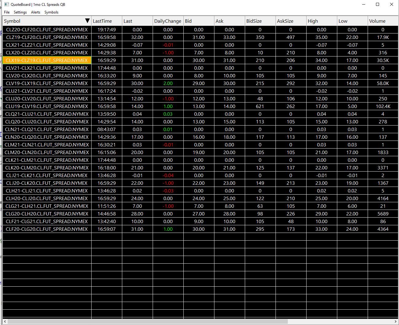

1. When creating charts using exchange-traded spread symbols as their primary symbol, SC 1971 intermittently displays the price in x100 scale. I have been extra diligent to navigate the GET SPREADS tree in File>>Find Symbol rather than just typing the symbol free-hand to make absolutely sure the symbol is correct. Sometimes is displays correctly, sometimes not. So far I can find no pattern to predict when the error will occur. I can find nothing in F5 chart settings equivalent to the 'multiplier' that solved the problem in the AddAdditionalSymbol study. Once this happens, the only solution I can find is to delete the chart and try again until it displays correctly. Once it does, it doesn't seem to change back after that.
2. In the attached screen grab of a quoteboard full of 1-month CL spreads, some symbols display correctly but seemingly randomly, others are x100. I can find no setting on quoteboard to change the multiplier to make them correct. Also, this quoteboard was loaded from a .SymbolList (also attached) which contained more symbols than the Quoteboard displayed. I can't tell if the problems are related but apparently it stopped short of loading all the symbols in the symbol list file.
3. When using exchange traded spread symbols with AddAdditionalSymbol, it works fine (without the need to manually set the multiplier) on historical charts, but not on intraday charts, where the problem can be remedied by setting the multiplier to .01. Seems weird that one would work but not the other.

imageSpread QB.JPG / V - Attached On 2019-08-10 23:29:21 UTC - Size: 352.04 KB - 583 views

We just want to make a quick comment, the spread values, are sent in an unadjusted format as they come from the exchange and then there is a multiplier applied which comes from the security definition data. But if the instrument data from the CME does not contain the right values to set that multiplier, then the spread prices will be in an unadjusted format and will be larger.
This will momentarily be the case for any existing data until the security definition data is received. This will be the case when you open existing chart data and before the security definition data is received.
Anyway, we will get to this thread as soon as we can but allow a few days. And please do not post anything further.
[2019-08-14 07:32:43]
What we have done is we have preset the CL spread symbol settings with a real-time multiplier of .01 so there is always consistency with the price formatting under all conditions.
Also the SymbolList file you attached has 27 symbols in it. It looks like it matches up with the number of symbols in the quote board you attached as well.

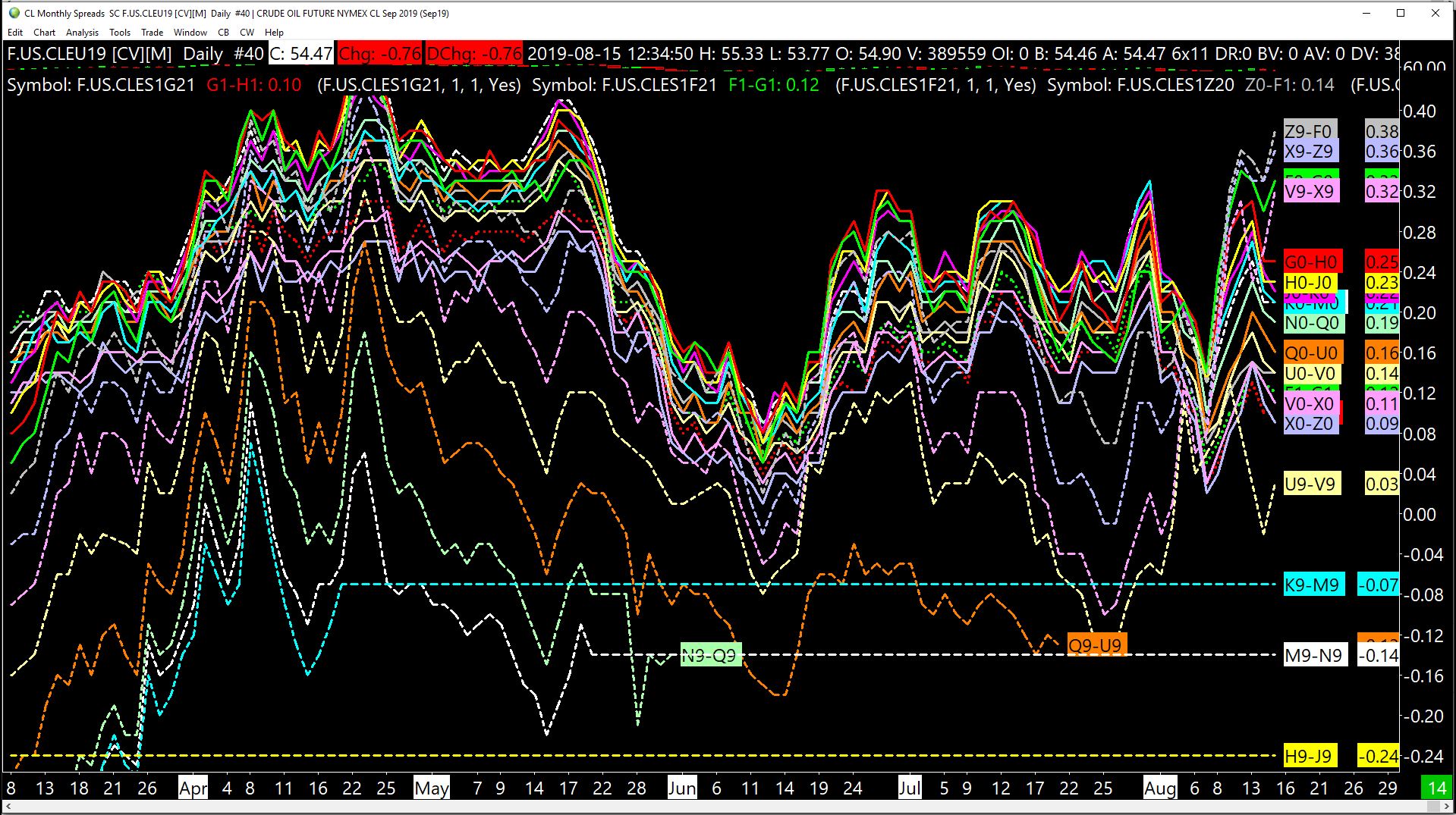

My charting problems using SC1971 with the Denali/TT FIX ORS feed are only getting worse, not better, after following the instructions given here.
Attached file "CL Spreads CQG Feed.jpg" contrasted with "CL Spreads Denali Feed.jpg" shows an example of just one of the charts showing identical symptoms. The big price dislocations in the Denali version which go off-screen are all excursions to x100 prices that never happened. In other words, in the period Aug. 12-Aug. 15, there were actual prices like $0.32 that got processed (and are still charting) as $32.00. Probably important: During loading of the .CHT, I noticed the price scale jump from x100 to correct at one point. Makes me think that during initialization some values are being marked at the x100 prices before SC resets to the correct scale for the data feed.
The history of this is as follows:
* When the chart was originally converted to SC symbol format, it worked in daily view but not intraday.
* On your direction, I changed multiplier of all AddAdditionalSymbol studies to 0.01. That temporarily allowed both historical and intraday to function as desired. But I did not have occasion to shut down and restart SC until last night, and that seems to have been the catalyst to expose new issues (see below).
* On your direction, I refreshed global symbol settings and then used the button on F5 Chart Settings to apply them to this chart.
* It seemed to work on this chart (but not newly created ones) until I shut down and reloaded SC. On the re-opening of the .CHT, this chart and most others came up with these new errors introduced. During the load of the .CHT file, it appeared to jump back and forth between price scales.
* Re-applied global chart settings to make absolutely sure they were applied to this chart, then Reload/Recalculate. No change in results.
Since the catalyst was shutting down and restarting SC, I cannot tell whether something we did per your direction in this thread contributed to breaking it, or if it was just going to break anyway on the next re-opening of Sierra Charts.
All things considered, I am very keen to find a way to use the non-TT-supplied Denali feed as my primary charting data feed. Seems the TT feed has serious problems. I still need a way to enter trades to Advantage from SC, but I could run a 2nd installation of SC on the other feed just for that purpose if necessary.

imageCL Spreads CQG Feed.JPG / V - Attached On 2019-08-15 16:56:42 UTC - Size: 498.69 KB - 565 views
imageCL Spreads Denali Feed.JPG / V - Attached On 2019-08-15 16:56:53 UTC - Size: 431.09 KB - 805 views
