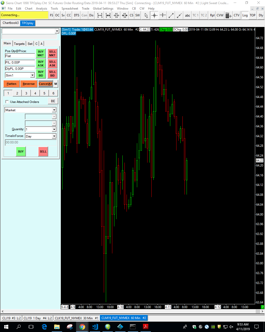

Hi SC,
I was recently in contact with you regarding setting up a UAT environment using the SC Futures Order Routing/Data feed and I can now see my account added under Account Control Panel. I am also able to get the Symbols and charts open, but there seems to be a lag between the system time and the chart time till where its loaded. I am attaching a screenshot of the same, and also the message log as you have given instructions on the documentation page. I only need to get the Real Time updating done and then i guess the UAT environment would function as expected.
MESSAGE LOG:
Software version: 1898 32-bit | 2019-04-11 09:52:19
Usage end date: 2019-06-20 | 2019-04-11 09:52:19
Enabled for: Advanced Features. | 2019-04-11 09:52:19
Enabled for: Advanced Features 2. | 2019-04-11 09:52:19
Enabled for: Sierra Chart Historical Data Service. | 2019-04-11 09:52:19
Allow Support for Sierra Chart Data Feeds is enabled. | 2019-04-11 09:52:19
Current selected Data/Trading service: SC Futures Order Routing/Data | 2019-04-11 09:52:19
Chart Update Interval: 500 | 2019-04-11 09:52:19
Intraday Data Storage Time Unit: 0 | 2019-04-11 09:52:19
Time Zone: +01:00:00 (GMT+00BST+01,M3.5.0/01:00,M10.5.0/02:00) | 2019-04-11 09:52:19
2019-04-11 09:52:19 Local computer time | 2019-04-11 09:52:19
2019-04-11 08:52:19 Local computer time in UTC | 2019-04-11 09:52:19
2019-04-11 09:52:19 Local computer time in SC Time Zone | 2019-04-11 09:52:19
2019-04-11 06:54:23 Server time in UTC | 2019-04-11 09:52:19
Local computer UTC time and Server UTC time difference: 0 seconds. | 2019-04-11 09:52:19
Program path: C:\SierraChart\ | 2019-04-11 09:52:19
Data Files path: C:\SierraChart\Data\ | 2019-04-11 09:52:19
OS Version Number: 10.0 | 2019-04-11 09:52:19
Locale Setting: C | 2019-04-11 09:52:19
DLLs: base.dll, daily-mod.dll, daily.dll, daily2.dll, ExampleCustomStudies.dll, pi.dll, redef.dll, rough.dll, UserContributedStudies.dll, UserContributedStudies_64.dll | 2019-04-11 09:52:19
File >> Disconnect selected. | 2019-04-11 09:52:52
DTC Client socket (1) | Shutdown started. Waiting for graceful close. | 2019-04-11 09:52:52
SC Futures Order Routing/Data | Disconnected. | 2019-04-11 09:52:52
DTC Client socket (1) | Socket gracefully closed by remote side. | 2019-04-11 09:52:52
DTC Client socket (1) | Closed. | 2019-04-11 09:52:52
SC Futures Order Routing/Data | Connecting to the server futurestrading1.sierracharts.com. Port 11097 | 2019-04-11 09:52:56
DTC Client socket (1) | Creating socket. Using TLS 1.2. | 2019-04-11 09:52:56
DTC Client socket (1) | Connecting to IP: 65.182.172.42. | 2019-04-11 09:52:56
DTC Client socket (1) | Connect event error. Windows error code 10060: A connection attempt failed because the connected party did not properly respond after a period of time, or established connection failed because connected host has failed to respond. | 2019-04-11 09:53:17 *
Error connecting to Data or Trading service. For help with this issue, press the 'Send For Analysis' button on this window. | 2019-04-11 09:53:17
Select 'File >> Disconnect' to prevent further connection attempts. | 2019-04-11 09:53:17
DTC Client socket (1) | Closed. | 2019-04-11 09:53:17
SC Futures Order Routing/Data | Disconnected. | 2019-04-11 09:53:17
Will reconnect to the server in 3.0 seconds. Select 'File >> Disconnect' to prevent further connection attempts. | 2019-04-11 09:53:17
SC Futures Order Routing/Data | Connecting to the server futurestrading4.sierracharts.com. Port 11097 | 2019-04-11 09:53:20
DTC Client socket (1) | Creating socket. Using TLS 1.2. | 2019-04-11 09:53:20
DTC Client socket (1) | Connecting to IP: 65.182.172.42. | 2019-04-11 09:53:20
DTC Client socket (1) | Connect event error. Windows error code 10060: A connection attempt failed because the connected party did not properly respond after a period of time, or established connection failed because connected host has failed to respond. | 2019-04-11 09:53:41 *
Error connecting to Data or Trading service. For help with this issue, press the 'Send For Analysis' button on this window. | 2019-04-11 09:53:41
Select 'File >> Disconnect' to prevent further connection attempts. | 2019-04-11 09:53:41
DTC Client socket (1) | Closed. | 2019-04-11 09:53:41
SC Futures Order Routing/Data | Disconnected. | 2019-04-11 09:53:41
Will reconnect to the server in 3.0 seconds. Select 'File >> Disconnect' to prevent further connection attempts. | 2019-04-11 09:53:41
SC Futures Order Routing/Data | Connecting to the server futurestrading1.sierracharts.com. Port 11097 | 2019-04-11 09:53:44
DTC Client socket (1) | Creating socket. Using TLS 1.2. | 2019-04-11 09:53:44
DTC Client socket (1) | Connecting to IP: 65.182.172.42. | 2019-04-11 09:53:44
DTC Client socket (1) | Connect event error. Windows error code 10060: A connection attempt failed because the connected party did not properly respond after a period of time, or established connection failed because connected host has failed to respond. | 2019-04-11 09:54:05 *
Error connecting to Data or Trading service. For help with this issue, press the 'Send For Analysis' button on this window. | 2019-04-11 09:54:05
Select 'File >> Disconnect' to prevent further connection attempts. | 2019-04-11 09:54:05
DTC Client socket (1) | Closed. | 2019-04-11 09:54:05
SC Futures Order Routing/Data | Disconnected. | 2019-04-11 09:54:05
Will reconnect to the server in 3.0 seconds. Select 'File >> Disconnect' to prevent further connection attempts. | 2019-04-11 09:54:05
SC Futures Order Routing/Data | Connecting to the server futurestrading4.sierracharts.com. Port 11097 | 2019-04-11 09:54:08
DTC Client socket (1) | Creating socket. Using TLS 1.2. | 2019-04-11 09:54:08
DTC Client socket (1) | Connecting to IP: 65.182.172.42. | 2019-04-11 09:54:08
DTC Client socket (1) | Connect event error. Windows error code 10060: A connection attempt failed because the connected party did not properly respond after a period of time, or established connection failed because connected host has failed to respond. | 2019-04-11 09:54:29 *
Error connecting to Data or Trading service. For help with this issue, press the 'Send For Analysis' button on this window. | 2019-04-11 09:54:29
Select 'File >> Disconnect' to prevent further connection attempts. | 2019-04-11 09:54:29
DTC Client socket (1) | Closed. | 2019-04-11 09:54:29
SC Futures Order Routing/Data | Disconnected. | 2019-04-11 09:54:30
Will reconnect to the server in 3.0 seconds. Select 'File >> Disconnect' to prevent further connection attempts. | 2019-04-11 09:54:30
SC Futures Order Routing/Data | Connecting to the server futurestrading1.sierracharts.com. Port 11097 | 2019-04-11 09:54:32
DTC Client socket (1) | Creating socket. Using TLS 1.2. | 2019-04-11 09:54:33
DTC Client socket (1) | Connecting to IP: 65.182.172.42. | 2019-04-11 09:54:33
DTC Client socket (1) | Connect event error. Windows error code 10060: A connection attempt failed because the connected party did not properly respond after a period of time, or established connection failed because connected host has failed to respond. | 2019-04-11 09:54:54 *
Error connecting to Data or Trading service. For help with this issue, press the 'Send For Analysis' button on this window. | 2019-04-11 09:54:54
Select 'File >> Disconnect' to prevent further connection attempts. | 2019-04-11 09:54:54
DTC Client socket (1) | Closed. | 2019-04-11 09:54:54
SC Futures Order Routing/Data | Disconnected. | 2019-04-11 09:54:54
Will reconnect to the server in 3.0 seconds. Select 'File >> Disconnect' to prevent further connection attempts. | 2019-04-11 09:54:54
SC Futures Order Routing/Data | Connecting to the server futurestrading4.sierracharts.com. Port 11097 | 2019-04-11 09:54:57
DTC Client socket (1) | Creating socket. Using TLS 1.2. | 2019-04-11 09:54:57
DTC Client socket (1) | Connecting to IP: 65.182.172.42. | 2019-04-11 09:54:57
imageerror.PNG / V - Attached On 2019-04-11 09:00:38 UTC - Size: 108.52 KB - 463 views

We apologize for the delay. We have done yesterday a reconfiguration of the servers used by this order routing service. This is why you cannot connect to the UAT system. This issue does not affect live trading. We will have this resolved for UAT after the close today.
This service also requires the use of the Sierra Chart Exchange Data Feed to receive the real-time data. We see your account does not currently have that active. So you would have to activate that. Here is the relevant documentation and instructions:
Let us know if you need help with the data feed.
Additionally please take note of the following:
Understand, that there is a difference between the actual exchange real-time data and the pricing in the UAT environment. So you are going to see that orders fill at different prices and orders do not fill when expected. But it is a good test to check the transmission of orders.

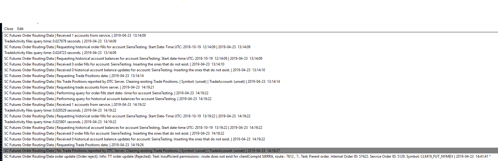

THis is in regards to the UAT environment you have helped me set up last week. My System generated an order today and this is the error message im getting. Please check attached snips of Trade Service Log and Trade Orders Positions tab.
showing error
TradeAccount (Unset)
Symbol (unset)
Also let me know if there is any different procedure to implement this so that it actually takes positions in the UAT envionment.
imageError UAT SC.PNG / V - Attached On 2019-04-23 14:15:53 UTC - Size: 61.96 KB - 360 views
imageUAT OrderPosition.PNG / V - Attached On 2019-04-23 14:19:24 UTC - Size: 41.51 KB - 624 views

We need a little time to look into this. This is a rejection on the TT side. The relevant error is where it says "Insufficient Permissions". We will have to ask TT about this.
Date Time Of Last Edit: 2019-04-23 17:31:49
[2019-04-23 17:34:54]
Can you tell us what the Primary Server is set to in Global Settings >> Data/Trade Service Settings.
Date Time Of Last Edit: 2019-04-23 17:35:00

User255315 - Posts: 133
set to 'server1'
[2019-04-24 05:02:15]
We are following up with TT about this to see what needs to be changed to get the order two go through.
[2019-04-24 05:04:14]
I have set the primary server and Data/trade settings to Server1 as primary and server2 as secondary with UAT enabled. Waiting for further instructions regarding this from you.

[2019-04-25 05:27:05]
Hi SC
I changed the servers to 2 and 4 respectively and these are the trade service log messages:
TradeActivity files query time: 0.032856 seconds. | 2019-04-25 06:24:26
TradeActivity files query time: 0.017873 seconds. | 2019-04-25 06:24:26
SC Futures Order Routing/Data | Requesting trade accounts from server. | 2019-04-25 06:24:33
SC Futures Order Routing/Data | Performing query for order fills start date- time for account SierraTesting. | 2019-04-25 06:24:33
SC Futures Order Routing/Data | Performing query for historical account balances for account SierraTesting. | 2019-04-25 06:24:33
SC Futures Order Routing/Data | Received 1 accounts from service. | 2019-04-25 06:24:33
TradeActivity files query time: 0.036914 seconds. | 2019-04-25 06:24:33
TradeActivity files query time: 0.029079 seconds. | 2019-04-25 06:24:33
SC Futures Order Routing/Data | Requesting historical order fills for account SierraTesting. Start Date-Time UTC: 2018-10-21 05:24:33 | 2019-04-25 06:24:33
TradeActivity files query time: 0.027663 seconds. | 2019-04-25 06:24:33
SC Futures Order Routing/Data | Requesting historical account balances for account SierraTesting. Start date-time UTC: 2018-10-21 05:24:33 | 2019-04-25 06:24:33
SC Futures Order Routing/Data | Received 0 order fills for account: SierraTesting. Inserting the ones that do not exist. | 2019-04-25 06:24:33
SC Futures Order Routing/Data | Received 0 historical account balance updates for account: SierraTesting. Inserting the ones that do not exist. | 2019-04-25 06:24:33
TradeActivity files query time: 0.022739 seconds. | 2019-04-25 06:24:34
SC Futures Order Routing/Data | Requesting Trade Positions data. | 2019-04-25 06:24:38
SC Futures Order Routing/Data | No Trade Positions reported by DTC Server. Clearing existing Trade Positions. | Symbol: (unset) | TradeAccount: (unset) | 2019-04-25 06:24:38
SC Futures Order Routing/Data order update (Order reject). Info: TT order update (Rejected). Text: Insufficient permissions : route does not exist for clientCompId SIERRA, route : 7612 , 7. Internal Order ID: 57453. Service Order ID: 5151. Symbol: CLM19_FUT_NYMEX | 2019-04-25 06:24:44 *
SC Futures Order Routing/Data order update (Order reject). Info: TT order update (Rejected). Text: Insufficient permissions : route does not exist for clientCompId SIERRA, route : 7612 , 7. Internal Order ID: 57454. Service Order ID: 5152. Symbol: CLM19_FUT_NYMEX | 2019-04-25 06:25:06 *
SC Futures Order Routing/Data order update (Order reject). Info: TT order update (Rejected). Text: Insufficient permissions : route does not exist for clientCompId SIERRA, route : 7612 , 7. Internal Order ID: 57455. Service Order ID: 5153. Symbol: CLM19_FUT_NYMEX | 2019-04-25 06:25:11 *
SC Futures Order Routing/Data order update (Order reject). Info: TT order update (Rejected). Text: Insufficient permissions : route does not exist for clientCompId SIERRA, route : 7612 , 7. Internal Order ID: 57456. Service Order ID: 5154. Symbol: CLM19_FUT_NYMEX | 2019-04-25 06:25:30 *
SC Futures Order Routing/Data order update (Order reject). Info: TT order update (Rejected). Text: Insufficient permissions : route does not exist for clientCompId SIERRA, route : 7612 , 7. Internal Order ID: 57457. Service Order ID: 5155. Symbol: CLM19_FUT_NYMEX | 2019-04-25 06:25:34 *
SC Futures Order Routing/Data order update (Order reject). Info: TT order update (Rejected). Text: Insufficient permissions : route does not exist for clientCompId SIERRA, route : 7612 , 7. Internal Order ID: 57458. Service Order ID: 5156. Symbol: CLM19_FUT_NYMEX | 2019-04-25 06:25:41 *
Waiting for you to resolve this.
[2019-04-25 07:05:43]
This is the same error message that we gave TT. Either you or your broker needs to contact TT and give them the account identifier and have them resolve this.
This is a TT error:
