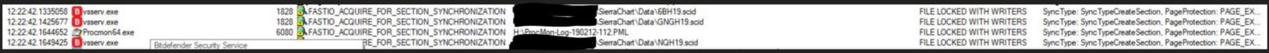

[2019-02-13 17:28:42]
NRGTrader - Posts: 351
I don't know if FASTIO is the same process as the FAST you've referenced, but I happened to notice this today ...
imageCapture.JPG / V - Attached On 2019-02-13 17:28:13 UTC - Size: 38.57 KB - 481 views

Regarding post #71, that is not related. That looks like something specific to your system.
