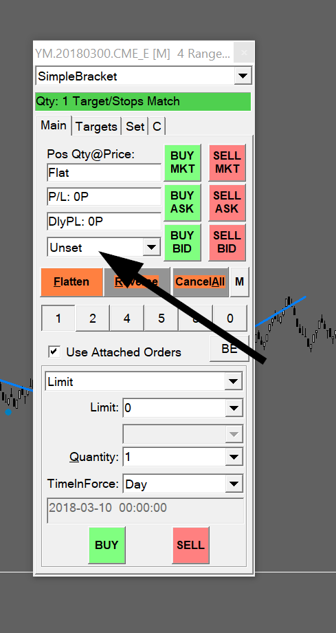

[2018-03-09 23:27:48]
User809700 - Posts: 14
I am setup with a live account with AMP for clearing and CTS T4 DTC data connection.
When i open the Trade Window to begin trading i see that the section for Trade Account is showing "unset". I followed the sierra instructions (link below) regarding this issue and thus contacted AMP, however, they claim that everything is correctly inputted on their end and they referred me to you guys. ( Basic Trading and the Trade Window: Main/C >> Trade Account (Selecting Trade Account for Chart / Trade DOM) )
I would appreciate any insight into how to fix this issue.
Thanks in advance,
N
imagetrade window.png / V - Attached On 2018-03-09 23:26:31 UTC - Size: 28.05 KB - 587 views
[2018-03-10 05:39:03]
Either the username or password you have entered here is incorrect:
https://www.sierrachart.com/UserControlPanel.php?page=TradingServiceLoginDetails
This is what we see on the server:
CTS T4 FIX | Received trader logon response with CTS username 'CT112***'. Text: Login failed: Too many failed login attempts: Your tradername has been locked out. Please contact your firm administrator to reset the tradername | 2018-03-09 18:03:34
You should see this very same message in Trade >> Trade Service Log every 10 minutes when connected. Can you confirm that. That is important that is working properly. That should give you a very good indication what the problem is. That is the whole reason why this data is passed through to the user. It surprises us why these questions come up and users are just not recognizing that unless it is just not working right. So let us know. Just connect now and stay connected for 10 minutes and tell us if you see the message.
Date Time Of Last Edit: 2018-03-10 05:39:39
[2018-03-12 13:22:30]
I have re-inputted my credentials in the "trading service login details" as directed. It made no difference.
My hunch is that my account is not set to the DTC connection type, but rather the FIX connection. This might also explain why sierra automatically tries to login with the FIX connection. When i manually switch this connection to DTC the data begins streaming and i can do everything but send orders. Please find attached my Message Log & Trade Service Log:

Trade Service Log:
Trade Activity Log: File read result: 257 records inserted. 0 fill records inserted. 0 records filtered. | 2018-03-12 09:01:56
Trade Activity Log: File date-time limits: Sim records date-time limit is 2018-02-25 00:00:00. Non-sim records date-time limit is 2017-12-09 00:00:00. Non-sim fill record date-time limit is 2017-03-12 00:00:00. | 2018-03-12 09:01:56
CTS Trading AMP - DTC | Requesting trade accounts from server. | 2018-03-12 09:03:01
CTS Trading AMP - DTC | Received no accounts from service. | 2018-03-12 09:03:01
CTS Trading AMP - DTC | Requesting historical order fills for all trade accounts. Number of days: 90 | 2018-03-12 09:03:01
CTS Trading AMP - DTC | Received 0 order fills. Inserting the ones that do not exist. | 2018-03-12 09:03:01
CTS Trading AMP - DTC | Requesting Trade Positions data. | 2018-03-12 09:03:06
CTS Trading AMP - DTC | No Trade Positions reported by DTC Server. Clearing existing Trade Positions. | 2018-03-12 09:03:06
CTS Trading AMP - DTC order update (Order reject). Info: Specified account is not authorized. Internal Order ID: 939703. Service Order ID: (none). Symbol: YM.20180600.CME_E | 2018-03-12 09:03:47 *
CTS Trading AMP - DTC | CTS server logon result: Login failed: Too many failed login attempts: Your tradername has been locked out. Please contact your firm administrator to reset the tradername | 2018-03-12 09:09:08
CTS Trading AMP - DTC order update (Order reject). Info: Specified account is not authorized. Internal Order ID: 939706. Service Order ID: (none). Symbol: YM.20180600.CME_E | 2018-03-12 09:14:28 *
CTS Trading AMP - DTC | CTS server logon result: Login failed: Too many failed login attempts: Your tradername has been locked out. Please contact your firm administrator to reset the tradername | 2018-03-12 09:19:08

I spoke with CTS and they double checked my setting on their server. From what they can see i have all the correct permissions setup. However, they do not see my login into the DTC server, so perhaps the issue is sierra is still trying to connext to the FIX server. I would appreciate if you guys could double check this, also, this is the error i get when placing a limit order:
CTS Trading AMP - DTC | No Trade Positions reported by DTC Server. Clearing existing Trade Positions. | 2018-03-12 11:22:53
CTS Trading AMP - DTC | CTS server logon result: Login failed: Authentication failure for Trader CT112806 | 2018-03-12 11:23:08
CTS Trading AMP - DTC order update (Order reject). Info: Specified account is not authorized. Internal Order ID: 939727. Service Order ID: (none). Symbol: YM.20180600.CME_E | 2018-03-12 11:29:11 *

Could you contact your broker and have them contact CTS and help them with this problem:
The message in bold is from the CTS system. Your broker and CTS need to work this out assuming you have entered the username and password correctly.
In particular have them follow step 10 here:
https://www.sierrachart.com/index.php?page=doc/CTS_T4.php#LowCostConnectionModel_Instructions
Date Time Of Last Edit: 2018-03-12 19:33:13

I spoke with CTS and their Tech support did see an issue relating to my account. They claimed the copy of Sierra i was using was "retail" and therefore they had to change the "permission". Not totally sure what they meant as i had athorized Sierra as a 3rd party app, however, sierra does now open and connect to CTS directly. Progress.
That said, i waited for the market to reopen and tried placing a limit order as a test and i have the following errors in the log:

It does not seem as though what CTS did is helping because the last message is this:
CTS Trading AMP - DTC | CTS server logon result: Login failed: Authentication failure for Trader CT112806 | 2018-03-12 18:37:11
It does not indicate the account is locked either so there still is something going wrong. It looks like that lock condition automatically clears.
CT112806 needs to be under the "AMP" firm.
The CTS username and password need to be correct.
And step 10 needs to be followed:
Those are the only items which can lead to the authentication failure condition to our knowledge.
Date Time Of Last Edit: 2018-03-13 00:17:05

I contacted CTS and AMP and finally this issue was resolved. If i had insight into the fix i would share, but am not really sure.
Thanks for your assistance.
