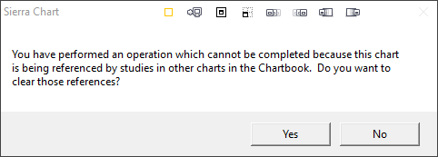

after updating to 1484 i got this msg while my charts were loading for the first time on this build. i have never seen this msg before.
Date Time Of Last Edit: 2016-11-11 17:55:17
imageSierraChart_2016-11-11_11-52-41.png / V - Attached On 2016-11-11 17:54:18 UTC - Size: 5.83 KB - 398 views
[2016-11-11 18:03:41]
Refer to:
Unable to Change the Bar Time Period for Charts
That message should not show on its own. It only should be shown if you try to change the time period of the chart bars and there is a synchronized reference to the chart. We will look into that.
