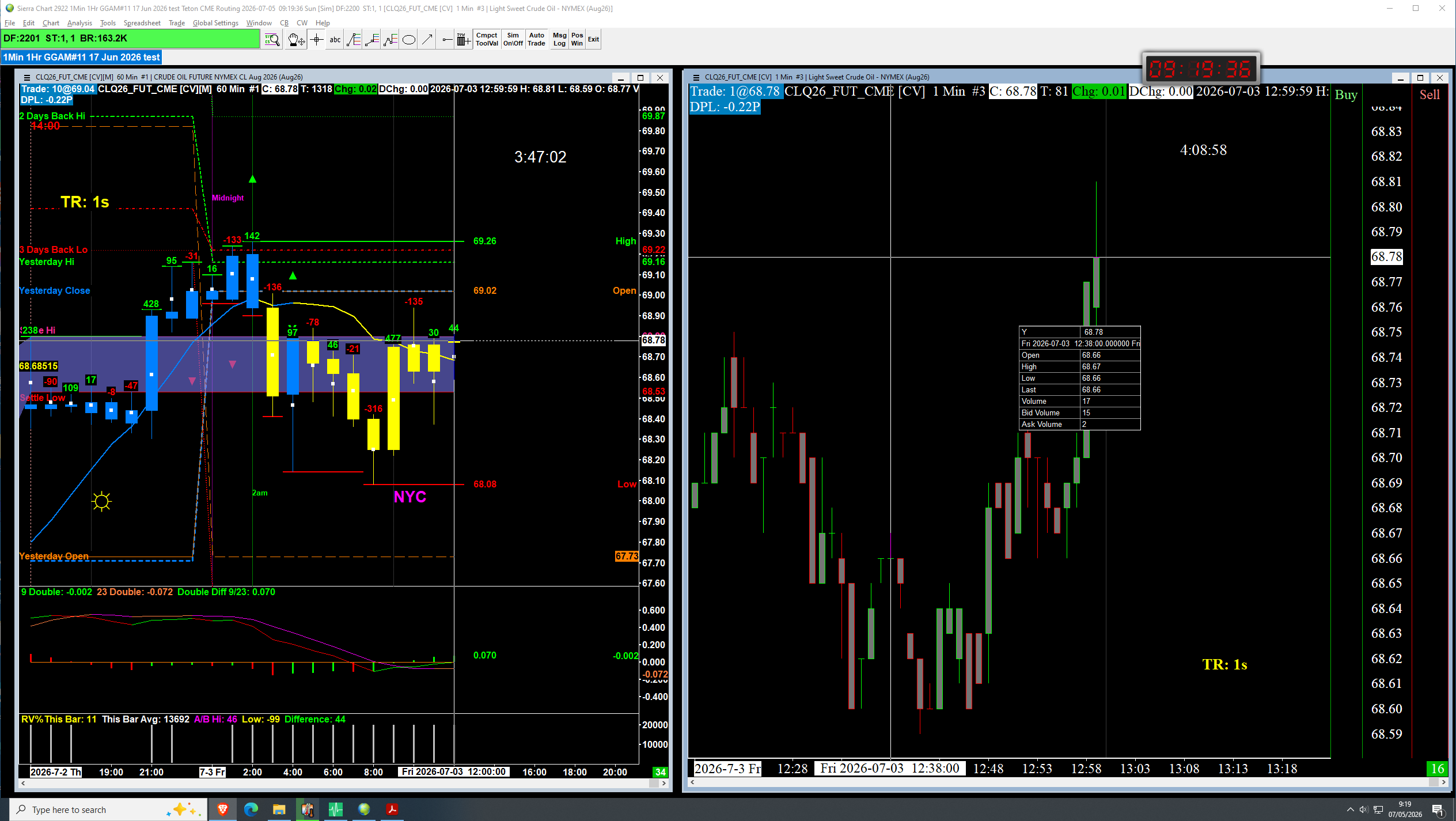

I only trade WTI crude oil using a 1Min, 60Min and Daily: so I have attached some charts although I know you don't like people sending you them without requesting them but perhaps they will help.

1. The Countdown timer still hangs up and I did go and review the settings to make sure I understood them but all times on this computer are EST although I live in Vietnam. From 18:00 at night till 17:00 the next day there are few quiet periods.
2. I went to Intraday Charts not updating and reviewed your suggestions but didn't find any solutions there. The chart stops updating and the crosshairs become frozen as well as the hand utility friezes up. I can only move the chart in
it's frozen state by using the slide bar at the bottom.

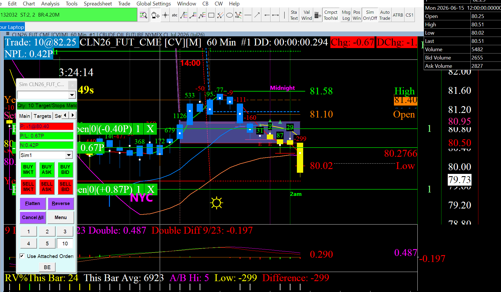

3. I am using the built in current price line study and have attached a snap of the difference between where the price line study is and the actual price as highlighted in the DOM. The DOM is showing in white that price is 79.73 while the price line is just north of $80.00. Attached screens shot 3 shows that pretty well.

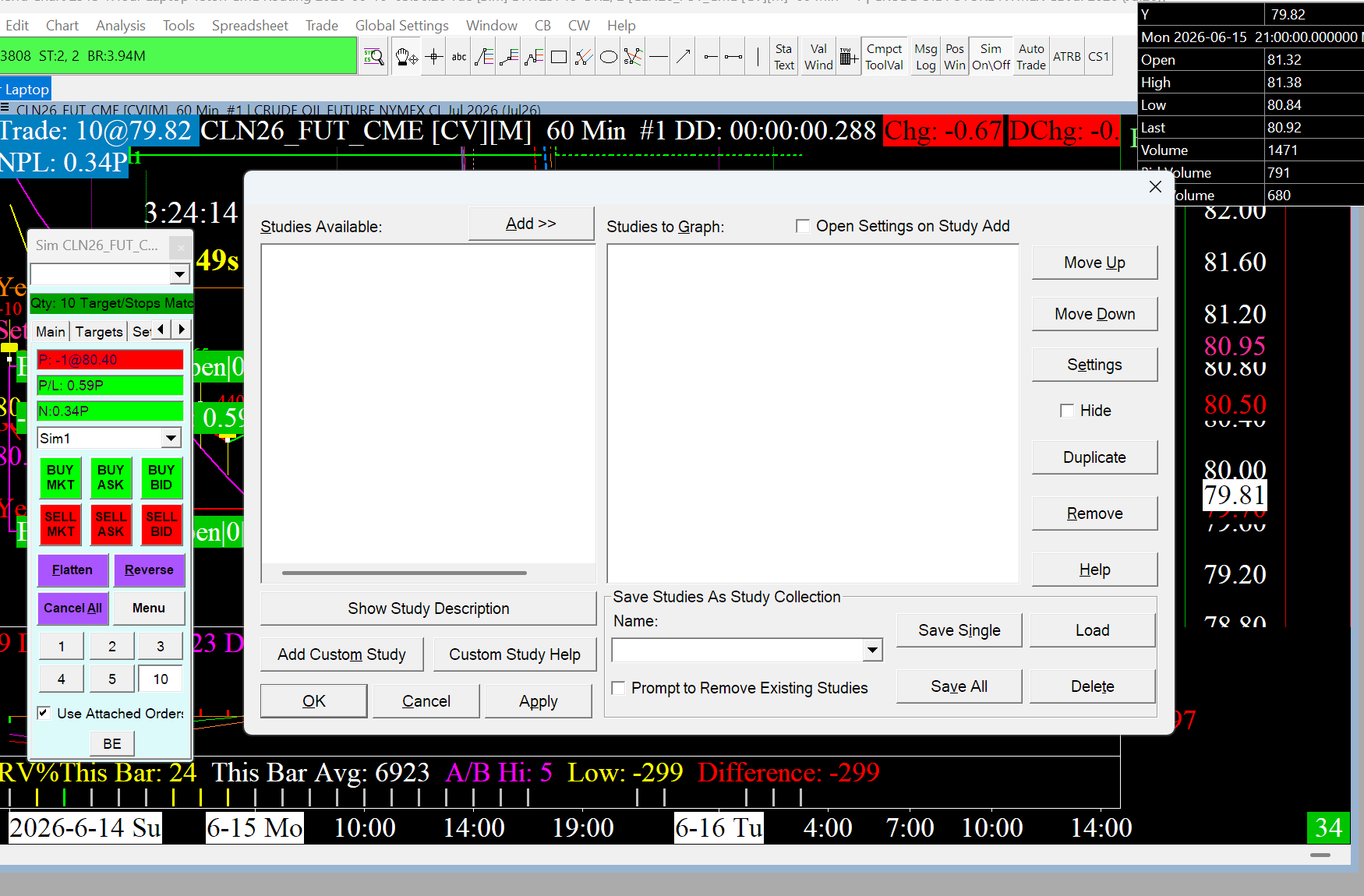

4.& 5. Attached screen shot #1 shows what happens when I open my study collection on the current 1Hr oil chart. It is empty.
The program froze up an hour or so ago and I have no idea as to why

3. In "Screenshot #3..." it shows the Tool Values window the information for the bar at 12:00:00. If that is the last bar showing in the chart, then what you are seeing with the Current Price Line study - as it is using the "Last" price of the most recent bar in the chart. In this case, it would be "80.51".
It looks like your Session Times are not setup properly to cover the full 24 hours of trading. If the chart session times are set in a way that the chart will not be updating, the price will continue to change in the DOM. This is normal. Make sure your Session Times are set to cover the full trading.
4. Is this only empty for a single chart? As we stated previously, if you are not getting anything displayed in those windows, then this points to an issue with Microsoft Windows resources on your computer. You would need to reboot to clear things up.
If you are having an issue with ALL charts not showing any studies, then the most likely reason is that the file that contains the Sierra Chart studies (SierraChartStudies_64.dll) is missing - most likely due to your virus scanning software removing it for some reason. If this is the case, then you would need to put in an exemption for the Sierra Chart folder to your virus scanner so it does not do this again. Then you can "update" to the same release to get the file back. Refer to the following for how to update to a specific release:

image5 July sunday 2026 Sierra Chart lock up.PNG / V - Attached On 2026-07-05 13:31:58 UTC - Size: 297.1 KB - 116 views
