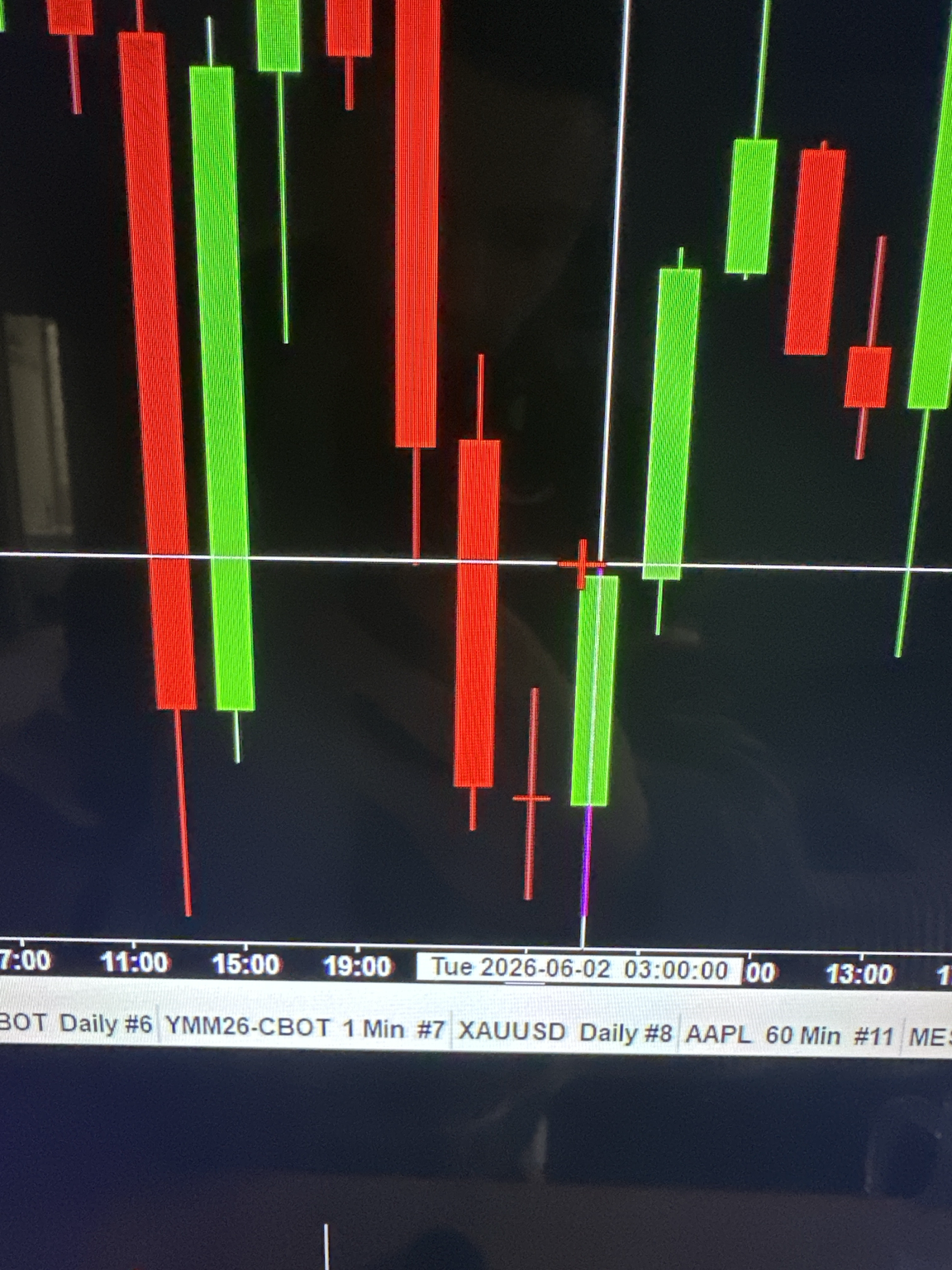

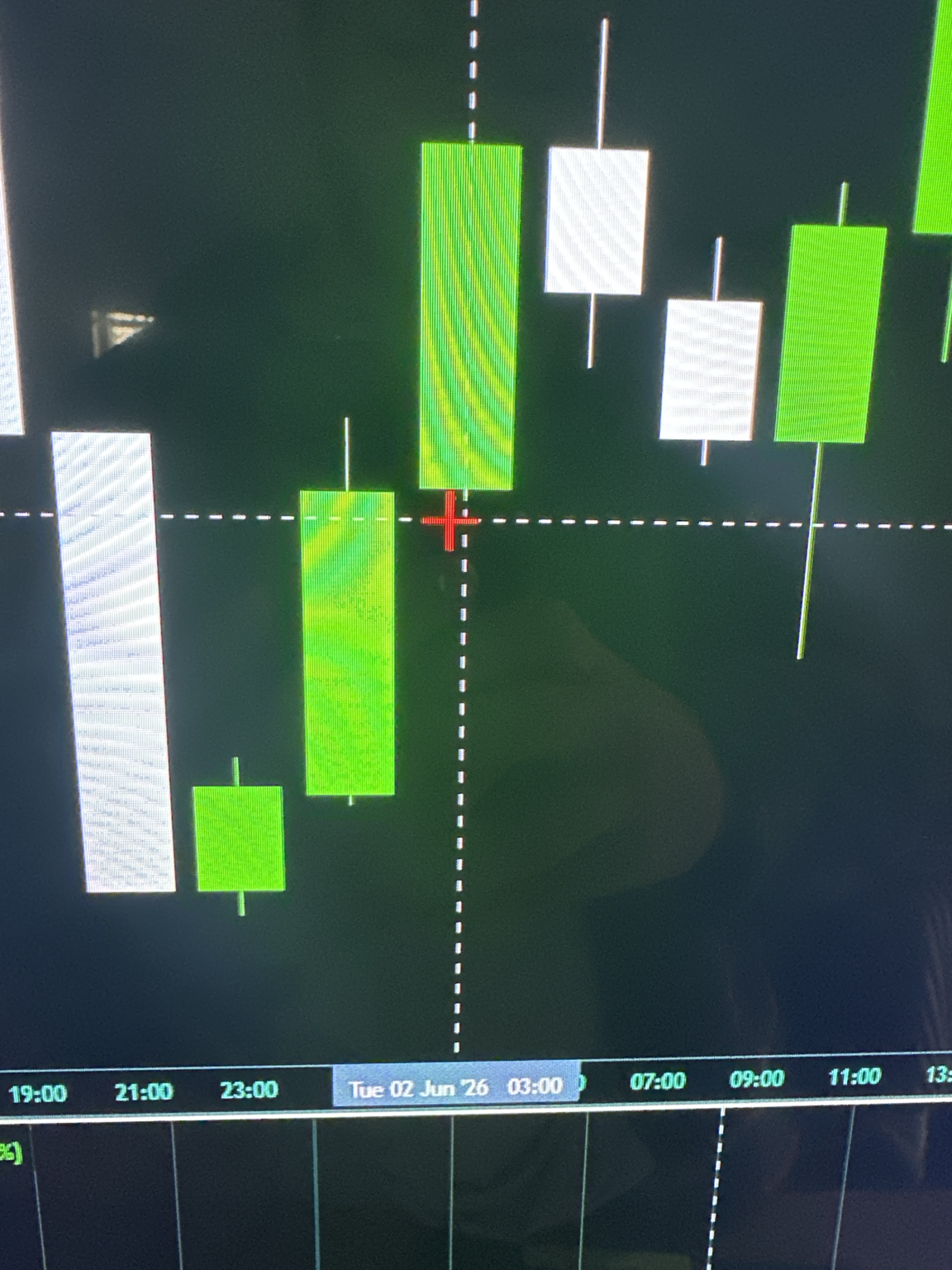

Hi, I am still trying to verify whether my 2-hour bars are aligned correctly after changing the time zone settings.
In TradingView, my 2-hour candles are aligned on odd hours (for example: 1:00, 3:00, 5:00, 7:00, 9:00, etc.).
When I use the Crosshair in Sierra Chart and click on a candle, it shows a time of 03:00. At first glance this seems correct, but I am not completely sure whether Sierra Chart is displaying the candle start time, end time, or if there is still a one-hour offset somewhere in my chart settings.
My goal is to have the Sierra Chart 2-hour bars aligned exactly the same way as TradingView.
Could you please confirm:
1. Does the time shown by the Crosshair represent the start time of the bar or the end time of the bar?
2. If a 2-hour candle shows 03:00, does that mean the bar covers 03:00–05:00?
3. Based on the screenshots I provided, does the chart appear to be correctly aligned on odd hours (1:00, 3:00, 5:00, 7:00, etc.), or is there still a one-hour offset?
I just want to be absolutely certain that my 2-hour candles are aligned correctly.

Differences With Data and Chart Bars Between Services / Connections / Chart Types: Chart Bar Time Stamping is Start of Bar
[2026-06-03 13:51:45]
1. The start time of the bar.
2. It covers the time from 03:00 to 04:59:59
3. No. You have a Session Start Time of 10:00. Therefore, you will have a new bar that starts at 10:00 and then 2 hour bars until the evening session start at 17:00. Then you will get 2 hour bars starting at 17:00 until the start of the next day session at 10:00 again. In other words, you should be seeing the following bar times:
10:00
12:00
14:00
16:00
17:00 (start of evening session)
19:00
21:00
23:00
01:00
03:00
05:00
07:00
09:00
10:00 (start of next session)
your actual bar times may vary depending on your time zone relative to the 1 hour break each day for the CME Group.
If you want your bars to be on odd times, then you need to have a Session Time start that is on an odd hour.
Also, your ending session times need to NOT include the following hour. For instance, if your day session ends at 17:00:00, then you need to enter an end time of 16:59:59.
