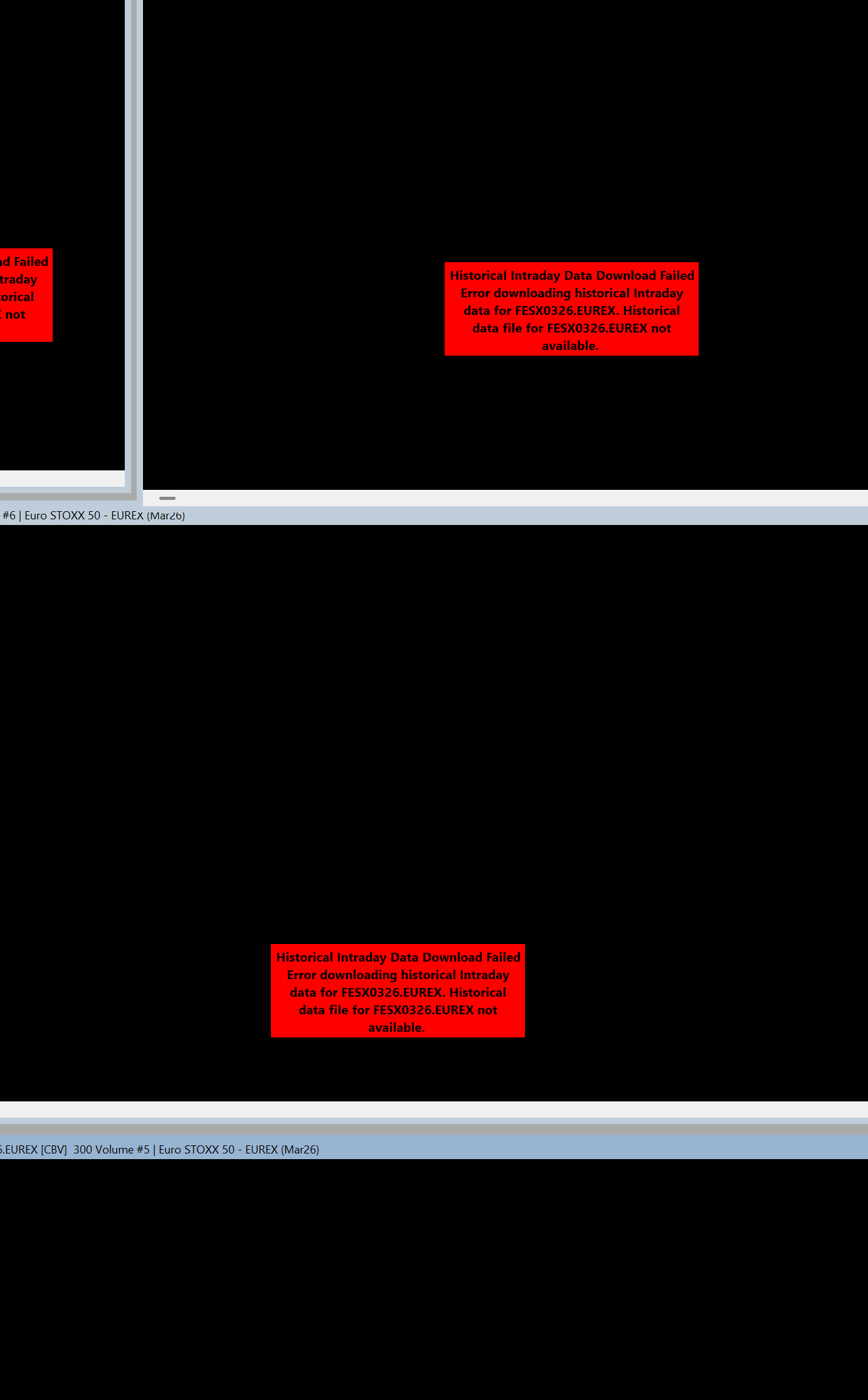

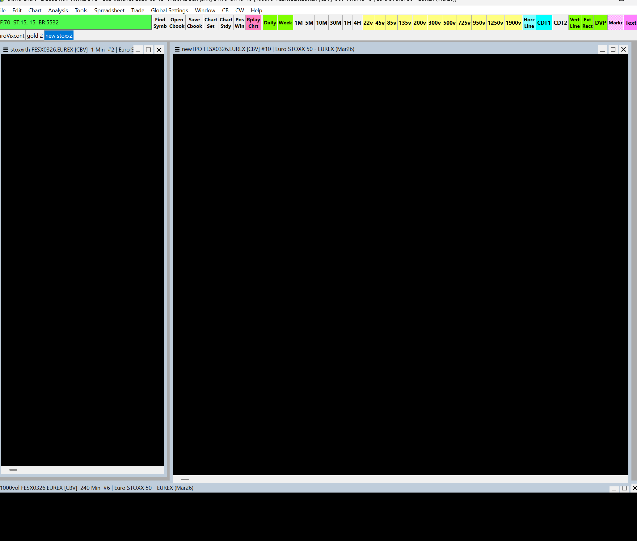

My eurostoxx won't load. I first get message in bright red, see screenshot. Then it just goes all blank. My euro vix from the same exchange is working fine. I have tried
1- deleting and reloading data
2- doing the old 'translate symbol...' trick
3- restarting instance (this instance also has the euro vix which is working perfectly)
Ideas???
Karen
imageredwarning.png / V - Attached On 2026-03-15 08:04:06 UTC - Size: 40.12 KB - 166 views
imageeurostoxx.png / V - Attached On 2026-03-15 08:04:13 UTC - Size: 53.52 KB - 177 views

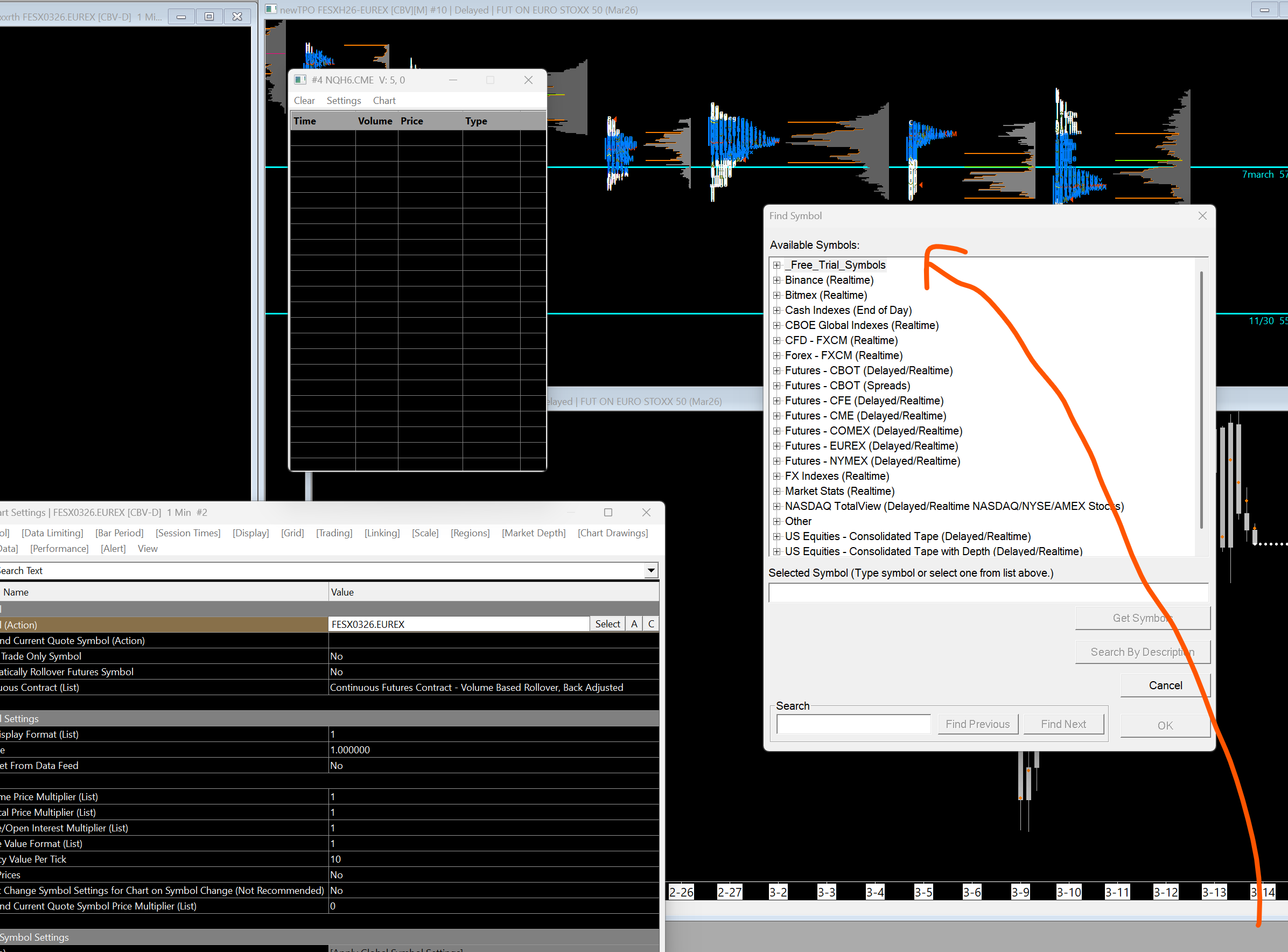

I have gotten it working, but fuck me, what a workaround. It absolutely would not load in All Service. So I copied chartbook, and put it in teton. I had to do 'translate symbol...'. Still wouldn't work. I then click into settings and go to change symbol. ( I thought I would try to reload it...) well it didn't default to Futures-EUREX like it should have, as you can see, it was coming from 'Free Trial Symbols' I thought, wtf is this? So I clicked on to Eurex and found Stoxx and boom the chart loaded.
Again, genius girl found a solution, but something ain't right with that product...
KK
imagefree trail....png / V - Attached On 2026-03-15 20:11:58 UTC - Size: 265.73 KB - 168 views

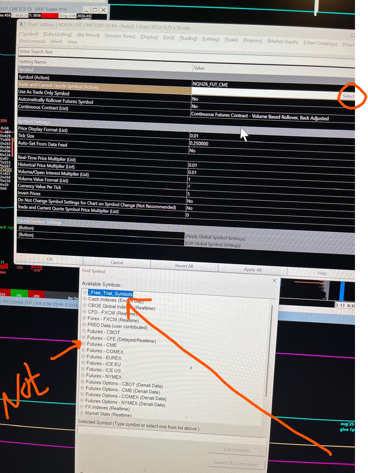

John, this 'free trial symbols' is now affecting other products. I went to add days to my nq and es charts, as the price has fallen so much, we are back at prices from last summer. It ignores my request for 300days, and will only go back as far as November. I thought wtf is going on now? Sure enough, I look at the chart settings, and you see clearly that the default after hitting select on the symbol goes to 'free trial' and not to Futures-CME as it should. What is going on??? Yes, I have Rythmic for execution, but I have All service for the feed, so it can't be Rythmic screwing it up. See screenshot. So now we have multiple products all doing something weird with 'free trial'
Thank you for your help
Karen
imageFREEtrialaffectingmore.jpg / V - Attached On 2026-03-15 22:37:12 UTC - Size: 388.28 KB - 118 views

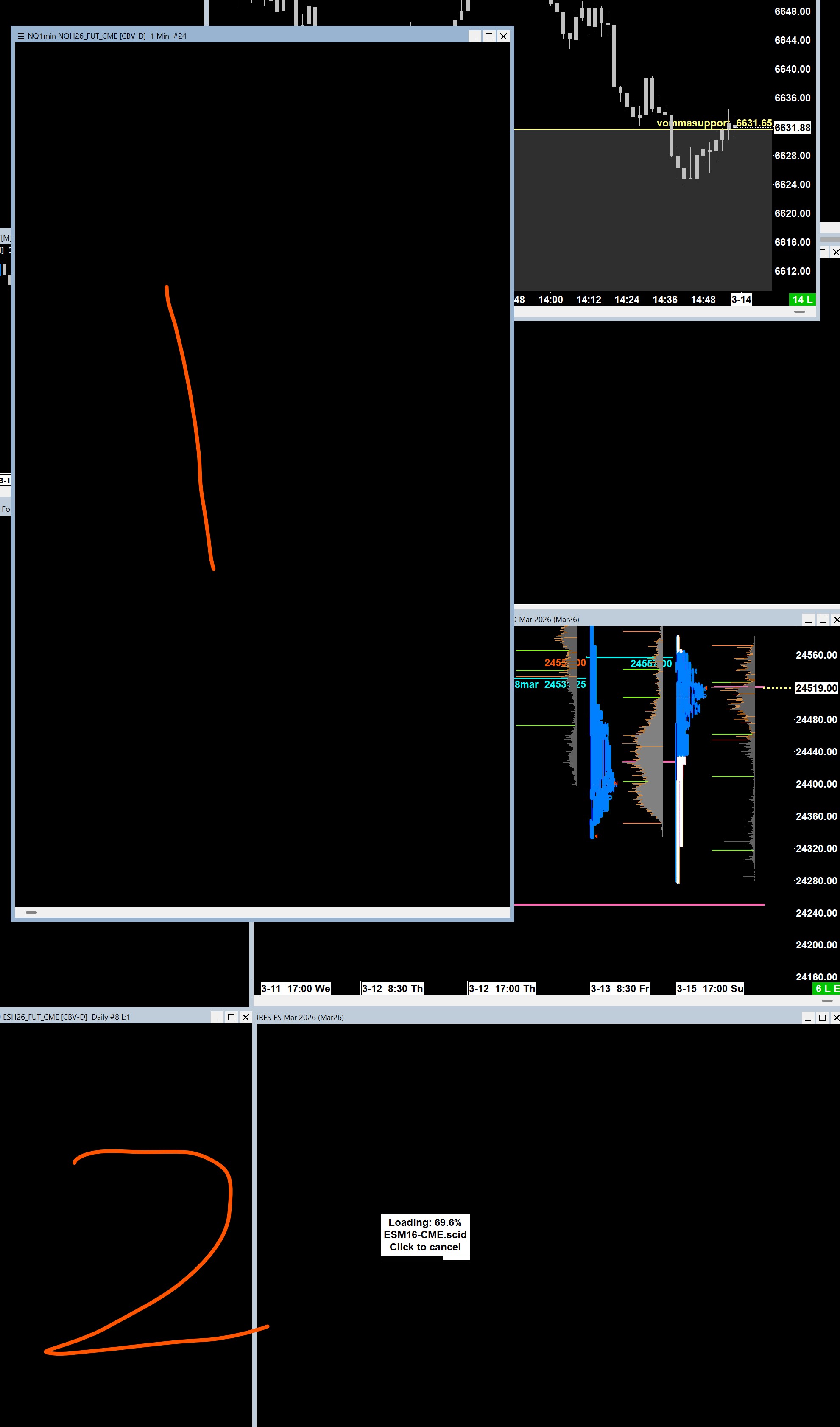

closed SC overnight and just opened up that chartbook. All the charts were black and dead. Can't even right click on them. So I go Chart settings, and to the symbol where yet again it's on the 'free trial' at the top. Then I go down to CME futures, re choose the symbol, and presto the charts reload... John something v v wrong here. Sure I can fix but what is going on? What is this 'free trial' and why has it taken over my symbols?
[2026-03-16 07:38:30]
User849502 - Posts: 485
sorry, just to make sure you see what is going on. 1- this what a chart looks like. Blank, black and dead. 2- is after I go to chart settings and reload the CME-Futures symbol the chart begins to reload.
Do you think this is somethng with Apex and Rythmic? BUT NOTE-THIS CHARTBOOK IS A SEPARATE SC LOG IN, AND NOTHING TO DO WITH APEX. So actually I think the answer is no, so what is causing this
imagewhatitlookslike.jpg / V - Attached On 2026-03-16 07:38:03 UTC - Size: 374.85 KB - 227 views

The "_Free_Trial_Symbols" that are listed are specifically the symbols that can only be used when on a Trial.
There is no reason for that to have anything to do with your charts. Although we do not know why it would be selected when you open the "Find Symbol" window.
In the end, the question is what is the symbol of the chart when you are having a problem and when you are not. From what we see in the image you provided, you have symbols set for "Teton" and for "SC Data". For instance, you have a chart for "NQH26_FUT_CME" - this is a symbol for Teton. But you also have a symbol for "ESM16-CME" which is a symbol for "SC Data".
To us, it appears you have some confusion on the symbols that are being used for the particular service. Make sure you have these correct.

aaaghhh John, I am getting a tiny bit frustrated because I showed you previously, but will again that YES IT DEFAULTS TO FREE TRIAL NOT FUTURES-EUREX. This morning, I went to roll the H euro vix to M. I clicked on 'perform rollover', it came up with a box that said no additional symbols found... I thought oh fuck, it's happening again. Sure enough, and please LOOK AT THE SCREENSHOTS, this is a mess. Something very bad is happening in 'all service'. Teton is working just fine
1- in first screenshot taken with my phone you see the blue highlighted 'free trial symbols' is highlighted when I follow chart-chart settings-symbol-select. DO YOU SEE???
2- next screenshot is when I click on Eurex and open to find the euro vix, what do you see??? The list of available products is reduced to about 10! no euro vix, along with a ton of missing other ones

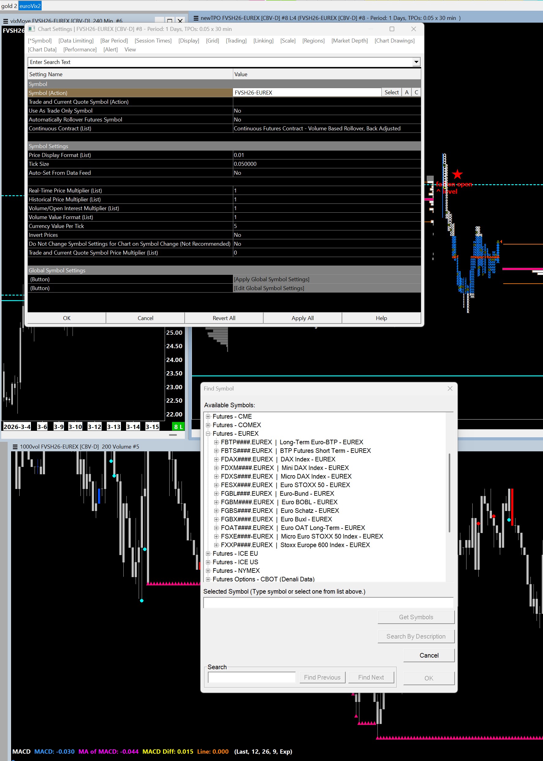

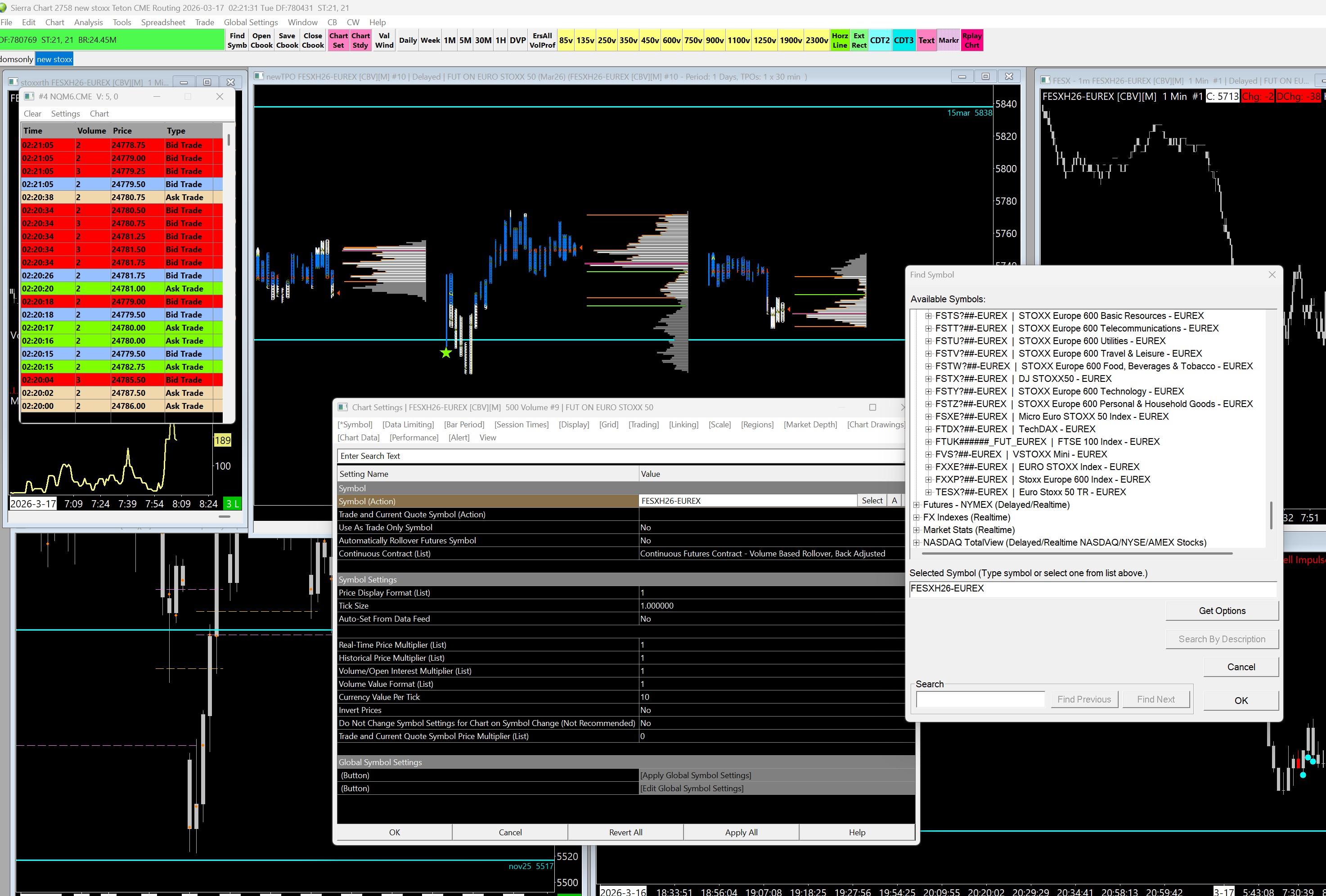

3- last shot, to solve my eurostoxx issue yesterday, I moved the Stoxx chartbook from 'all service' to Teton. Presto it worked... Now look at when I open(this is in Teton) chart settings-symbol-select... whaddya see? ALL OF the available eurex products including VStoxx...
Now do you see these issues? Mate, on my dog's life(and I would die for my dog), this is NOT an operator issue, there is something very wrong right now with my all service feed knocking my products out of the normal FUTURES-... to f'ing Free Trial. Do you want me to video, but you must see from these screen shots what I am telling you is fact, not me being an idiot.

well well, what happens when I took that eurto stoxx chartbook, and copied and moved it over to Teton. PRESTO! works perfectly and look at where it defaults to??? NOT to that fricking 'free trial' but where it belongs in in fully stocked Eurex drop down. NOW do you guys see what is happening?
THANK YOU. You have to be proud of me, that I get far enough to identify and 'temp fix' the issue, but Houston we a problem here...

The fact that the _Free_Trial_Symbols is getting highlighted when you go to select a symbol has nothing to do with what is occurring. That just happens to be what is showing up in that window due to the system not being able to find a matching symbol. That is completely unrelated to what is going on.
As to what is happening - we want to start off by saying that the symbols that you show in some of the early images were incorrect - they were Rithmic symbols and not the symbols for "SC Data" or for "Teton". For instance, from the first post you made, in the file named "redwarning.png", the symbol is showing as "FESX0326.EUREX". The FESX (Euro Stoxx 50) does not have the "0326" as part of the symbol for SC Data and the separator between the symbol and the exchange should be a dash (-) not a dot (.). The dot (.) is a Rithmic thing.
So the main issue was incorrect symbols for some reason.
As to the shortened list of EUREX symbols in the "Find Symbol" window, that is due to your "Current Selected Service" being set to "Rithmic". We can tell this by the symbols in the list having the dot (.) separator. And the specific list of symbols is what we display in that window when you are connected to Rithmic.
