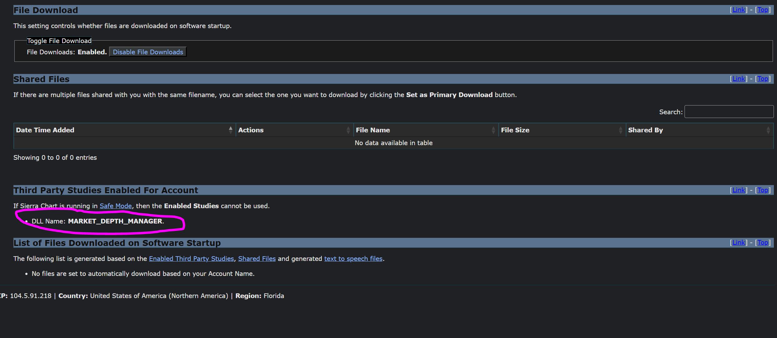

[2026-03-13 01:09:30]
super busy - Posts: 7
The study in question shows up under Allowed protected studies in the help tab (attached image) and on the sierra chart website. I have enabled downloads on startup.
I have checked the message log upon startup and it says no downloads in the queue.
I am not in safe mode.
I still can not get it to show up in the custom studies window.
Would appreciate any help, thank you.
Date Time Of Last Edit: 2026-03-13 01:24:41
image1.JPG / V - Attached On 2026-03-13 01:08:35 UTC - Size: 67.64 KB - 165 views

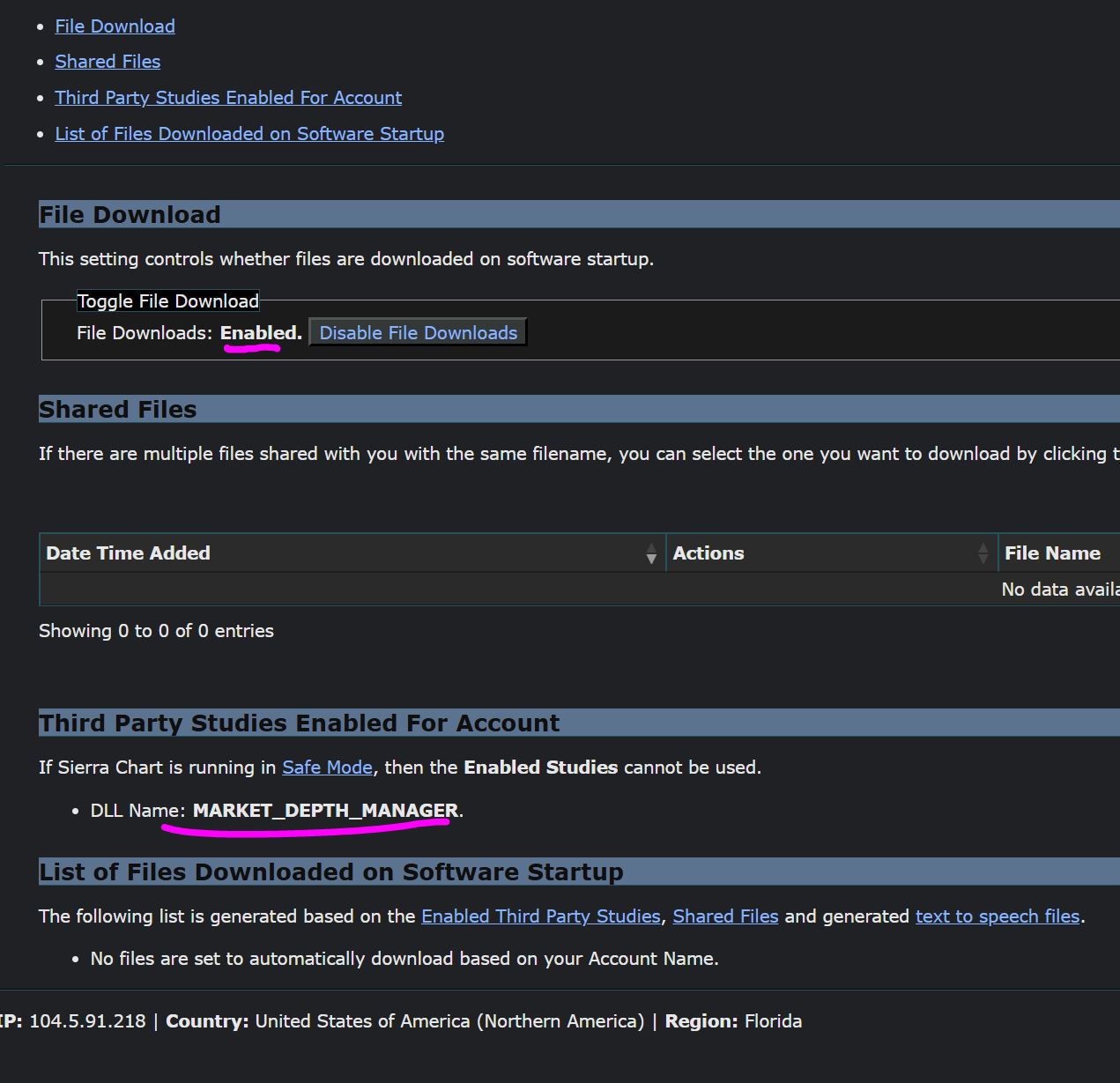

[2026-03-13 01:16:49]
Screen cap of downloads page attached
image2.JPG / V - Attached On 2026-03-13 01:16:22 UTC - Size: 153.37 KB - 175 views

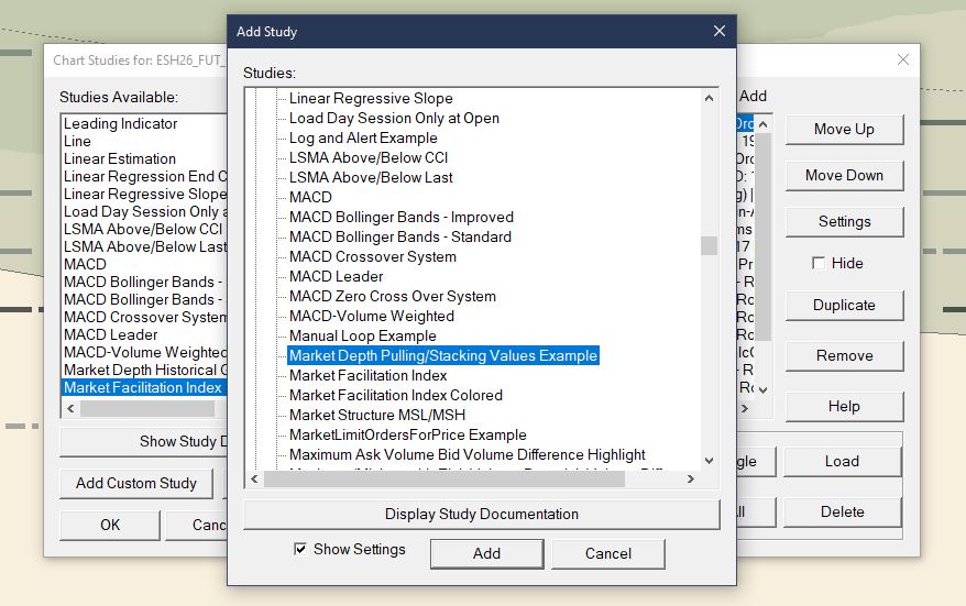

[2026-03-13 13:20:07]
John - SC Support - Posts: 48483
Please do the following:
- Select "Window >> Message Log"
- On the Message Log window select "Edit >> Clear Log"
- Set the Message Log aside (or close it)
- Select "Analysis >> Studies"
- Select "Add Custom Study"
- If the study is not listed, then get us your Message Log by following these instructions and stop here:
- If the section for "MARKET_DEPTH_MANAGER" is showing, then open it
- If the study under "MARKET_DEPTH_MANAGER" is showing, then select it and select the button for "Add"
If you were able to add the study, then tell us what the problem is. You probably need to contact the developer for help if you get to this point.

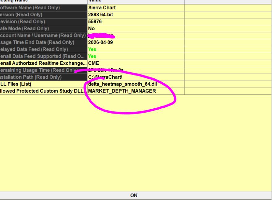

But you are not seeing it in the list of Custom Studies? Can you get us an image of the Custom Study window itself (select "Analysis >> Studies >> Add Custom Study", then get us an image of the window that comes up).
[2026-03-13 15:34:12]
The delta_heatmap_smooth_64.dll shown in the message log is a different study that is working.
It is not the 3rd party enabled MARKET_DEPTH_MANAGER study that I am trying to get to show up.
Image 2 attached is showing the study I am trying to get to show.

image1.JPG / V - Attached On 2026-03-13 15:32:27 UTC - Size: 101.71 KB - 150 views
image2.JPG / V - Attached On 2026-03-13 15:33:50 UTC - Size: 198.58 KB - 133 views

We have looked at the information for the "MARKET_DEPTH_MANAGER" group for distribution, and there are no files associated with that group. This is why you are not getting anything from it.
If you want us to remove you from that group, we can do so, although we do recommend trying to contact the developer again and having them resolve this for you.

One thing we just thought of, is that the developer does not need to actually put any files for distribution if they do not want to. They can control who has access using that process, but they could then distribute the files themselves.
Did they send you any files with an extension of .dll?
If so, then you would need to put those files in the "Data" folder under your main Sierra Chart installation folder (typically this would be "C:\SierraChart\Data").
