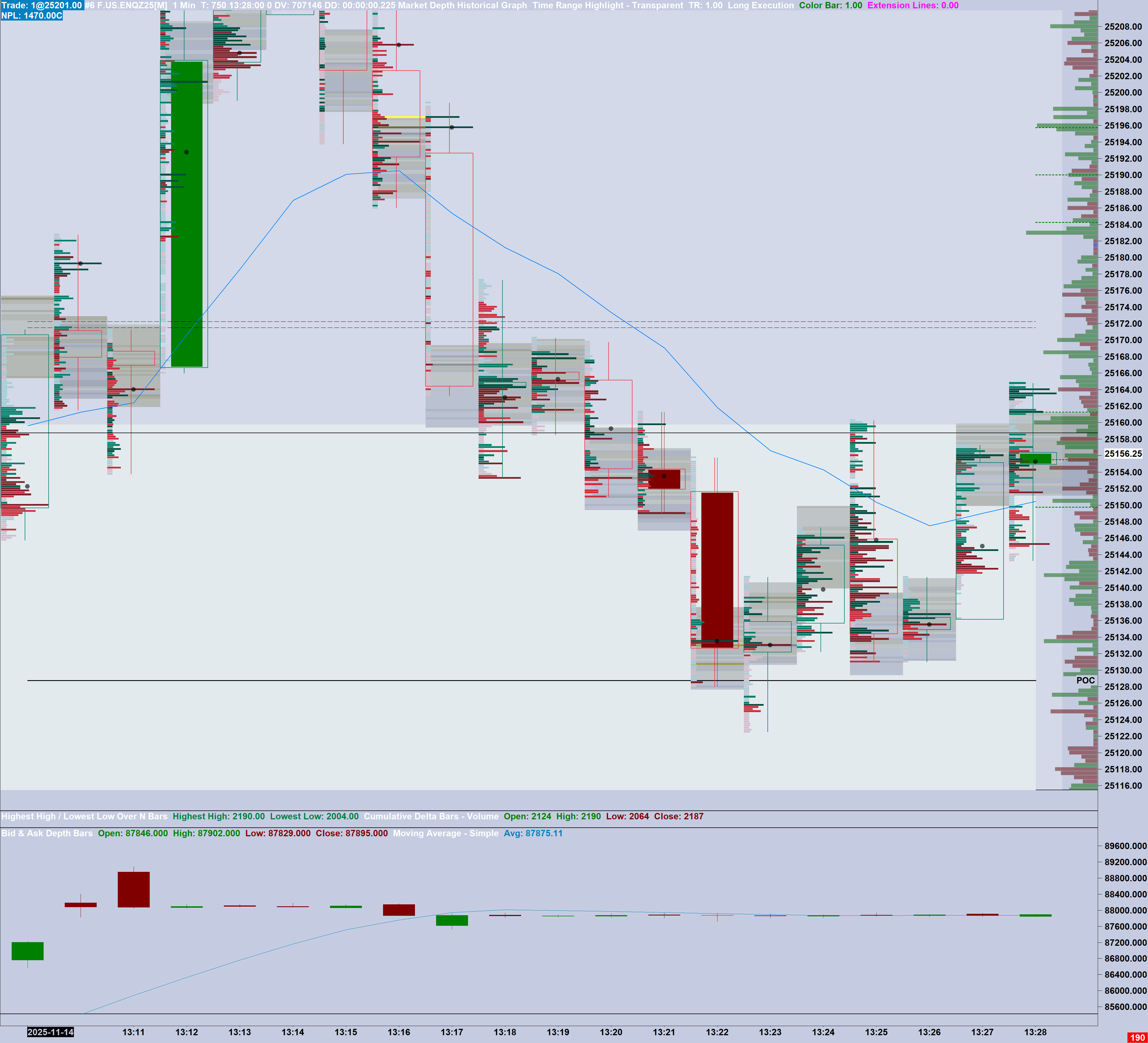

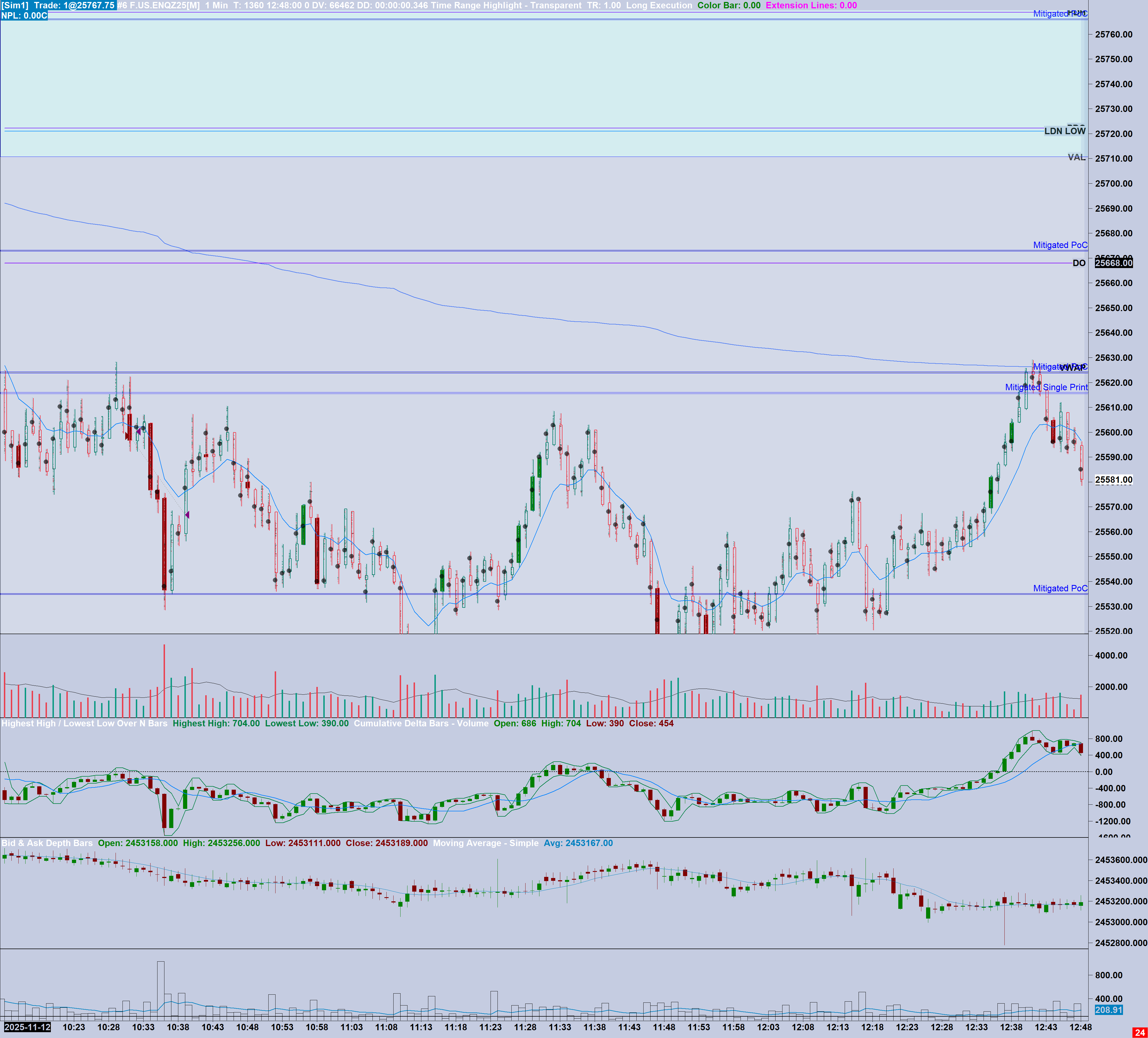

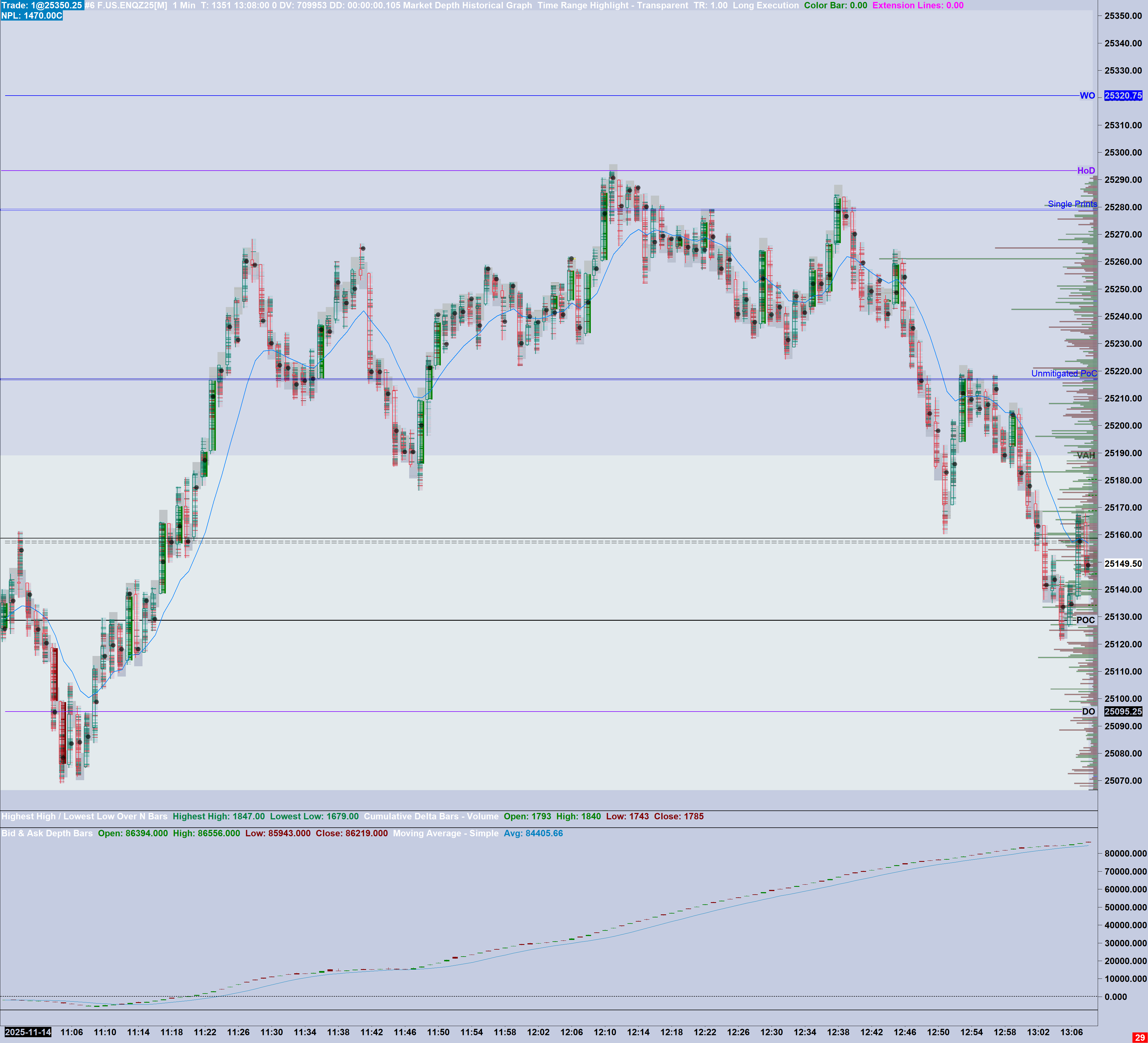

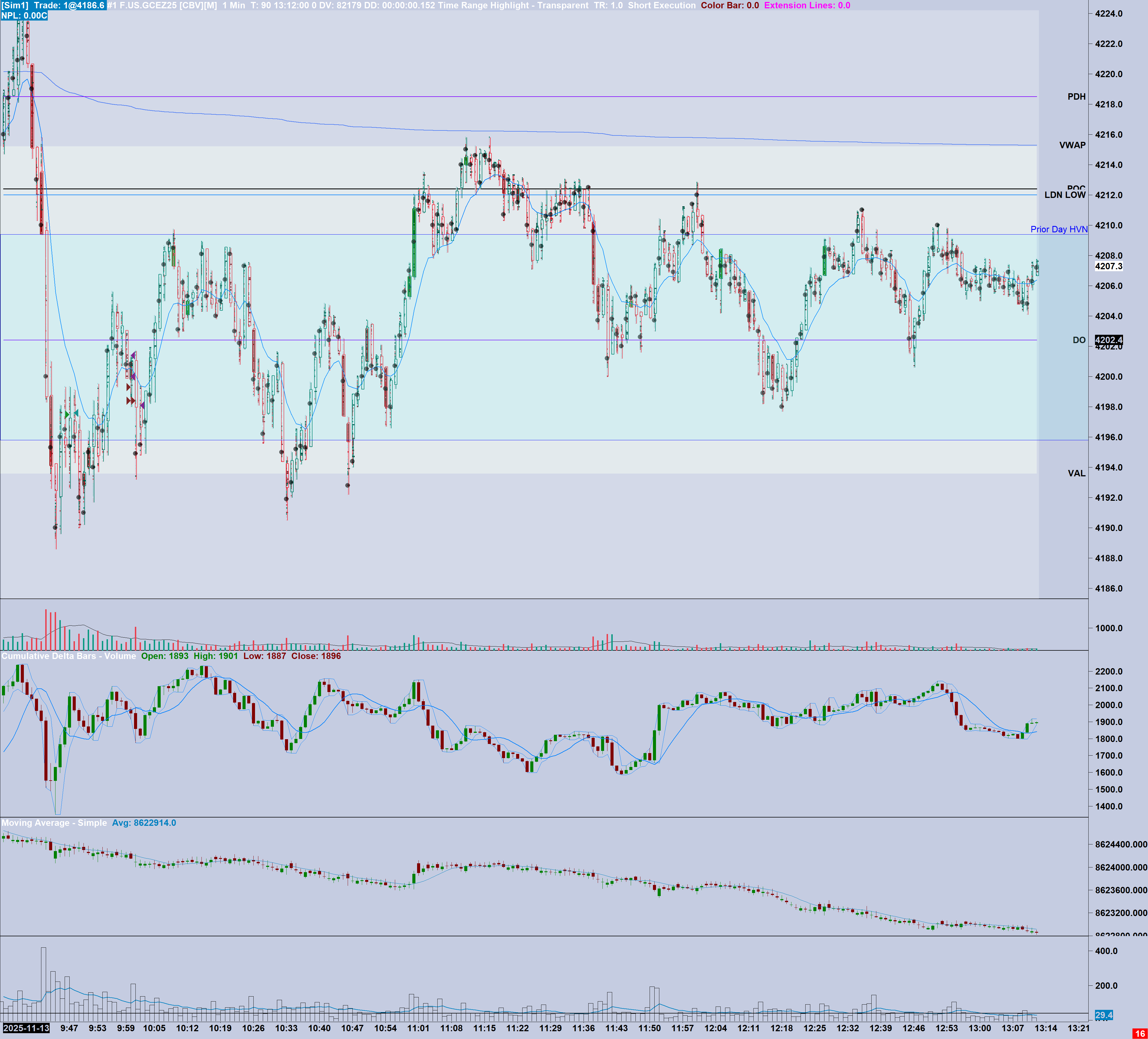

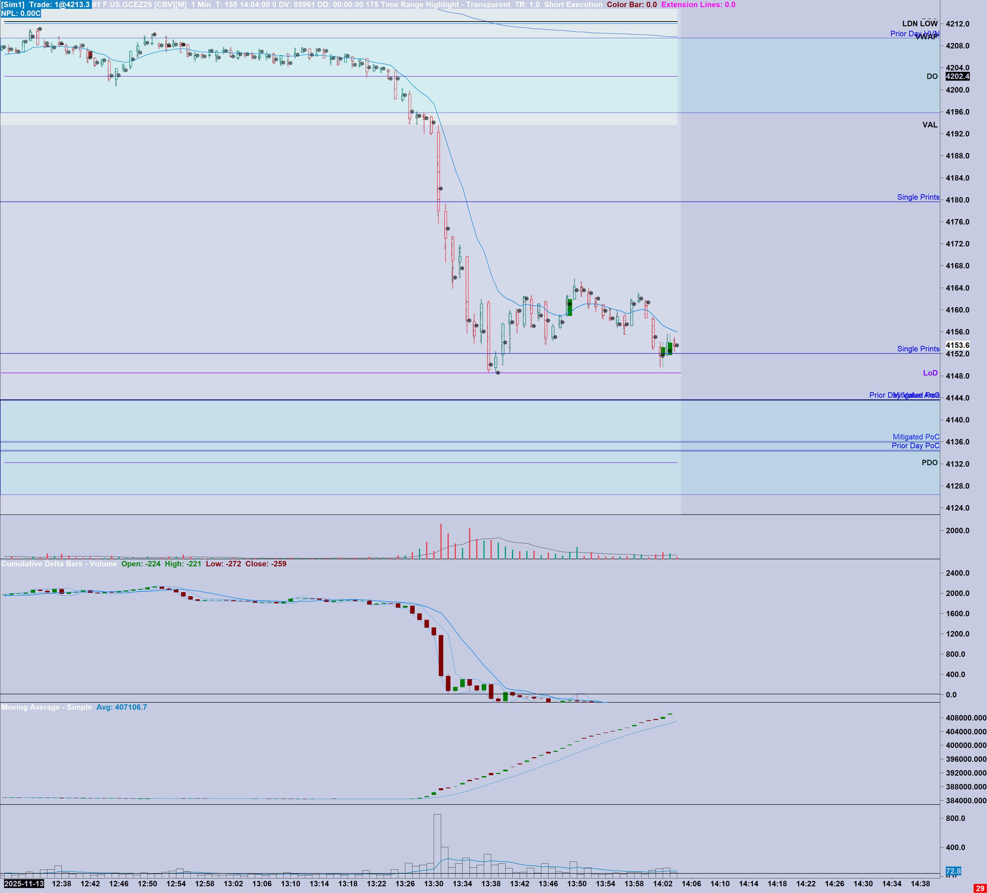

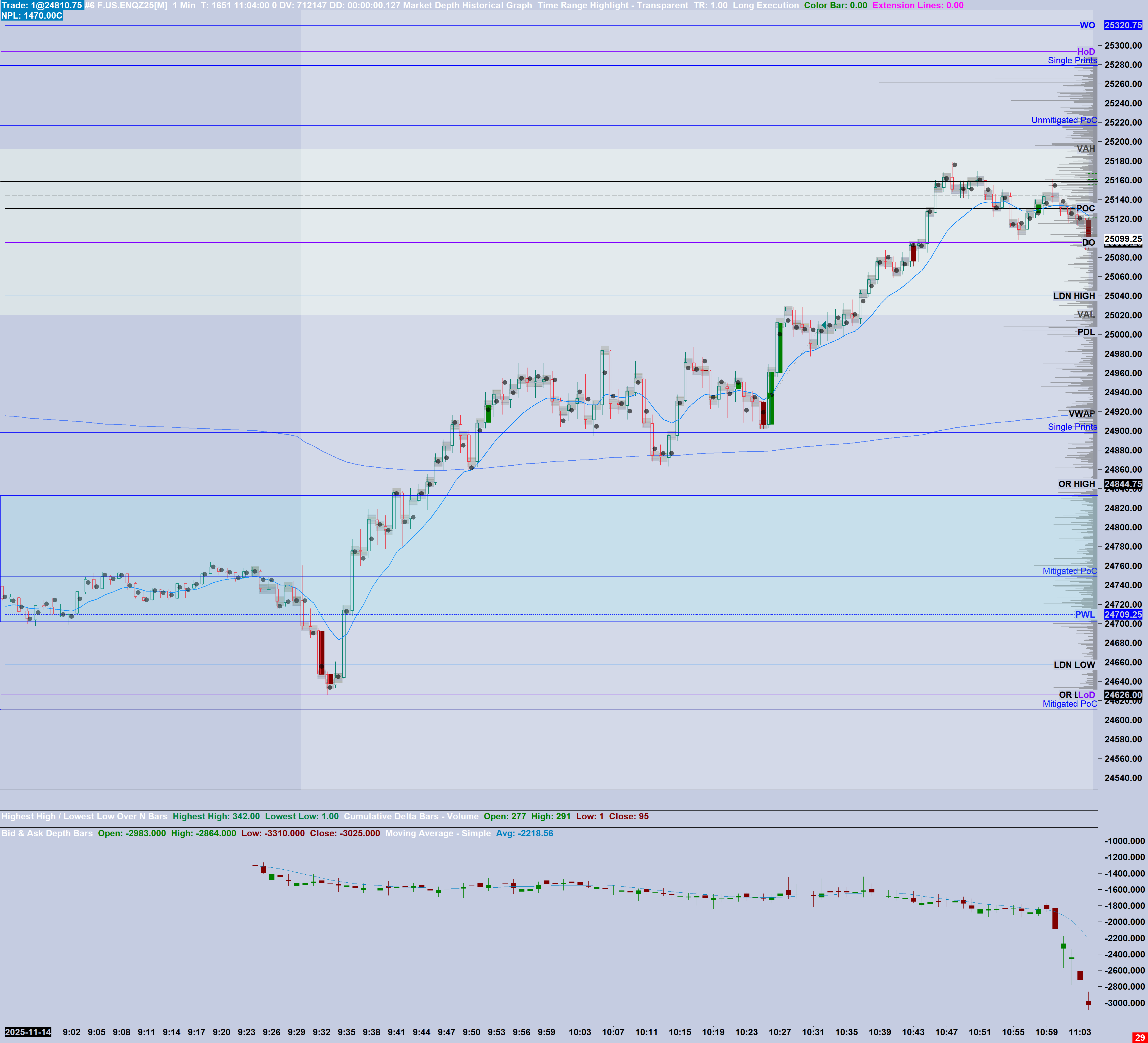

Hi John, Thanks for the speedy response. I have followed the instructions, see attached images presenting identical data: Live Data: https://www.sierrachart.com/image.php?Image=1763114382764.png Delete and Redownload: https://www.sierrachart.com/image.php?Image=1763115217169.png A few observations: - The data or calculation method that Sierra collects / uses when it is connected to live data is different from the data collected from the server when the indicator is not attached. - To put he idea into practice, I have chosen a day were the indicator was not connected to the chart and subsequently gone through the same process outlined in your prior message. Notice that the data remains unchanged similar to the above screenshots. Downloaded data (indicator not attached to chart on the day) https://www.sierrachart.com/image.php?Image=1763115538797.png Delete and Redownload: https://www.sierrachart.com/image.php?Image=176311566482.png - I also found the area where I logged off yesterday and noticed the data change again. Having deleted and redownloaded the data, I was again left with the contrast in data between live and downloaded. I take taken two screenshots as it is challenging to show both with the same detail given the difference in scaling / size. Live Data: https://www.sierrachart.com/image.php?Image=1763116464984.png Downloaded data (post log off) https://www.sierrachart.com/image.php?Image=1763116644581.png Happy to assist again where relevant. Date Time Of Last Edit: 2025-11-14 10:38:50

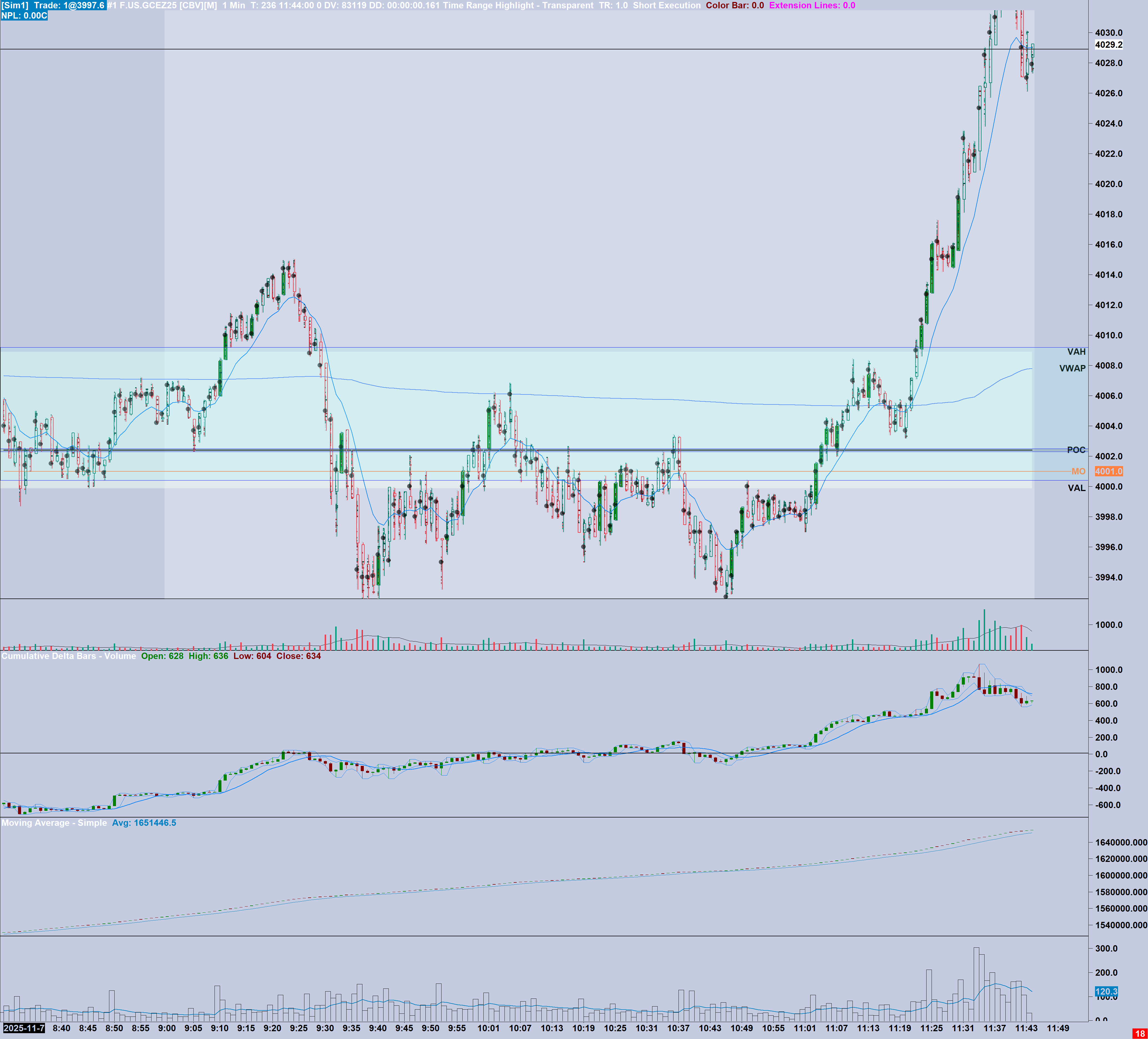

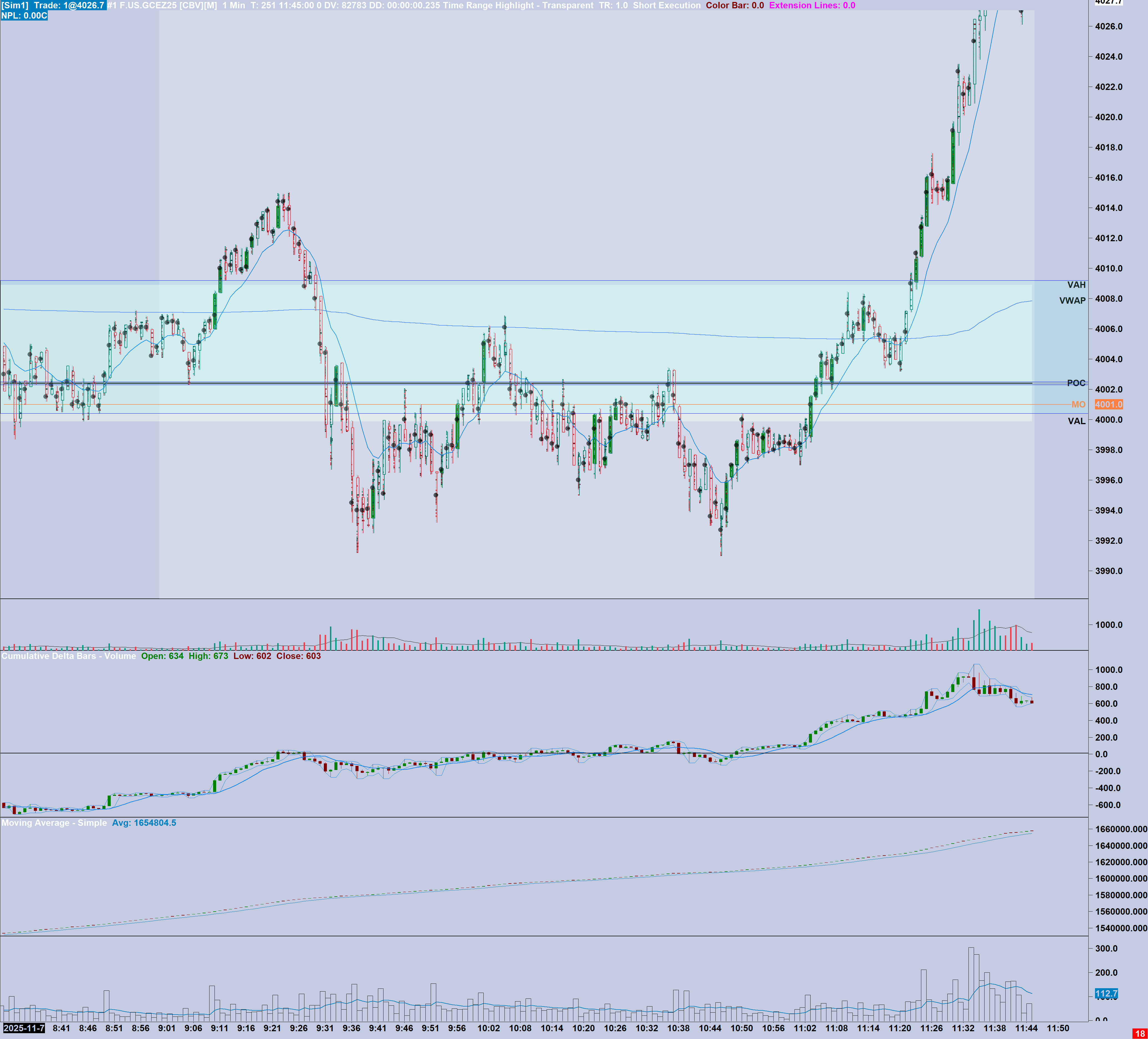

Hi team, - I have simplified the charts to only show the Bid / Ask Depth Bars Study. - I have updated Sierra Chart to the latest version. - I have the professional CME / COMEX package which includes market depth data per the below. Denali Exchange Data Feed: What is Included - I can confirm that the Bid and Ask Depth is active based on your market depth historical graph outlined above. The depth data is present under 'data', the 'record historical data' under symbol is set to yes and custom settings are checked to yes. https://www.sierrachart.com/image.php?Image=1763146871137.png - I have deleted and redownload market depth data from time and date multiple times as requested. The issue still remains, which is that the data displayed is radically different between downloaded directly from server (not live) and live data. Downloaded data: Note it is trending with substantial gaps and no wicks https://www.sierrachart.com/image.php?Image=1763147069192.png Live Data: Note more range bound, less gaps and wick orientated. https://www.sierrachart.com/image.php?Image=1763147190321.png This is consistent across the past 3 days of using the indicator. I appreciate the ongoing communication - Please assist with next steps. |

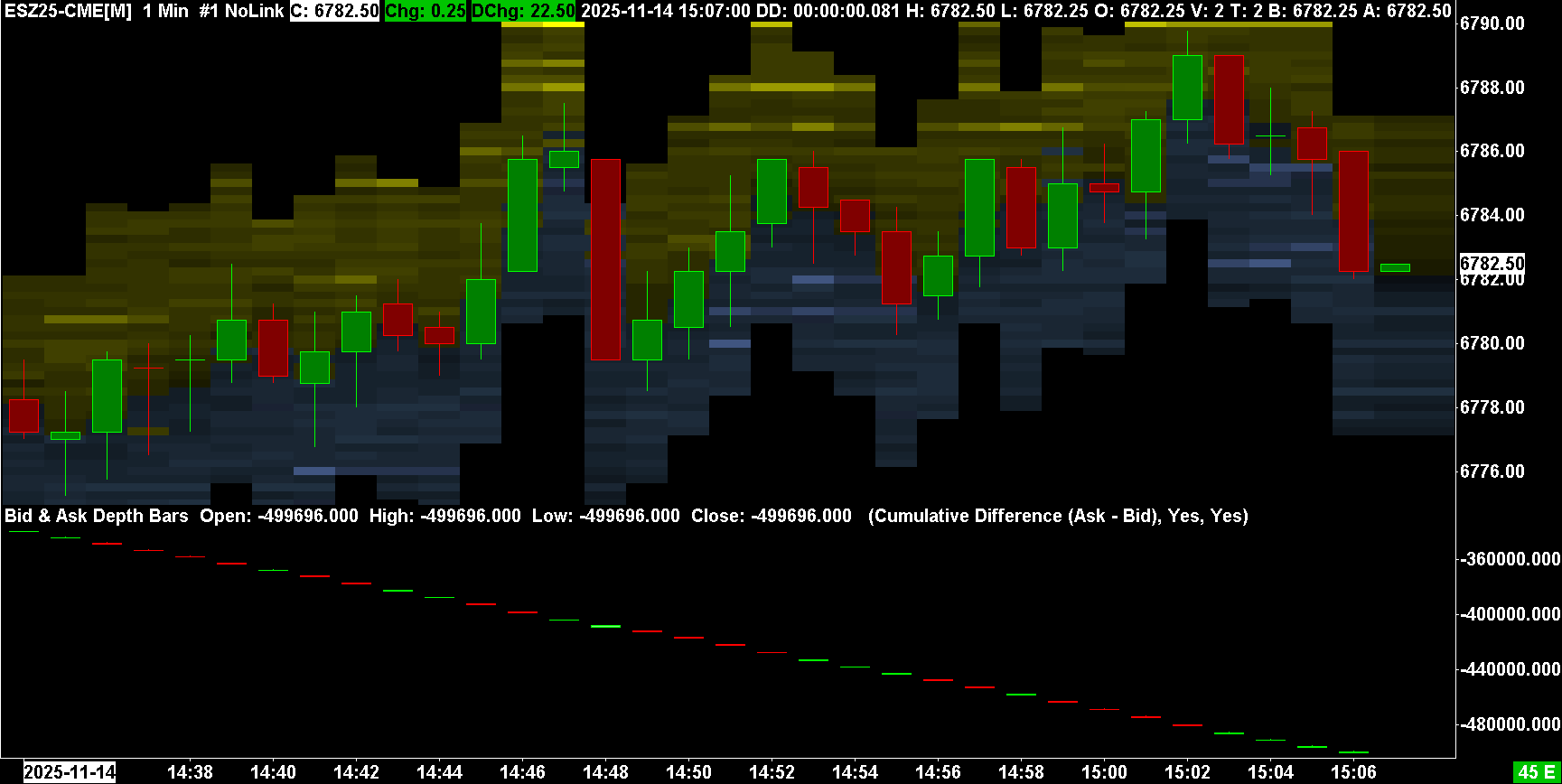

It just occurred to us that this may relate to the "Cumulative" calculation. This may inherently be just how this works. It would make sense, because this is the calculation: Running sum of (Total Ask Quantities - Total Bid Quantities) The opposite calculation with bid minus ask but effectively the same concept. Therefore, this calculation is definitively going to be affected by a changing the first Date-Time loaded in the chart. And also we do not see any bars, with this calculation at all: https://www.sierrachart.com/image.php?Image=17631508214.png So why you are seeing bars we do not know. There is of course a bar but the high and low are very close to each other. Our recommendation is to not use that calculation method. We will not be spending further time on this. This is a good example of when we add features for users, that inherently are difficult concepts to implement, that we then get burdened with more support which we do not want. So please do not use, the Cumulative calculation. Sierra Chart Support - Engineering Level Your definitive source for support. Other responses are from users. Try to keep your questions brief and to the point. Be aware of support policy: https://www.sierrachart.com/index.php?l=PostingInformation.php#GeneralInformation For the most reliable, advanced, and zero cost futures order routing, use the Teton service: Sierra Chart Teton Futures Order Routing Date Time Of Last Edit: 2025-11-14 20:22:23
