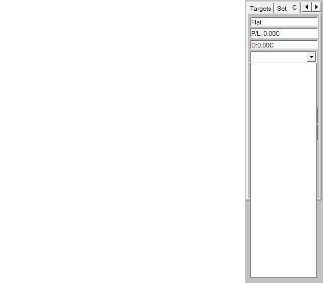

On Sierra chart I'm unable to see/trade my AMP account. In the trade window I used to be able to select the AMP account number, as well as e.g. sim1. I followed the advice on

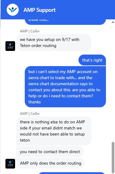

I contacted AMP and they said it was something I should contact you about (see attached image). Apologies if I'm doing something dumb inadvertently

blt - Posts: 231
it could be this:
(open Trade Window for chart)
click on "M"
go to "SETTINGS"
uncheck "HIDE TRADE ACCOUNT LIST"
[2025-09-30 18:31:18]
Are you getting any accounts listed in that pulldown or is it completely blank? If blank, then try what blt suggested.
Otherwise, if see Sim1, then you need to get out of "Simulation Mode" in order to be connected to your live account and select the proper account. To do this select "Trade >> Trade Simulation Mode On" to deselect that option.
[2025-09-30 20:17:11]
brainscan132 - Posts: 14
Thank you both for your replies.
"Trade Simulation Mode On" is unchecked, as is "Hide Trade Account List". The drop down list for accounts to trade is completely blank. I am using SC version 2789.
Any other suggestions would be appreciated. If it would just be easier to move my money into another brokerage account, and connect that to SC, then I could do that if that would help resolve the issue. I don't know what else to try I'm afraid.
Cheers, Seb

[2025-09-30 21:24:48]
We do not believe that this has anything to do with the brokerage you are connected to.
Most commonly, with something like this, it is a Windows Operating System issue where the system is running out of resources to put information into the window properly. Please reboot your computer and only start Sierra Chart when it comes back up and see if the list is populated after that.

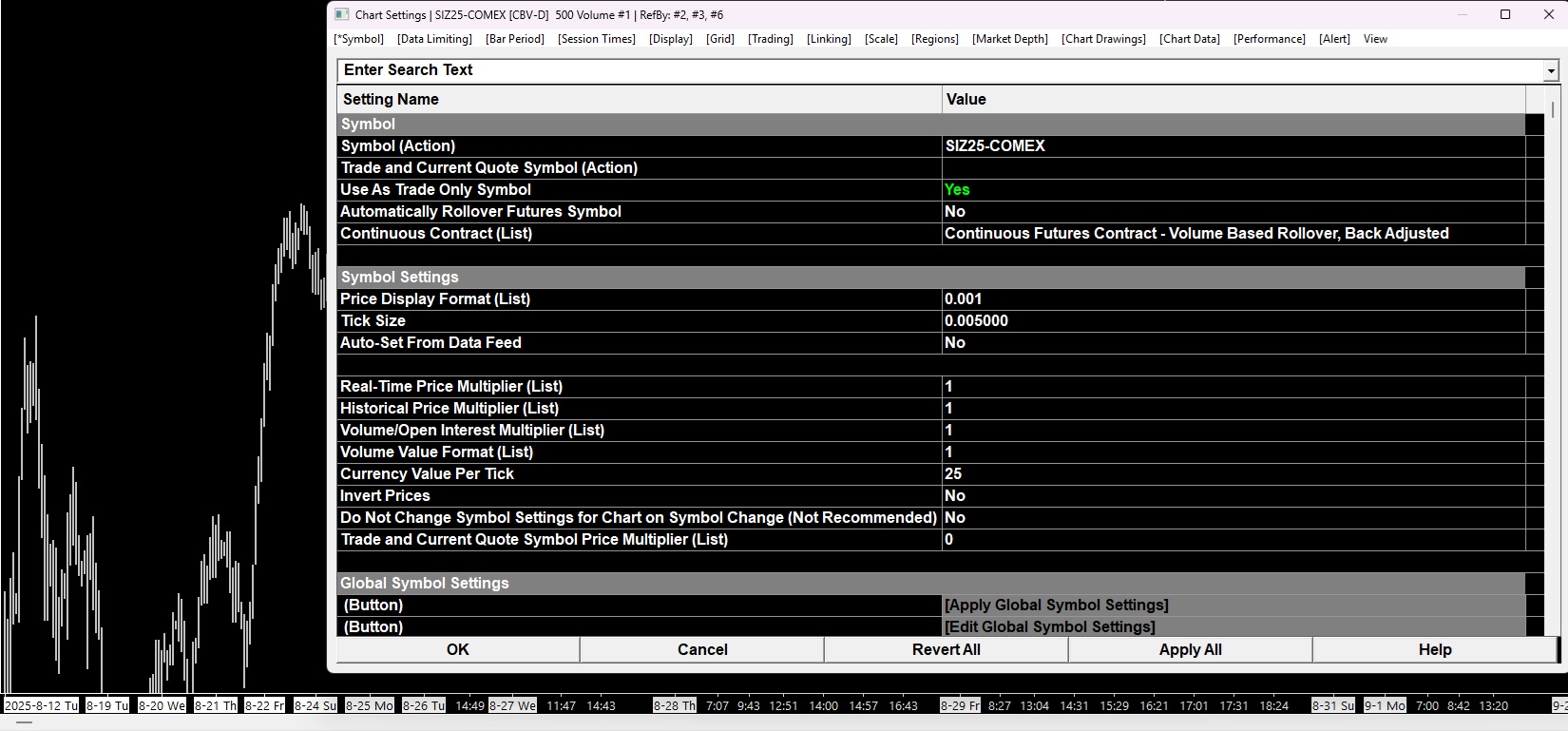

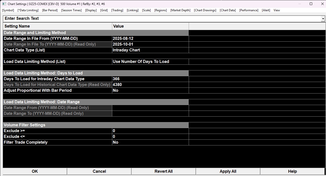

unfortunately now that I've switched my current selected service to Teton, my charts no longer load the required historical intraday data. I have my chart settings set up to load 366 days of data, but it only goes back as far as the 12th August of this year. I have the continuous contact settings as per the attached picture. This is the case with 8 chartbooks across 2 instances of SC. Any advice would be appreciated. Thanks :)

[2025-10-02 18:10:39]
You are using the wrong symbol for Teton. Select "Edit >> Translate Symbols to Current Service" to take care of this.
Whenever you change your service and select OK to close the Data/Trade Service Settings window, you will be prompted to update the symbols for your open chartbooks. You want to answer "Yes" to this, as each service uses a different symbology.
If you forget, or if you open a different chartbook later (that was not open when you updated the symbols) then use the "Edit >> Translate Symbols to Current Service" option.
