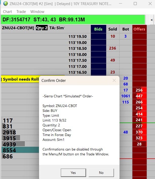

I tried to place bid and nothing happened.

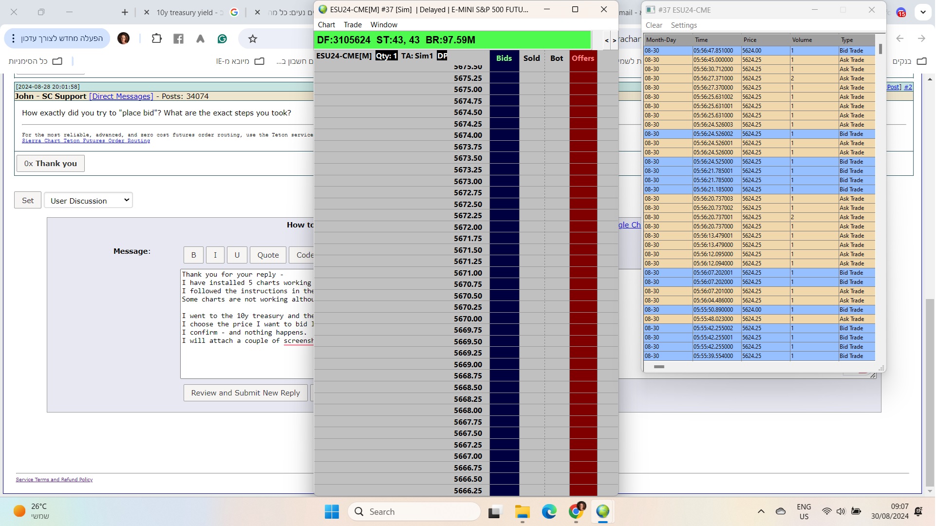

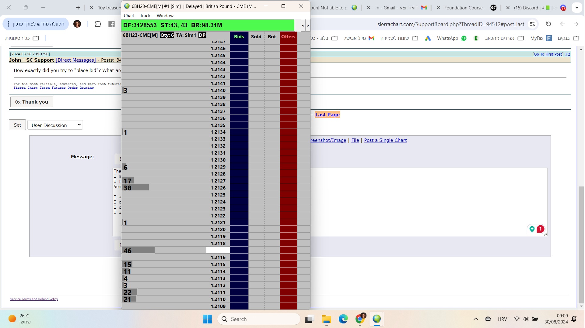

I have installed 5 charts working with G7FX data.
I followed the instructions in the course.
Some charts are not working although I have manually updated the dates...
I went to the 10y treasury and the British CME
I choose the price I want to bid I click on it and a window opens.
I confirm - and nothing happens.
I will attach a couple of screenshots for both issues.

We are not understanding the situation. What are the exact steps you are taking to put in an order. We need to know what/where you are clicking or what keys you are using, etc. We need the exact steps.
Additionally, the one image you show with the confirmation popup shows that the symbol you are using needs a rollover. The U contract is not traded much at this time, you need to change to the Z contract for the ZN.
But, that order should have shown on your chart if you selected Yes to the confirmation. What happened after you selected Yes?

I tried to place a bid and pressed YES to confirm in the window.
The confirmation window disappeared, and another window opened with the history of the last few days.
The last raw says
2024-09-06 09:47:45:784
Last order trade -New order rejected - trade >> Trading Locked is enabled. ID: 20. Service order ID;(none). Symbol: ZNU24-CBOT. Account: Sim1 *
[2024-09-06 15:11:50]
John - SC Support - Posts: 48028
You have the option for "Trade >> Trading Locked" enabled. Select this option to remove the checkmark next to that item in order to be able to trade.
