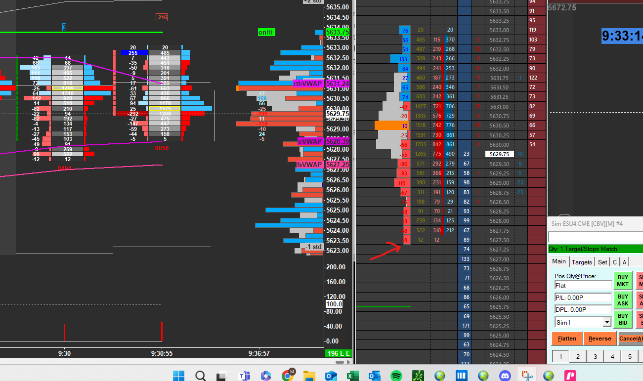

attached please find a screen shot of the low of the day so far...and for some reason my delta shows 48 on the dom when only 12 contracts traded ...can you please advise?
[2024-08-21 18:13:16]
There is no image attached. Please follow these instructions to get us an image:
[2024-08-22 12:16:04]
coachted - Posts: 544
please note on the dom that a total of 12 contracts traded at the low and yet the delta says -48...even the delta for the preceding prices are worng if you just take the ask -bid...there is a footprint chart ,,,1st pic, refelcting the correct delta...
imageScreenshot 2024-08-21 094456.png / V - Attached On 2024-08-22 12:14:13 UTC - Size: 196.62 KB - 383 views
[2024-08-22 16:11:54]
Set Sierra Chart to a Tick by Tick Data Configuration. Follow the instructions here to do this:

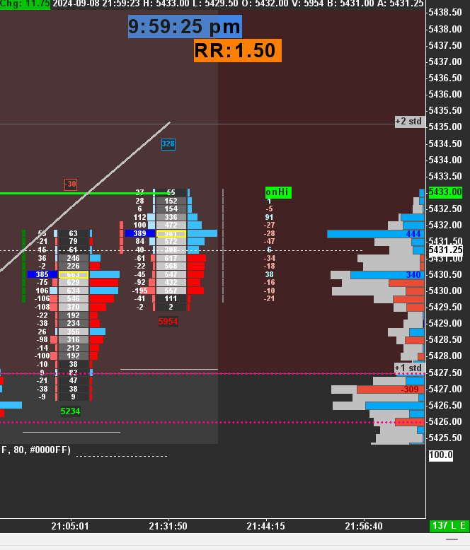

I am using the foot[rint chart in sc and have the pb column on ...is there a setting to define the pb amount????so for example today in the es there are two instances where the book was swept for large amounts yet the pb column does not reflect it..the times are 10:39:13.461 and 10:3:24.574...these were sweeps for over 500 contracts over roughly 3 or 4 points yet i could not see the net delta of those sweeps in the pb ...yes these sweeps did move up 3 points and then right back down...is there a way to capture these in the pb column...currenlty i can see them in BM...i also see it in time and sales yet not the pb column on fp chart
attached please find a picture of the later time i am speaking about
Date Time Of Last Edit: 2024-09-06 19:59:36
imageScreenshot 2024-09-06 155815.png / V - Attached On 2024-09-06 19:59:19 UTC - Size: 336.01 KB - 261 views
[2024-09-06 20:14:29]
Refer to the following for how the Pullback column in the Numbers Bars study works:
Numbers Bars: Pullback Column

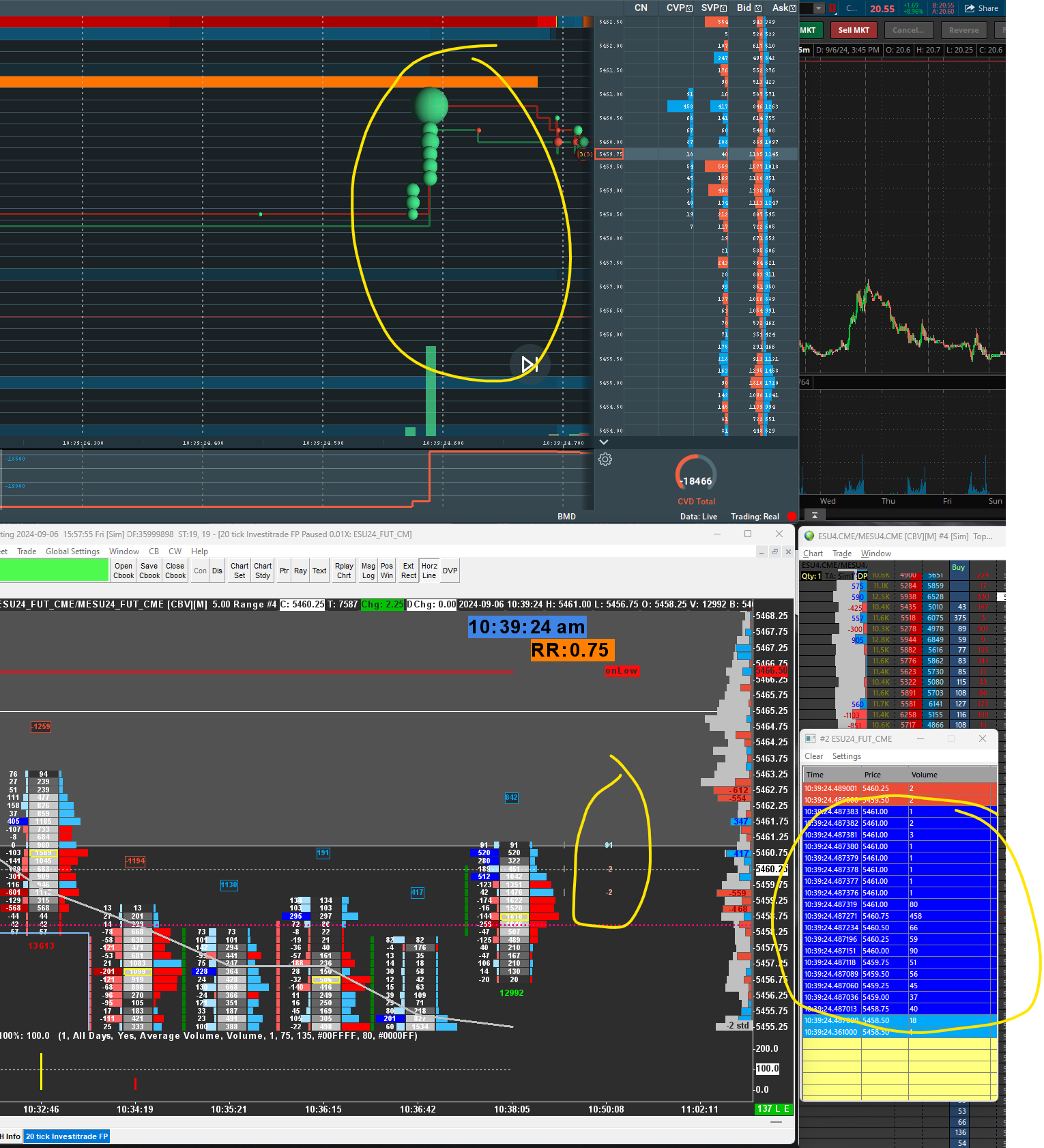

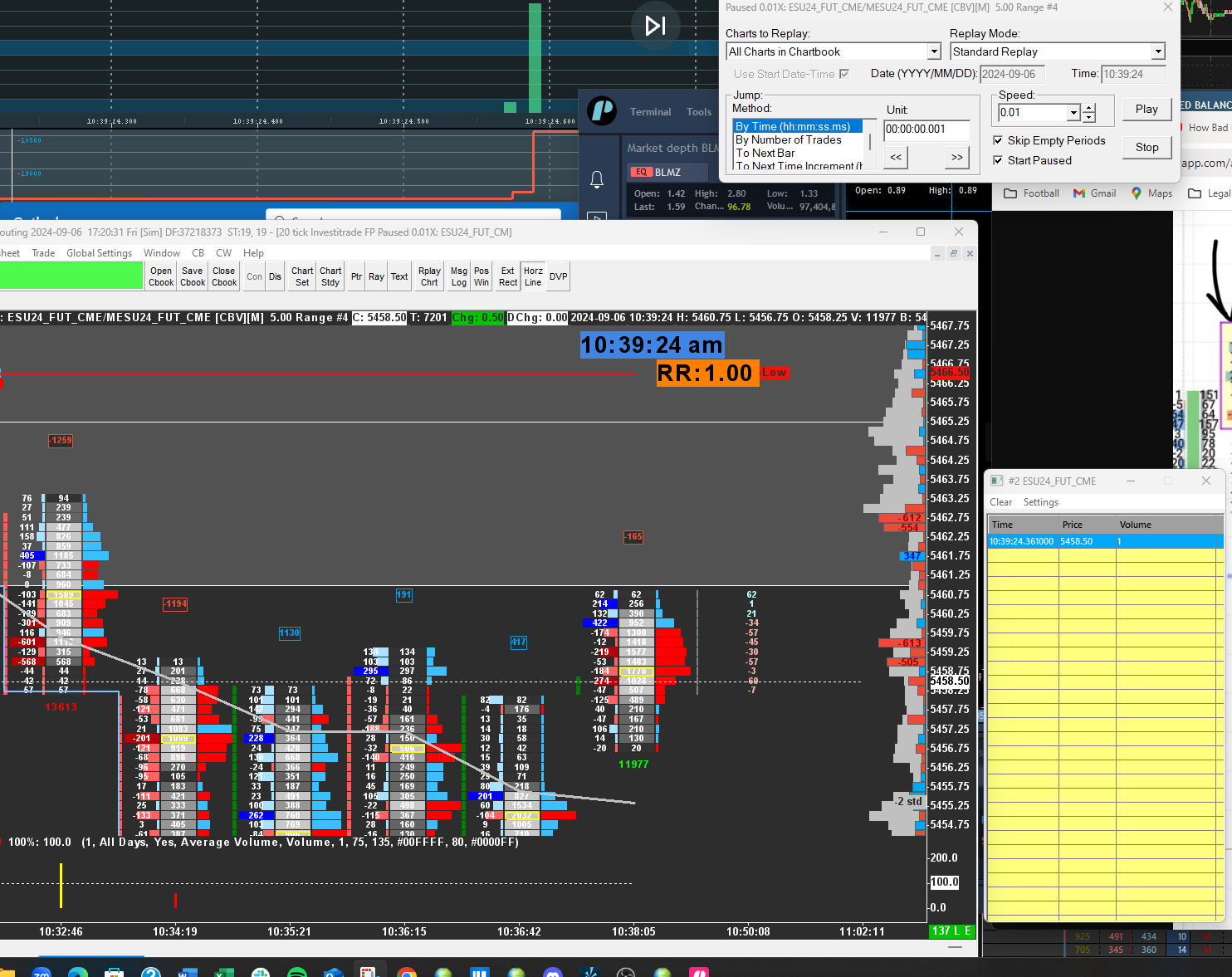

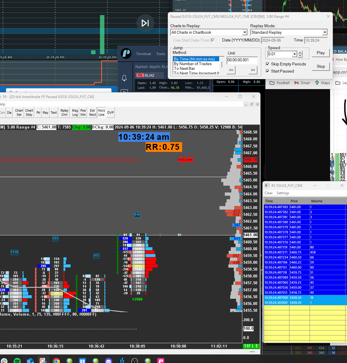

i am confused and may not be conveying my question properly....here are two different pics 1 ms apart...the 1st pic is before the sweep ...the 2nd pic is 1 ms after which includes the sweep...the sweep can be seen in the time and sale YET the pb column shows nothing other than the delta at the high of the sweep. Why does the delta not show in the pb column....
imageScreenshot 2024-09-06 172038.png / V - Attached On 2024-09-06 21:30:09 UTC - Size: 255.63 KB - 253 views
imageScreenshot 2024-09-06 172129.png / V - Attached On 2024-09-06 21:30:17 UTC - Size: 232.04 KB - 314 views
more importantly what cuases the pb column to reset and can this be modified? I have seen the pb column 5 points long and also seen it reset after 3 tics...so i am confused

I am not the brightest bulb in the pack and need help...attached please find a picture of my current numbers bars....I am trying to get the volume , column 2, to have the text black if the volume is 1000 or more, and any volume 999 and under be white.
thank you I truly appreciate your help.
Mike
Date Time Of Last Edit: 2024-09-09 02:18:15
imageScreenshot 2024-09-08 215930.png / V - Attached On 2024-09-09 02:03:16 UTC - Size: 54.66 KB - 248 views
[2024-09-09 17:11:01]
The Pullback Column resets whenever there is a new high or a new low for the current bar. Refer to the information here:
It does not sound like the pullback column will give you what you are looking for.
Set the following Inputs for the Numbers Bars Study:
- Column 2 Text Coloring Method: Based on Volume - Actual
- Use Separate Colors for Text Coloring: Yes
- Range 3 Up Color for Text: Black
- Range 2 Up Color for Text: White
- Range 1 Up Color for Text: White
- Range 0 Up Color for Text: White
- Range 0 Down Color For Text: White
- Range 1 Down Color for Text: White
- Range 2 Down Color for Text: White
- Range 3 Down Color for Text: Black
- Column 2 Actual Volume Compare Thresholds: 0, 0, 1000

The pullback column in the Numbers Bars always resets when there is a new high or low in the most recent bar. Refer to the following:
What are you trying to accomplish? We do not think the pullback column gives you what you are looking for.

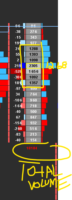

This was awesome thank you so much...I asked this question before and did not see how to do it and apologize to ask again...is there a way I can show the % of bars total volume at each price point in the bar (range bar)..I am curious if the % can show in the histogram???
I have attached a picture of a numbers bar with an example to clarify my question..this example is ony at 1 price point i would like percentages at all price point..
Once again I am sorry for any confusion.
imageScreenshot 2024-09-22 130021.png / V - Attached On 2024-09-22 17:09:40 UTC - Size: 32.41 KB - 268 views
[2024-09-23 13:51:38]
The Numbers Bars study does not have the option to display the numbers as a percentage of total volume. There is a "Dominant Side Volume Percent", but this is not what you are looking for.
An option is to use the "Volume by Price" study and set the "Volume Graph Period Type" to be "Multiple Profiles Based on Bar Count" and set the "Number of Bars for 'Based on Bar Count'" to be "1".
Then you can use either "Percent of Maximum Volume of Volume Bars" or "Percent of Total Volume" for the "Display Volume in Bars".

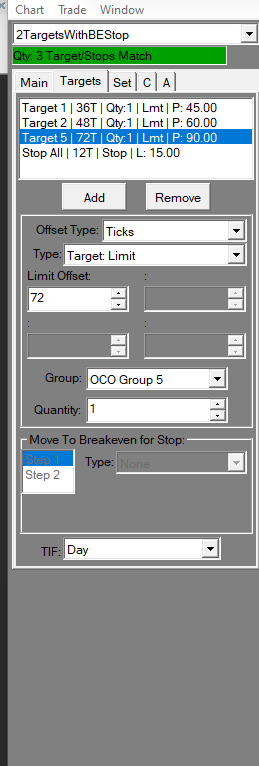

[2024-09-25 16:07:40]
so this is the order type i use for all my trades....how can i tell if it is at the exchange or on my pc? Reason I ask I live in florida and we are getting a hurricane and do not know if I should trade or not...my concern is getting in a trade and then losing interent...Thank you for your constant help by the way
Date Time Of Last Edit: 2024-09-25 16:16:24
imageScreenshot 2024-09-25 120553.png / V - Attached On 2024-09-25 16:06:05 UTC - Size: 22.61 KB - 253 views
[2024-09-25 16:37:42]
So you are referring to the Limit Attached Order? We need to know what Trading service you are using. Is it Teton order routing?
[2024-09-25 16:41:00]
Yes I am using teton order routing, but i also just mkt in most of the time using the mkt sell button on the attached trade window
Date Time Of Last Edit: 2024-09-25 16:42:21
