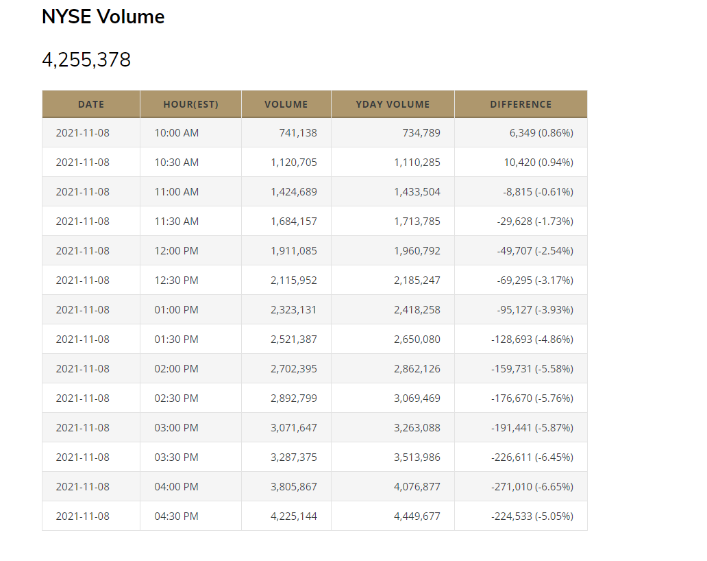

I am getting these values from Jim Dalton website; he shares NYSE volume data there. He says he uses that instead of futures volume. He says he finds it more helpful than futures volume (because of hedging/spreading etc...) ? I wanted to track the NYSE volume and see if it is useful for me.
He uses Think or Swim (TOS) platform for some of his data; I think this is where he would be getting the NYSE volume from.
I could just look at it on his website but it would be more efficient if i could display it on my sierra charts.

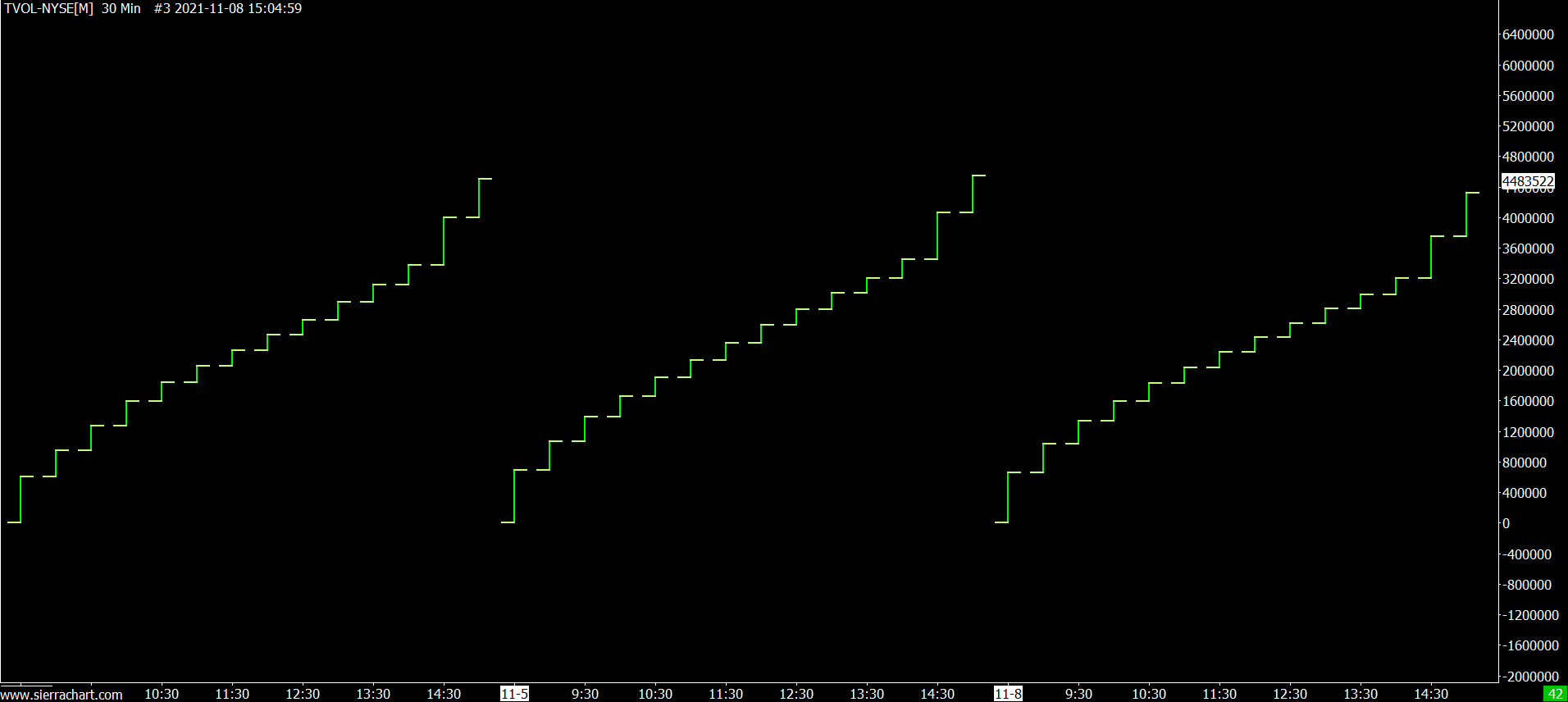

[2021-11-08 21:46:06]
Here is what the TVOL-NYSE looks like for us with a 30 minute setting:
http://www.sierrachart.com/image.php?Image=1636407831717.png
Are you opening an Intraday Chart or an Historical Chart?
To multiply by 1000, you can use the VAP Multiplier and set it to 1000. Or you can use the Study Subgraph Multiply to multiply the volume by 1000 and output that to another region. Refer to the following:

i can attach the values i am looking at in case that helps ?
Thank you
imageJD NYSE volume.PNG / V - Attached On 2021-11-08 22:14:46 UTC - Size: 74.53 KB - 259 views

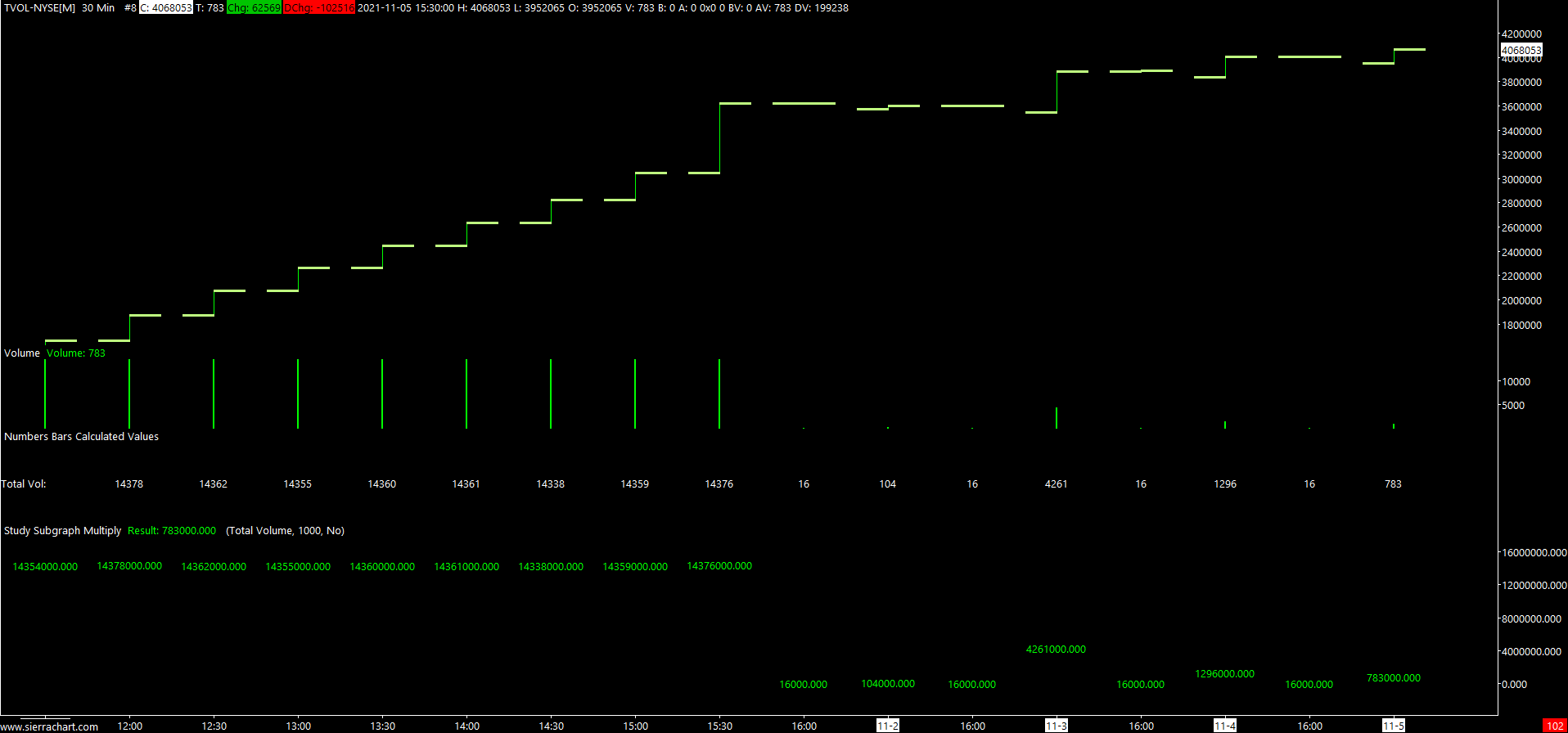

Can you please get us a screenshot of what you are seeing by following these instructions:
[2021-11-08 23:36:23]
Steve Leon - Posts: 319
http://www.sierrachart.com/image.php?Image=1636414536491.png
[2021-11-09 14:42:23]
Please get us a copy of that chart by following these instructions:
[2021-11-09 23:16:31]
this is the chart
TVOL-NYSE
has 30 min bar chart for 10 days; only the first day is in 30 min intervals
i have volume, numbers bars and study subgraph multiply
i think the big issue is the discrepancy between the numbers from the screenshot of NYSE volume that i previously sent
Thank you
Steven Leon
attachmentTVOL-NYSE.Cht - Attached On 2021-11-09 23:12:29 UTC - Size: 3.85 KB - 462 views
