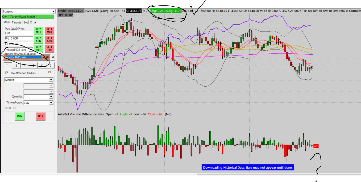

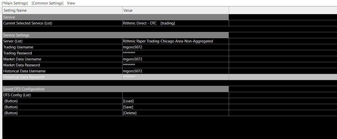

I want to pass the evaluation from Earn2Trade and would really like to stick to Sierra. They gave me details for Rithmic data feed and I was able to successfully log in after following your instructions from https://www.sierrachart.com/index.php?page=doc/Rithmic.php#SetupInstructions. I am able to see the current price on chart statistics (see screenshot) and launch DOM which is working fine. There is however a problem with downloading data to the chart. It keeps downloading for several hours already which is not normal. Can you please advise?

Historical data is not available through the Rithmic connection. If you want historical data, you will need to use the Denali Exchange Data Feed and have a live trading account that you can connect to (CME Group rules for non-professional exchange fees). Refer to the following:
Real-Time Exchange Data Feeds Available From Sierra Chart: Understanding and Accessing Data From the CME, CBOT, NYMEX, COMEX Exchanges
Earn2Trade does not count as a live trading account, therefore we recommend the following solution if you do not already have a trading account that you can use:
Easy Solution to CME Funded Trading Account Requirement
[2021-10-28 17:00:45]
