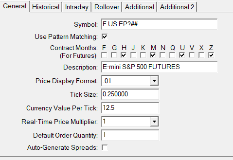

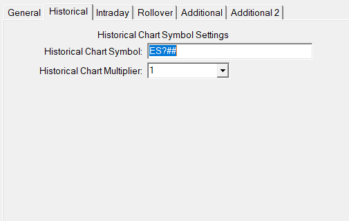

Which brings me to the next question, did you change Sierra Chart Historical Data Symbols or the way in which they integrate with broker data feeds?
Attached are the two symbol settings for ES:
Date Time Of Last Edit: 2018-12-22 14:18:46

[2018-12-22 20:57:03]
There is no need for all of this information. We just simply need to know that there is missing data and you can post an image of the chart following the instructions here:
Fully re-download the data in the chart by going to the chart and following these procedures here:
Follow those procedures step-by-step. Do not skip any step including optional steps.

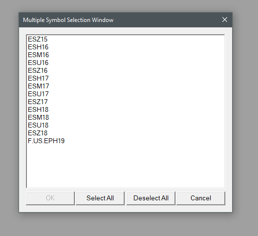

[2018-12-22 21:58:28]
cmet - Posts: 746
It's a problem with your historical data symbols.
I'll try to do the rest of that today. For now, when I use the instructions to "delete and re-download historical data", I get a list of ES contract symbols. They are in the image below.
However, when I go to download the data, the Message Log is telling me that those symbols don't exist.
Symbol Error - ESU17 is unknown, unavailable, or improperly formatted. Requested symbol was not found. | 2018-12-22 13:46:21
HD Request # 31 | Downloading Historical Daily chart data for ESZ17. Starting date: 1968-12-22. Service: cqgfix | 2018-12-22 13:46:21
CQG FIX Trading | Sending symbol resolution request for ESZ17. ID: 793199 | 2018-12-22 13:46:21
CQG FIX Trading | Received message: Requested symbol was not found. | 2018-12-22 13:46:21
HD Request # 31 | Error downloading historical Daily data for ESZ17. Requested symbol was not found. | 2018-12-22 13:46:21
HD Request # 31 | Received 0 records from 00:00:00 to 00:00:00 (0.0 seconds) and wrote 0 records for ESZ17 | 2018-12-22 13:46:21
HD Request # 31 | Completion time: 0s | 2018-12-22 13:46:21
HD Request # 31 | Daily data download complete for ESZ17. Unique request ID: 28 | 2018-12-22 13:46:21
Removed historical data download ID 28 | 2018-12-22 13:46:21
Symbol Error - ESZ17 is unknown, unavailable, or improperly formatted. Requested symbol was not found. | 2018-12-22 13:46:21
HD Request # 32 | Downloading Historical Daily chart data for ESH18. Starting date: 1968-12-22. Service: cqgfix | 2018-12-22 13:46:21
CQG FIX Trading | Sending symbol resolution request for ESH18. ID: 793200 | 2018-12-22 13:46:21
HD Request # 32 | Error downloading historical Daily data for ESH18. Requested symbol was not found. | 2018-12-22 13:46:21
HD Request # 32 | Received 0 records from 00:00:00 to 00:00:00 (0.0 seconds) and wrote 0 records for ESH18 | 2018-12-22 13:46:21
HD Request # 32 | Completion time: 0s | 2018-12-22 13:46:21
HD Request # 32 | Daily data download complete for ESH18. Unique request ID: 29 | 2018-12-22 13:46:21
Removed historical data download ID 29 | 2018-12-22 13:46:21
Symbol Error - ESH18 is unknown, unavailable, or improperly formatted. Requested symbol was not found. | 2018-12-22 13:46:21
HD Request # 33 | Downloading Historical Daily chart data for ESM18. Starting date: 1968-12-22. Service: cqgfix | 2018-12-22 13:46:21
HD Request # 33 | Error downloading historical Daily data for ESM18. The symbol is unknown to the server. | 2018-12-22 13:46:21
HD Request # 33 | Received 0 records from 00:00:00 to 00:00:00 (0.0 seconds) and wrote 0 records for ESM18 | 2018-12-22 13:46:21
HD Request # 33 | Completion time: 0s | 2018-12-22 13:46:21
HD Request # 33 | Daily data download complete for ESM18. Unique request ID: 30 | 2018-12-22 13:46:21
Removed historical data download ID 30 | 2018-12-22 13:46:21

HD Request # 39 | Downloading Historical Daily chart data for ESM14. Starting date: 1968-12-22. Service: cqgfix | 2018-12-22 14:12:18
CQG FIX Trading | Sending symbol resolution request for ESM14. ID: 793203 | 2018-12-22 14:12:18
CQG FIX Trading | Received message: Requested symbol was not found. | 2018-12-22 14:12:18
HD Request # 39 | Error downloading historical Daily data for ESM14. Requested symbol was not found. | 2018-12-22 14:12:18
HD Request # 39 | Received 0 records from 00:00:00 to 00:00:00 (0.0 seconds) and wrote 0 records for ESM14 | 2018-12-22 14:12:18
HD Request # 39 | Completion time: 0s | 2018-12-22 14:12:18
HD Request # 39 | Daily data download complete for ESM14. Unique request ID: 36 | 2018-12-22 14:12:18
Removed historical data download ID 36 | 2018-12-22 14:12:18
Symbol Error - ESM14 is unknown, unavailable, or improperly formatted. Requested symbol was not found. | 2018-12-22 14:12:18
HD Request # 40 | Downloading Historical Daily chart data for ESU14. Starting date: 1968-12-22. Service: cqgfix | 2018-12-22 14:12:18
CQG FIX Trading | Sending symbol resolution request for ESU14. ID: 793204 | 2018-12-22 14:12:18
HD Request # 40 | Error downloading historical Daily data for ESU14. Requested symbol was not found. | 2018-12-22 14:12:18
HD Request # 40 | Received 0 records from 00:00:00 to 00:00:00 (0.0 seconds) and wrote 0 records for ESU14 | 2018-12-22 14:12:18
HD Request # 40 | Completion time: 0s | 2018-12-22 14:12:18
HD Request # 40 | Daily data download complete for ESU14. Unique request ID: 37 | 2018-12-22 14:12:18
Removed historical data download ID 37 | 2018-12-22 14:12:18
Symbol Error - ESU14 is unknown, unavailable, or improperly formatted. Requested symbol was not found. | 2018-12-22 14:12:18
HD Request # 41 | Downloading Historical Daily chart data for ESZ14. Starting date: 1968-12-22. Service: cqgfix | 2018-12-22 14:12:18
CQG FIX Trading | Sending symbol resolution request for ESZ14. ID: 793205 | 2018-12-22 14:12:18
HD Request # 41 | Error downloading historical Daily data for ESZ14. Requested symbol was not found. | 2018-12-22 14:12:18
HD Request # 41 | Received 0 records from 00:00:00 to 00:00:00 (0.0 seconds) and wrote 0 records for ESZ14 | 2018-12-22 14:12:18
HD Request # 41 | Completion time: 0s | 2018-12-22 14:12:18
HD Request # 41 | Daily data download complete for ESZ14. Unique request ID: 38 | 2018-12-22 14:12:18
Removed historical data download ID 38 | 2018-12-22 14:12:18
Symbol Error - ESZ14 is unknown, unavailable, or improperly formatted. Requested symbol was not found. | 2018-12-22 14:12:18
HD Request # 42 | Downloading Historical Daily chart data for ESH15. Starting date: 1968-12-22. Service: cqgfix | 2018-12-22 14:12:18
CQG FIX Trading | Sending symbol resolution request for ESH15. ID: 793206 | 2018-12-22 14:12:18
CQG FIX Trading | Received message: Requested symbol was not found. | 2018-12-22 14:12:19
HD Request # 42 | Error downloading historical Daily data for ESH15. Requested symbol was not found. | 2018-12-22 14:12:19
HD Request # 42 | Received 0 records from 00:00:00 to 00:00:00 (0.0 seconds) and wrote 0 records for ESH15 | 2018-12-22 14:12:19
HD Request # 42 | Completion time: 0s | 2018-12-22 14:12:19
HD Request # 42 | Daily data download complete for ESH15. Unique request ID: 39 | 2018-12-22 14:12:19
Removed historical data download ID 39 | 2018-12-22 14:12:19
Symbol Error - ESH15 is unknown, unavailable, or improperly formatted. Requested symbol was not found. | 2018-12-22 14:12:19
HD Request # 43 | Downloading Historical Daily chart data for ESM15. Starting date: 1968-12-22. Service: cqgfix | 2018-12-22 14:12:19
CQG FIX Trading | Sending symbol resolution request for ESM15. ID: 793207 | 2018-12-22 14:12:19
HD Request # 43 | Error downloading historical Daily data for ESM15. Requested symbol was not found. | 2018-12-22 14:12:19
HD Request # 43 | Received 0 records from 00:00:00 to 00:00:00 (0.0 seconds) and wrote 0 records for ESM15 | 2018-12-22 14:12:19
HD Request # 43 | Completion time: 0s | 2018-12-22 14:12:19
HD Request # 43 | Daily data download complete for ESM15. Unique request ID: 40 | 2018-12-22 14:12:19
Removed historical data download ID 40 | 2018-12-22 14:12:19
Symbol Error - ESM15 is unknown, unavailable, or improperly formatted. Requested symbol was not found. | 2018-12-22 14:12:19
HD Request # 44 | Downloading Historical Daily chart data for ESU15. Starting date: 1968-12-22. Service: cqgfix | 2018-12-22 14:12:19
CQG FIX Trading | Sending symbol resolution request for ESU15. ID: 793208 | 2018-12-22 14:12:19
HD Request # 44 | Error downloading historical Daily data for ESU15. Requested symbol was not found. | 2018-12-22 14:12:19
HD Request # 44 | Received 0 records from 00:00:00 to 00:00:00 (0.0 seconds) and wrote 0 records for ESU15 | 2018-12-22 14:12:19
HD Request # 44 | Completion time: 0s | 2018-12-22 14:12:19
HD Request # 44 | Daily data download complete for ESU15. Unique request ID: 41 | 2018-12-22 14:12:19
Removed historical data download ID 41 | 2018-12-22 14:12:19
Symbol Error - ESU15 is unknown, unavailable, or improperly formatted. Requested symbol was not found. | 2018-12-22 14:12:19
HD Request # 45 | Downloading Historical Daily chart data for ESZ15. Starting date: 1968-12-22. Service: cqgfix | 2018-12-22 14:12:19
HD Request # 45 | Error downloading historical Daily data for ESZ15. The symbol is unknown to the server. | 2018-12-22 14:12:19
HD Request # 45 | Received 0 records from 00:00:00 to 00:00:00 (0.0 seconds) and wrote 0 records for ESZ15 | 2018-12-22 14:12:19
HD Request # 45 | Completion time: 0s | 2018-12-22 14:12:19
HD Request # 45 | Daily data download complete for ESZ15. Unique request ID: 42 | 2018-12-22 14:12:19
Removed historical data download ID 42 | 2018-12-22 14:12:19
HD Request # 46 | Downloading Historical Daily chart data for ESH16. Starting date: 1968-12-22. Service: cqgfix | 2018-12-22 14:12:19
HD Request # 46 | Error downloading historical Daily data for ESH16. The symbol is unknown to the server. | 2018-12-22 14:12:19
HD Request # 46 | Received 0 records from 00:00:00 to 00:00:00 (0.0 seconds) and wrote 0 records for ESH16 | 2018-12-22 14:12:19
HD Request # 46 | Completion time: 0s | 2018-12-22 14:12:19
HD Request # 46 | Daily data download complete for ESH16. Unique request ID: 43 | 2018-12-22 14:12:19
Removed historical data download ID 43 | 2018-12-22 14:12:19
HD Request # 47 | Downloading Historical Daily chart data for ESM16. Starting date: 1968-12-22. Service: cqgfix | 2018-12-22 14:12:19
HD Request # 47 | Error downloading historical Daily data for ESM16. The symbol is unknown to the server. | 2018-12-22 14:12:19
HD Request # 47 | Received 0 records from 00:00:00 to 00:00:00 (0.0 seconds) and wrote 0 records for ESM16 | 2018-12-22 14:12:19
HD Request # 47 | Completion time: 0s | 2018-12-22 14:12:19
HD Request # 47 | Daily data download complete for ESM16. Unique request ID: 44 | 2018-12-22 14:12:19
Removed historical data download ID 44 | 2018-12-22 14:12:19
HD Request # 48 | Downloading Historical Daily chart data for ESU16. Starting date: 1968-12-22. Service: cqgfix | 2018-12-22 14:12:19
HD Request # 48 | Error downloading historical Daily data for ESU16. The symbol is unknown to the server. | 2018-12-22 14:12:19
HD Request # 48 | Received 0 records from 00:00:00 to 00:00:00 (0.0 seconds) and wrote 0 records for ESU16 | 2018-12-22 14:12:19
HD Request # 48 | Completion time: 0s | 2018-12-22 14:12:19
HD Request # 48 | Daily data download complete for ESU16. Unique request ID: 45 | 2018-12-22 14:12:19
Removed historical data download ID 45 | 2018-12-22 14:12:19
HD Request # 49 | Downloading Historical Daily chart data for ESZ16. Starting date: 1968-12-22. Service: cqgfix | 2018-12-22 14:12:19
HD Request # 49 | Error downloading historical Daily data for ESZ16. The symbol is unknown to the server. | 2018-12-22 14:12:19
HD Request # 49 | Received 0 records from 00:00:00 to 00:00:00 (0.0 seconds) and wrote 0 records for ESZ16 | 2018-12-22 14:12:19
HD Request # 49 | Completion time: 0s | 2018-12-22 14:12:19
HD Request # 49 | Daily data download complete for ESZ16. Unique request ID: 46 | 2018-12-22 14:12:19
Removed historical data download ID 46 | 2018-12-22 14:12:19
HD Request # 50 | Downloading Historical Daily chart data for ESH17. Starting date: 1968-12-22. Service: cqgfix | 2018-12-22 14:12:19
HD Request # 50 | Error downloading historical Daily data for ESH17. The symbol is unknown to the server. | 2018-12-22 14:12:19
HD Request # 50 | Received 0 records from 00:00:00 to 00:00:00 (0.0 seconds) and wrote 0 records for ESH17 | 2018-12-22 14:12:19
HD Request # 50 | Completion time: 0s | 2018-12-22 14:12:19
HD Request # 50 | Daily data download complete for ESH17. Unique request ID: 47 | 2018-12-22 14:12:19
Removed historical data download ID 47 | 2018-12-22 14:12:19
HD Request # 51 | Downloading Historical Daily chart data for ESM17. Starting date: 1968-12-22. Service: cqgfix | 2018-12-22 14:12:19
HD Request # 51 | Error downloading historical Daily data for ESM17. The symbol is unknown to the server. | 2018-12-22 14:12:19
HD Request # 51 | Received 0 records from 00:00:00 to 00:00:00 (0.0 seconds) and wrote 0 records for ESM17 | 2018-12-22 14:12:19
HD Request # 51 | Completion time: 0s | 2018-12-22 14:12:19
HD Request # 51 | Daily data download complete for ESM17. Unique request ID: 48 | 2018-12-22 14:12:19
Removed historical data download ID 48 | 2018-12-22 14:12:19
HD Request # 52 | Downloading Historical Daily chart data for ESU17. Starting date: 1968-12-22. Service: cqgfix | 2018-12-22 14:12:19
HD Request # 52 | Error downloading historical Daily data for ESU17. The symbol is unknown to the server. | 2018-12-22 14:12:19
HD Request # 52 | Received 0 records from 00:00:00 to 00:00:00 (0.0 seconds) and wrote 0 records for ESU17 | 2018-12-22 14:12:19
HD Request # 52 | Completion time: 0s | 2018-12-22 14:12:19
HD Request # 52 | Daily data download complete for ESU17. Unique request ID: 49 | 2018-12-22 14:12:19
Removed historical data download ID 49 | 2018-12-22 14:12:19
HD Request # 53 | Downloading Historical Daily chart data for ESZ17. Starting date: 1968-12-22. Service: cqgfix | 2018-12-22 14:12:19
HD Request # 53 | Error downloading historical Daily data for ESZ17. The symbol is unknown to the server. | 2018-12-22 14:12:19
HD Request # 53 | Received 0 records from 00:00:00 to 00:00:00 (0.0 seconds) and wrote 0 records for ESZ17 | 2018-12-22 14:12:19
HD Request # 53 | Completion time: 0s | 2018-12-22 14:12:19
HD Request # 53 | Daily data download complete for ESZ17. Unique request ID: 50 | 2018-12-22 14:12:19
Removed historical data download ID 50 | 2018-12-22 14:12:19
HD Request # 54 | Downloading Historical Daily chart data for ESH18. Starting date: 1968-12-22. Service: cqgfix | 2018-12-22 14:12:19
HD Request # 54 | Error downloading historical Daily data for ESH18. The symbol is unknown to the server. | 2018-12-22 14:12:19
HD Request # 54 | Received 0 records from 00:00:00 to 00:00:00 (0.0 seconds) and wrote 0 records for ESH18 | 2018-12-22 14:12:19
HD Request # 54 | Completion time: 0s | 2018-12-22 14:12:19
HD Request # 54 | Daily data download complete for ESH18. Unique request ID: 51 | 2018-12-22 14:12:19
Removed historical data download ID 51 | 2018-12-22 14:12:19
HD Request # 55 | Downloading Historical Daily chart data for ESM18. Starting date: 1968-12-22. Service: cqgfix | 2018-12-22 14:12:19
HD Request # 55 | Error downloading historical Daily data for ESM18. The symbol is unknown to the server. | 2018-12-22 14:12:19
HD Request # 55 | Received 0 records from 00:00:00 to 00:00:00 (0.0 seconds) and wrote 0 records for ESM18 | 2018-12-22 14:12:19
HD Request # 55 | Completion time: 0s | 2018-12-22 14:12:19
HD Request # 55 | Daily data download complete for ESM18. Unique request ID: 52 | 2018-12-22 14:12:19
Removed historical data download ID 52 | 2018-12-22 14:12:19
HD Request # 56 | Downloading Historical Daily chart data for ESU18. Starting date: 1968-12-22. Service: cqgfix | 2018-12-22 14:12:19
HD Request # 56 | Error downloading historical Daily data for ESU18. The symbol is unknown to the server. | 2018-12-22 14:12:19
HD Request # 56 | Received 0 records from 00:00:00 to 00:00:00 (0.0 seconds) and wrote 0 records for ESU18 | 2018-12-22 14:12:19
HD Request # 56 | Completion time: 0s | 2018-12-22 14:12:19
HD Request # 56 | Daily data download complete for ESU18. Unique request ID: 53 | 2018-12-22 14:12:19
Removed historical data download ID 53 | 2018-12-22 14:12:19
HD Request # 57 | Downloading Historical Daily chart data for ESZ18. Starting date: 1968-12-22. Service: cqgfix | 2018-12-22 14:12:19
HD Request # 57 | Error downloading historical Daily data for ESZ18. The symbol is unknown to the server. | 2018-12-22 14:12:19
HD Request # 57 | Received 0 records from 00:00:00 to 00:00:00 (0.0 seconds) and wrote 0 records for ESZ18 | 2018-12-22 14:12:19
HD Request # 57 | Completion time: 0s | 2018-12-22 14:12:19
HD Request # 57 | Daily data download complete for ESZ18. Unique request ID: 54 | 2018-12-22 14:12:19
Removed historical data download ID 54 | 2018-12-22 14:12:19
HD Request # 37 | Receiving historical Daily data for F.US.EPH19 starting at 2017-12-13 | 2018-12-22 14:12:20
HD Request # 37 | Writing historical Daily data to the file F.US.EPH19.dly | 2018-12-22 14:12:20
HD Request # 37 | Received 258 records from 2017-12-13 00:00:00 to 2018-12-21 00:00:00 (374.0 days) and wrote 258 records for F.US.EPH19 | 2018-12-22 14:12:20
HD Request # 37 | Completion time: 2s | 2018-12-22 14:12:20
HD Request # 37 | Daily data download complete for F.US.EPH19. Unique request ID: 55 | 2018-12-22 14:12:20
Removed historical data download ID 55 | 2018-12-22 14:12:20
F.US.EPH19 Daily #11 | Reloading chart. | 2018-12-22 14:12:20
Chart #11 has tagged chart #1 for full recalculation. Chartbook: DAY.cht | 2018-12-22 14:12:20
Chart #11 has tagged chart #14 for full recalculation. Chartbook: DAY.cht | 2018-12-22 14:12:20
Chart #11 has tagged chart #17 for full recalculation. Chartbook: DAY.cht | 2018-12-22 14:12:20
Chart #11 has tagged chart #20 for full recalculation. Chartbook: DAY.cht | 2018-12-22 14:12:20
Chart #11 has tagged chart #28 for full recalculation. Chartbook: DAY.cht | 2018-12-22 14:12:20
Chart #11 has tagged chart #30 for full recalculation. Chartbook: DAY.cht | 2018-12-22 14:12:20
Chart #11 has tagged chart #8 for full recalculation. Chartbook: DAY.cht | 2018-12-22 14:12:20
F.US.EPH19 [C] 1.00 Range #8 | Performing a full recalculation because it has been tagged. Chartbook: DAY.cht | 2018-12-22 14:12:20

[2018-12-22 22:41:01]
We do not like to advise this, but at this point perform a Full Reset of the Symbol Settings:
https://www.sierrachart.com/index.php?page=doc/GlobalSymbolSettings.php#FullResetSymbolSettingsSteps
And then follow the instructions here:
[2018-12-22 23:01:29]
cmet - Posts: 746
That fixed it. Thank you.
