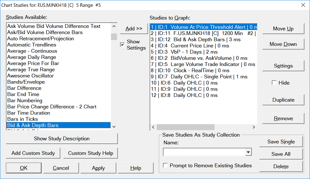

[2018-01-17 14:02:46]
YK - Posts: 33
8 intraday charts.
2 symbols JNKH18, NJNKH8 at CQG.
All studies in attached file.
3 Volume at price.
imagestudy.png / V - Attached On 2018-01-17 14:00:49 UTC - Size: 51.09 KB - 543 views
[2018-01-17 22:34:01]
Attach the Chartbook you are using the following these instructions here:
And tell us the particular Chart Number you are replaying. The chart number is at the top of the chart.
