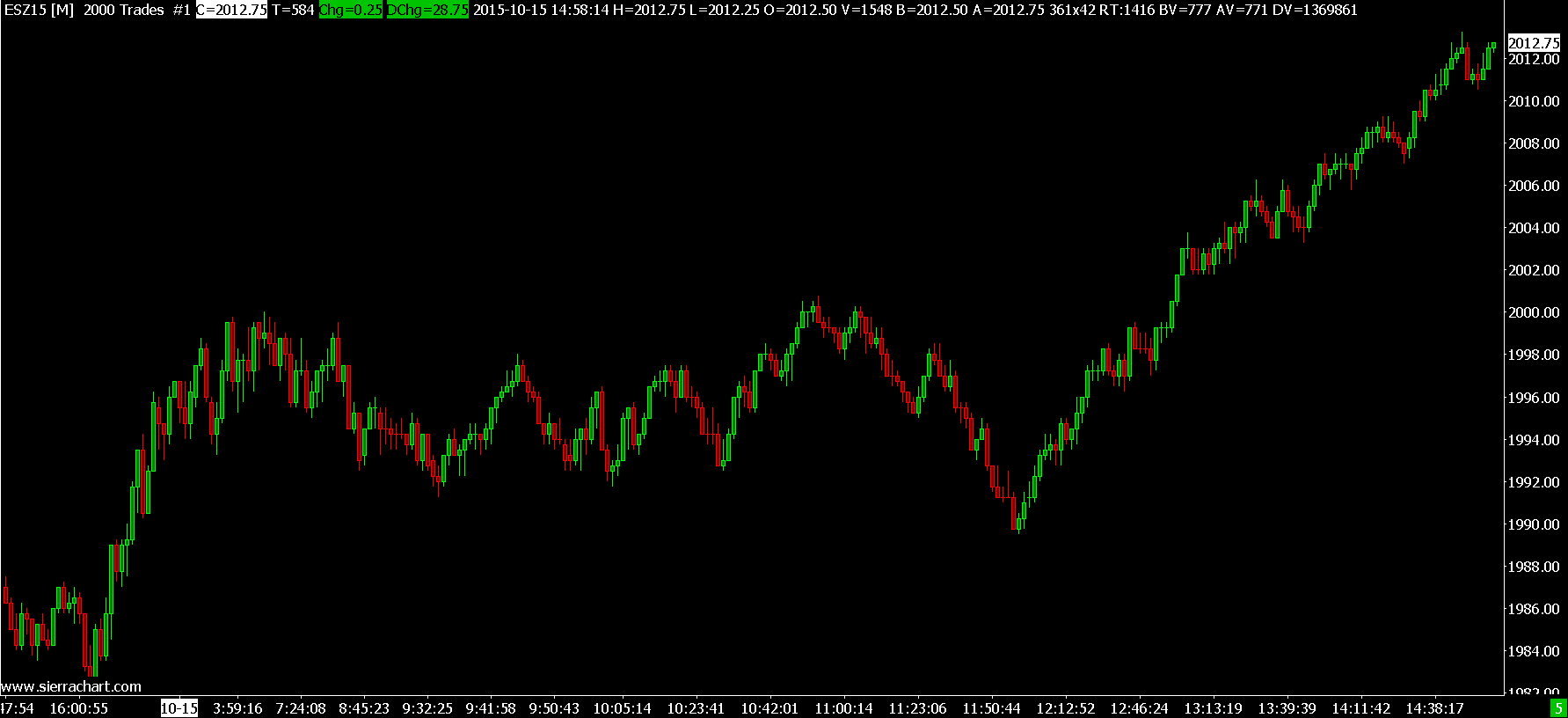

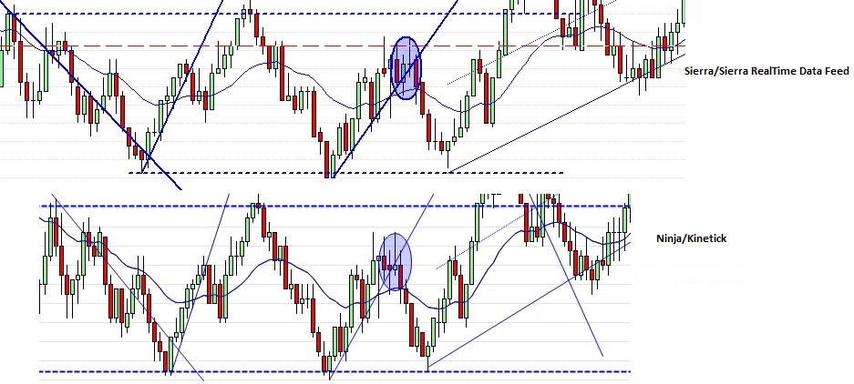

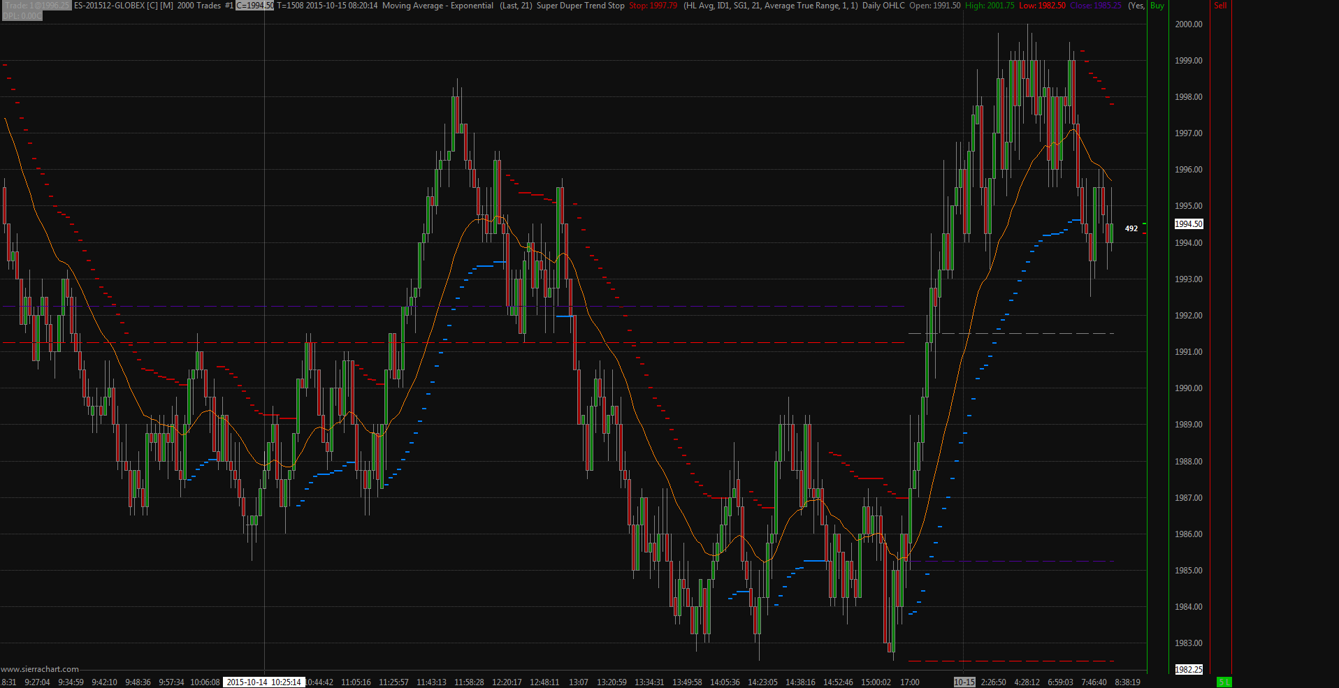

No I am not Using IB data and I have the M at the top of the chart.
Look at an example of a good signal bar when sierra live but when later I redownloaded the data I had the same bars as the below pic of Kinetick. I mean kinetick had printed it as doji real time and in sierra once i deleted and redownloaded then it changed as of kinetick.
The Instrument is ES with 2000 tick.
Date Time Of Last Edit: 2015-10-14 17:50:29
imageNinjavsSierra.jpg / V - Attached On 2015-10-14 17:45:14 UTC - Size: 140.03 KB - 625 views

You cannot make the kind of comparison you are. Charts based upon number of trades per bar inherently will look different between services and software due to different Session Times and/or the starting time at the beginning of the chart.
Everywhere we look, we see differences which means there is a problem with the starting time for the chart bars.
The Sierra Chart Exchange Data feed is fine. There is no doubt about that whatsoever. Anyone else using the data feed is welcome to comment on that. There is another explanation here.
We will not accept the analysis that you are doing because it is not a trustworthy and reliable method.
Open a chart for the ES market and set the chart bars to 5 minutes per bar and verify you see the [M] after the symbol. Add the Volume study. Let the chart run in real-time for about 10 minutes and then re-download the last 10 minutes of data. Do you notice a change with the OHLC values or the Volume?

On the 5 minute chart everything is excellent. As far as the session Time I am trading more than 6 years and I know How I have set up my charts even with the new CME sessions.
I am trading the ES right now and I will try to capture an image of real time and redownloading. The differences are small but small in trading is the line in the sand between loss or win.

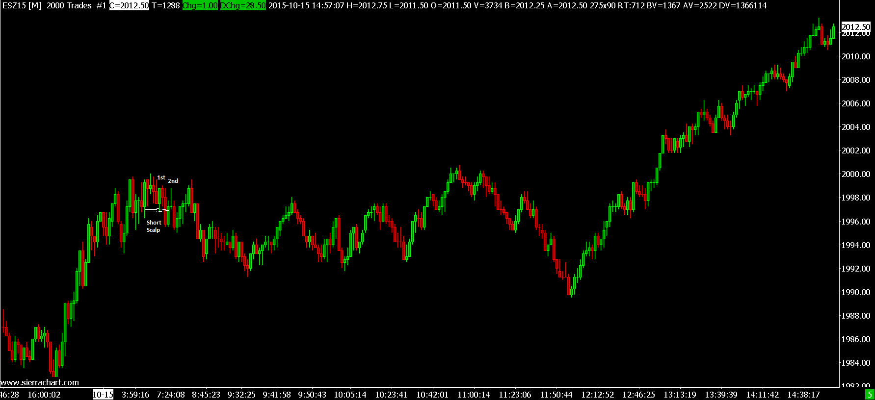

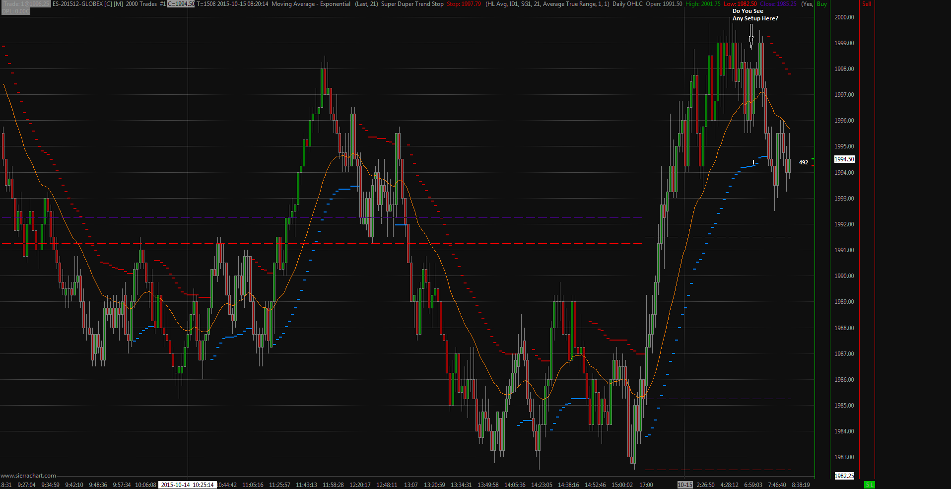

JRA - Posts: 97
ok here it is for example. I market with an eclipse the bar after deleting and redownloading
Date Time Of Last Edit: 2015-10-14 18:31:56

[2015-10-14 19:01:46]
The data feed is fine. That is validated with what you saw on the 5 minute chart.
What we suspect the problem is has to do with the transition from real-time data to historical data and back to real-time data. We are making sure there is no data loss with this.
If there is a problem with this, then actually you are introducing less accurate bars when you re-download the data. The real-time bars are accurate.

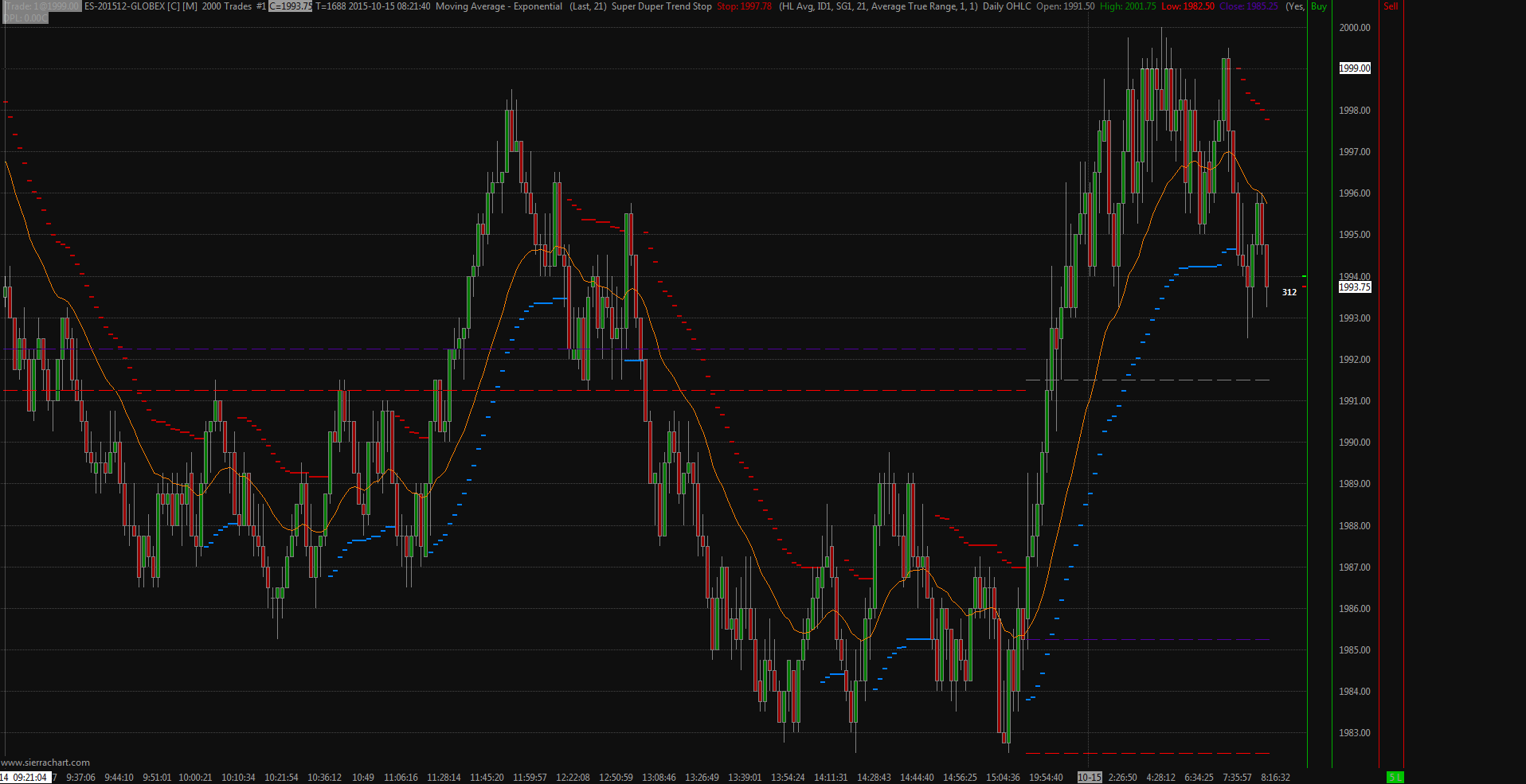

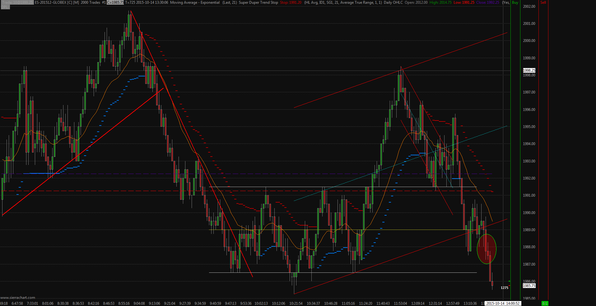

And here is an example of today ES
Before Deleting and After
Look at around 06:59 the bars
If you count the high attemps from the high swing in the after pict, its a failed second entry long, which makes it a short.
But on the before (live Pic) I can't count.
Date Time Of Last Edit: 2015-10-15 13:27:09

A new release is not going to help this problem. There is something else wrong. And there is also nothing wrong with the data feed.
In all of your instances of Sierra Chart, go to Global Settings >> General Settings.
What is the Data Files Folder set to for each of them?
It appears you are sharing a data folder. This is something we have made very clear must not be done at step 15 here:
https://www.sierrachart.com/index.php?page=doc/MultipleServices.html#Sharing

Based on all of our experience we are quite certain this is on the network switch side that Barchart controls and there really is little we can do about it. We will let them know about it again though.
Since we do not want any further complaints, you may want to discontinue the use of the Sierra Chart Exchange Data feed and use IQ Feed. The problem is not within our control.
Although the packet loss is very low and not generally noticeable, because your methods are extremely sensitive to any differences, even just a few trades, we will not be able to help you because the problem is not within our control.
However, part of the problem though is that when you were re-downloading the data, there was an issue where there was some loss from the transition of historical data to real-time data. So the re-downloading brought out a problem when there may not have been one to begin with. We solved that problem for you.
Since Barchart changed a network switch, the packet loss we have seen has been very very small but it does occur in tiny quantities. And with the sensitive method you have, you will see small differences when you re-download data depending upon which server the data comes from.
A question that comes in my mind in order to keep my sanity for whether I was right or wrong is Why after 17 post did the data feed send me the data as it should on Friday 16th?
Regarding Friday, our understanding is that you are running the latest version which handles transitions from historical data to real-time data without any subsecond data loss and the market activity was low on Friday and there was virtually no loss to the servers.
Date Time Of Last Edit: 2015-10-20 03:18:44
[2015-10-20 02:58:50]
Message to Barchart:
Today we noticed a significant amount of packet loss on server A. Here is an example:
2015-10-19 10:18:12 | CME:C(310) PerfCnt: Lost Packets = 267 / 567142 (0.047) Feed A Dr/Rx = 658 / 566484 (0.116) Feed B Dr/Rx = 668 / 566474 (0.118) A/B/SS MaxQ: 277 / 278 / 4 MaxRdy: 33052 / 33052 / 2694 SShot Dr/Rx = 6 / 203908 (0.003)
2015-10-19 10:18:12 | CME:C(318) PerfCnt: Lost Packets = 266 / 740686 (0.036) Feed A Dr/Rx = 634 / 740052 (0.086) Feed B Dr/Rx = 617 / 740069 (0.083) A/B/SS MaxQ: 368 / 365 / 5 MaxRdy: 20952 / 20952 / 4742 SShot Dr/Rx = 3 / 203799 (0.001)
We did not see the same packet loss on server B.
Based on past experience and the recent changes we have made to improve data processing, we do believe the cause is external to the server. I checked the network adapter on server A and the incoming data rate is the same amount compared to server B which did not experience this loss.
I am hesitant to keep bothering you about this, but our users do notice even a small amount of loss, and point it out to us. Today I told one user just to cancel the service because I do not want to hear their complaints anymore.
We do genuinely believe the cause is external to the server based on all of our experience with this kind of problem. We are nearly 100% certain of that. We did notice a significant amount of loss several months ago and it did appear to be an external problem, but some tests we did were not proving that but then when Barchart changed a network switch that they saw was faulty, it went away completely.
One thing would like to point out though is that packet loss in the range of: Lost Packets = 267 / 567142 (0.047%) is not crap and is considered within the range of acceptable. This is one reason we do not want to keep bothering Barchart about this .
Date Time Of Last Edit: 2015-10-20 03:20:52
[2015-10-20 03:38:53]
One other final note, you should consider very carefully whether you want to use IQ Feed because the known problems are that you will have limitations with the downloading of tick by tick data, downloading is a lot slower, and sometimes there are time stamping problems.
[2015-10-20 06:25:46]
JRA - Posts: 97
Thank You!!
[2015-10-20 06:46:05]
One additional thing before you consider moving to IQ Feed which is perfectly fine if you do.
We are going to do some reconfiguration on our servers, which will bring about a complete consistency with the historical and real-time data across both servers. This should be deployed within the next 30 days. This will completely eliminate the very minor differences that you see when re-downloading data assuming that you still see them.
Date Time Of Last Edit: 2015-10-20 06:46:34
[2015-10-20 06:57:40]
JRA - Posts: 97
Pls, keep me updated when you will implement this.
As a side note, I was running yesterday IqFeed with Sierra and Ninja, and I was amazed with the speed Sierra kept up with IQfeed and Ninja Failed, I had to relload all history with ninja to keep up real time with sierra.(Minor difference about 1 tick of where the bar closed or opened, but sierra kept all the session the precision from IQFeed). Kudos for your work on that platform is by far the best platform out there.
[2015-10-20 07:26:46]
When it comes to speed of the CME feed, we do not see how IQ Feed can beat what we offer.
We have the lowest latency CME connectivity you will get with a standard Internet connection.
