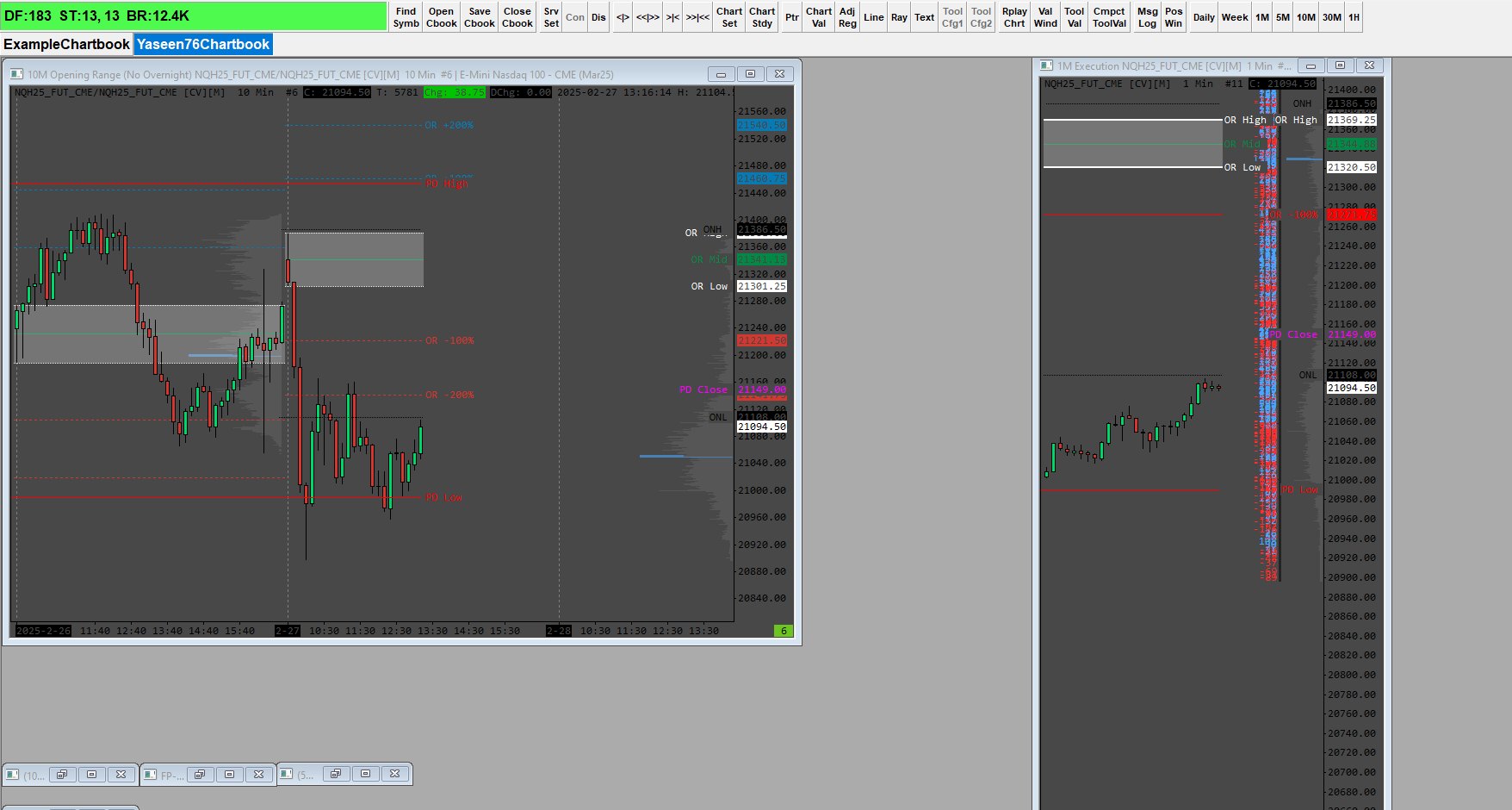

I have spent hours trying to get my charts to load properly but it just stays stuck on downloading historical data and the message log just fills up. I have tried all the troubleshooting that the forum suggests but cant get any movement. Thank you
imageScreenshot 2025-02-24 195224.png / V - Attached On 2025-02-25 11:37:12 UTC - Size: 62.54 KB - 167 views

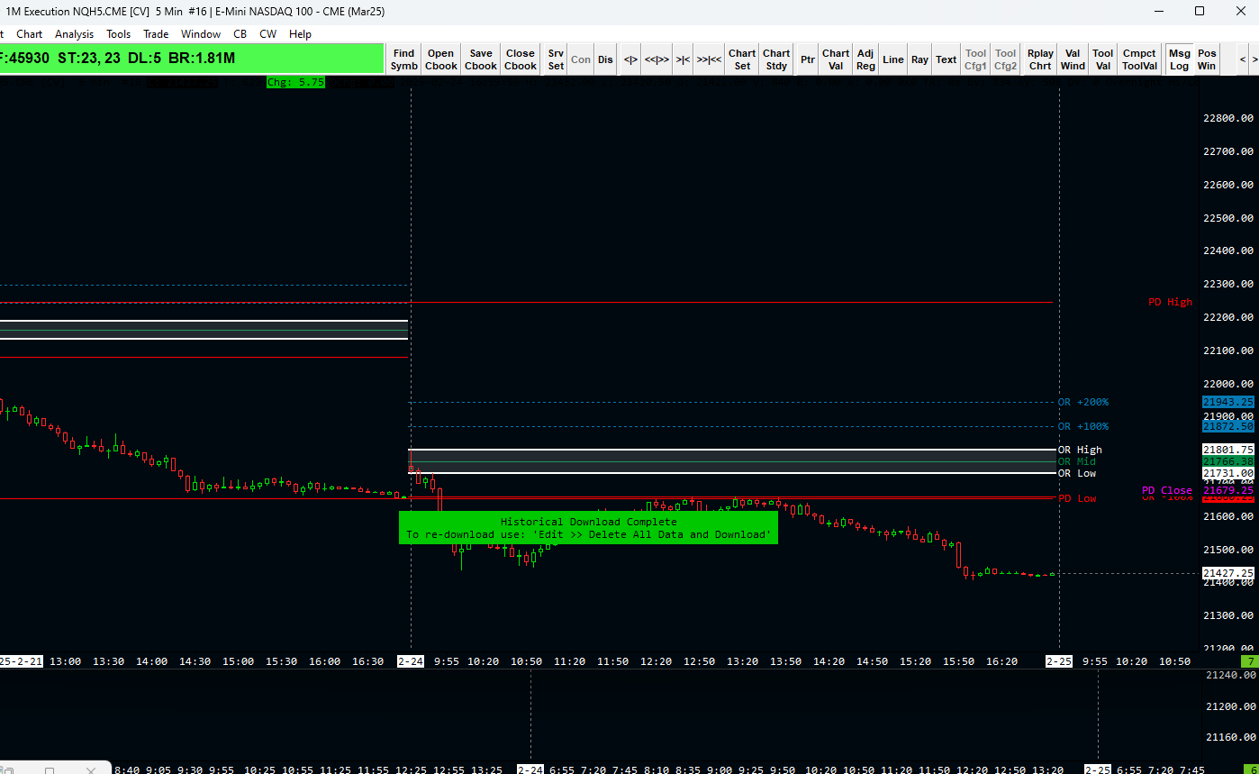

msiev72 - Posts: 10
following up. I took your advice and funded an account with Stage five. I have logged in with the new credentials. it loaded my chartbook but the charts are just static from when i opened the chartbook. The pricing is not moving at all. Any ideas on how to fix this?
imageScreenshot 2025-02-27 102846.png / V - Attached On 2025-02-27 18:38:28 UTC - Size: 133.8 KB - 219 views
[2025-02-27 21:07:15]
John - SC Support - Posts: 48095
Everything on your account looks good, so you should be getting the data for instruments traded on the CME exchange.
Note that the image is not helpful as we do not know when the image was taken relative to the bars.
If you are still having an issue with this, then please get us your Message Log by following these instructions:
