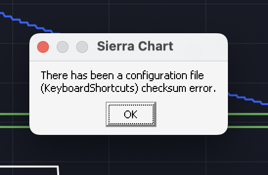

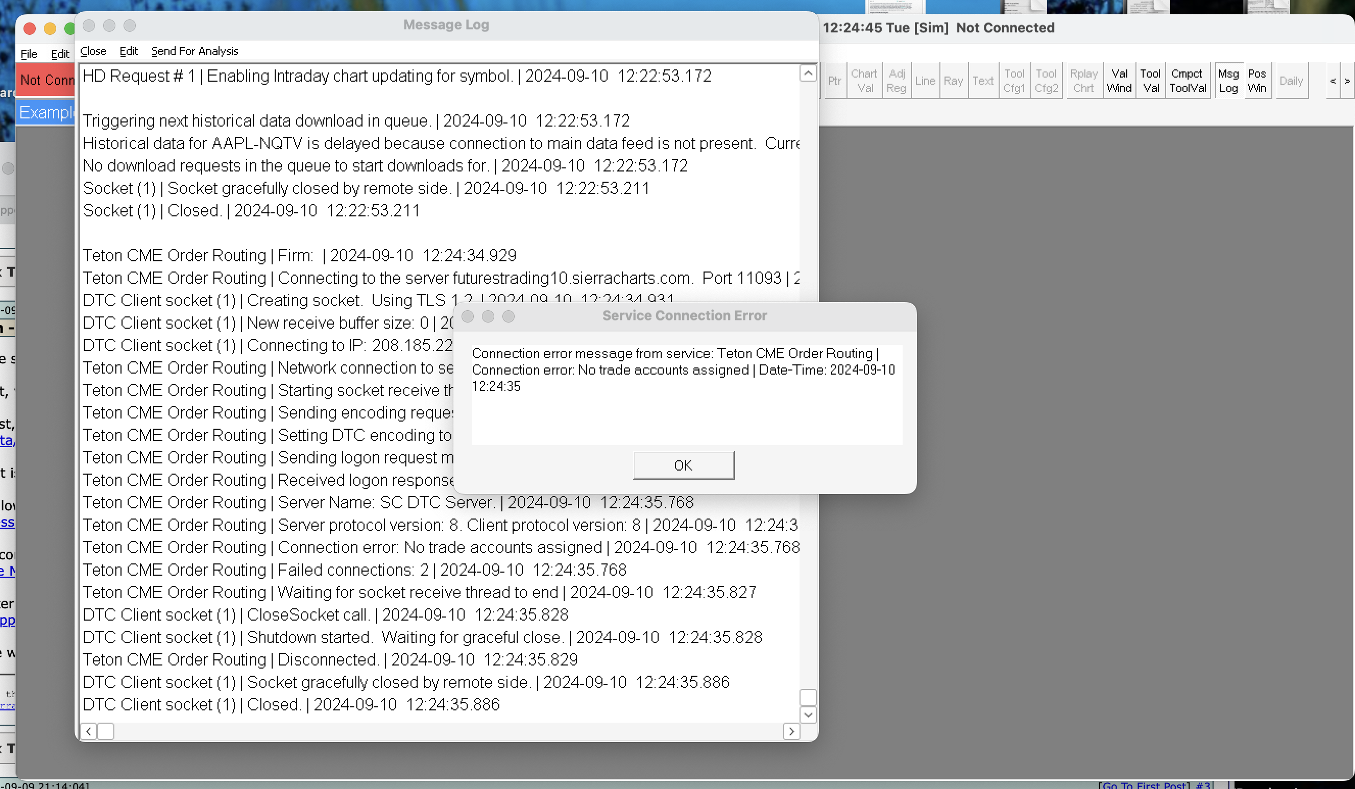

When I navigate to "File" --> "Connect to Data Feed" then I get an error window (images attached) of no trade account assigned.
Might this be if my payments have not processed thru the Sierra system yet or otherwise?
What would lead to these error windows to appear with screenshots attached? How can I see the data loading for the indices selected to view, rather than the window appearing saying "not connected, no trade account connected"?

imagesierra.checksum.error.png / V - Attached On 2024-09-10 12:32:54 UTC - Size: 112.97 KB - 284 views
imagesierra.no.account.error.png / V - Attached On 2024-09-10 12:33:04 UTC - Size: 754.59 KB - 239 views

With regards to the Checksum error, which is very unusual, you will need to remove the following files from your system. Any custom keyboard shortcuts that you had created will be gone and you will need to redo them. Please make sure to exit from Sierra Chart before removing these files:
- KeyboardShortcuts.config
- KeyboardShortcuts4.config
You may only have KeyboardShortcuts4.config, which is fine - just remove that one if this is the case.
With regards to the "No Trade Accounts Assigned", this means that you are trying to connect to the "Teton CME Order Routing", but the Clearing Firm you have selected has not setup your account yet, or you are not selecting the correct Clearing Firm.
What broker/clearing firm are you using for the Teton Order Routing?

The first thing that you must do, and is absolutely mandatory, is update Sierra Chart to the current version:
After that, you need to set the Clearing Firm. Follow the instructions 7 through 9 here:
Sierra Chart Teton Futures Order Routing: Setup Instructions
Date Time Of Last Edit: 2024-09-11 12:11:58
[2024-09-11 12:21:06]
User705490 - Posts: 17
Thank you - steps 7-9, specifically connecting to the broker Ironbeam again helped. Not sure how this was undone and it needed to be connected to the broker again. Thank you for this clarity.
