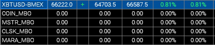

"If I click" means clicking on a watchlist (quote board). so as I move between ????_MBO symbols all is well, but since the regex works there, then I get whatever ???? was carried over as the symbol from ibkr. and that is causing a re-download of the entire data for that symbol, hence the long download time. my connection is not so slow.
I want to see in my watchlist, for example the following:
XBTUSD-BMEX
MSTR_MBO
COIN_MBO
MARA_MBO
and hop between them while being able to trade the ????_MBO ones on IBKR.

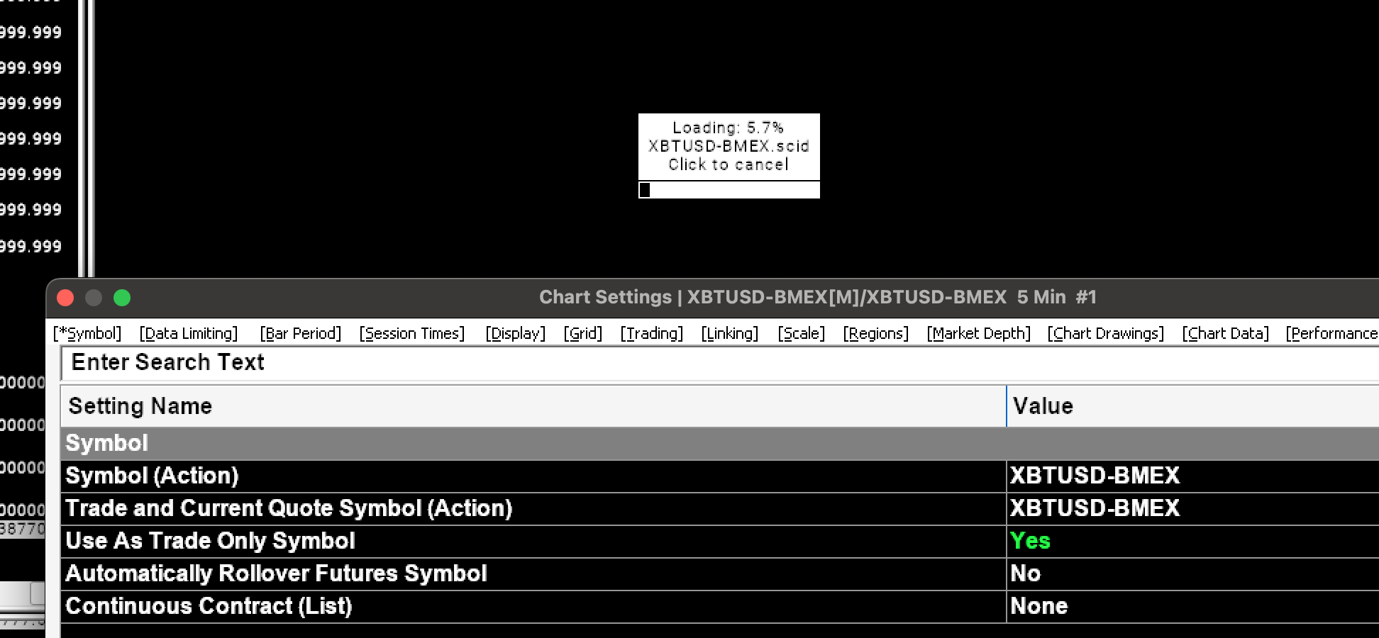

[2024-04-10 16:02:16]
Make sure the option for "Use As Trade Only Symbol" is set to "Yes". Otherwise, the system would be trying to get data from Interactive Brokers. Refer to the following:
Chart Settings: Use as Trade Only Symbol (Chart >> Chart Settings >> Symbol >> Symbol menu)
We can not think of any other reason why the data load times would be different.
[2024-04-11 07:40:46]
Omri - Posts: 15
still takes a lot of time to load.
SC Data - works fine
Interactive Brokers - takes a lot of time and does not update.

Omri - Posts: 15
As for the first suggestion, please see my screenshot, but what I essentially need BTC for is to assist trade decisions in the stock market for COIN and MSTR for example.
As for the speed - it works very fast. unless I open up the IBKR connection. please see previous correspondence in this thread. it is simply slow. if you click a stock and then get back to BTC you have to wait a few minutes. not so when you are only connected to SC Data.
