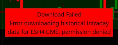

[2024-02-23 14:22:21]
User497465 - Posts: 42
yesterday all worked very well.
but today my downloading of the historical intraday data doesn't work
imagedownload failed.jpg / V - Attached On 2024-02-23 14:21:08 UTC - Size: 17.75 KB - 243 views
[2024-02-23 14:23:04]
for all markets. ES is only an example

[2024-02-23 16:52:20]
John - SC Support - Posts: 47955
Using our Denali Exchange Data Feed is our recommended solution. You can use the Denali Exchange Data Feed with your Prop Firm.
But, to do this, you need to have a live, funded, futures trading account in order to qualify for the non-professional exchange fees - and you need to be able to connect to that account at least once a month with your Sierra Chart software. Refer to the following regarding this:
Real-Time Exchange Data Feeds Available From Sierra Chart: Understanding and Accessing Data From the CME, CBOT, NYMEX, COMEX Exchanges
If you do not have an account that will qualify for the above, then we recommend the solution outlined at the following link:
Easy Solution to CME Funded Trading Account Requirement
Once you work out the above, then to setup the Denali Exchange Data Feed for The CME Group, follow these instructions:
Once you have the above setup, then be sure to remove the entries for the Username/Password for the "Market Data" and "Historical Data" on the "Global Settings >> Data/Trade Service Settings >> Main Settings" for Rithmic. This can help with alleviating the "Permission Denied" error.
