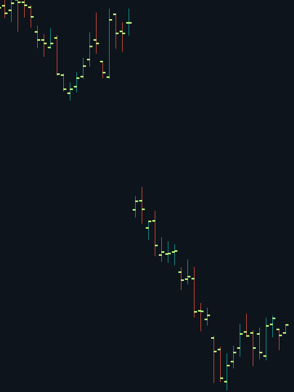

Let's walk through what led to this issue. I rolled NG forward to the G contract from the F contract. And there was a 19 day gap in the Daily Historical DATA. Thinking I need ver. 2561 for historical I updated only to find that the sub-instance won't boot. Upon further reflection if that was the issue than I should not have any historical data. Perhaps there's something else happening here. I've enclosed two screen shots one with the F contract with no issues and the other the G contract with the missing DATA.
imageice_screenshot_20231226-214846.png / V - Attached On 2023-12-27 02:55:16 UTC - Size: 3.56 KB - 206 views
imageice_screenshot_20231226-214800.png / V - Attached On 2023-12-27 02:55:27 UTC - Size: 2.52 KB - 225 views

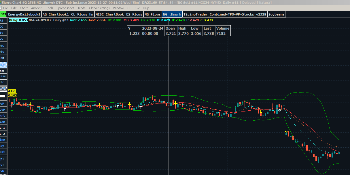

imageice_screenshot_20231226-235502.png / V - Attached On 2023-12-27 04:57:37 UTC - Size: 4.84 KB - 251 views
imageice_screenshot_20231227-001102.png / V - Attached On 2023-12-27 05:11:42 UTC - Size: 46.87 KB - 177 views

Is there a reason you are not viewing the posted Screen Shot of NG-G24-nymex. The missing Data is from approx 11-03-2023 to 11-22-2023
from the support ticket above"I rolled NG forward to the G contract from the F contract. And there was a 19 day gap in the Daily Historical DATA."
Again this gap in the DATA is uniform across all versions

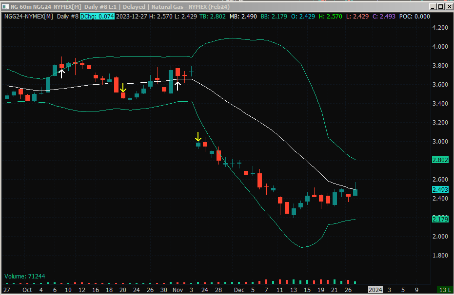

Lastly a SS of the NG-G24-nymex chart ver 2568 of SC
A reminder this began when I simply rolled from the NGF24 to NGG24 nymex contract
Date Time Of Last Edit: 2023-12-27 17:40:59
imageice_screenshot_20231227-121948.png / V - Attached On 2023-12-27 17:32:19 UTC - Size: 6.25 KB - 196 views
imageice_screenshot_20231227-120724.png / V - Attached On 2023-12-27 17:37:54 UTC - Size: 37.87 KB - 179 views
