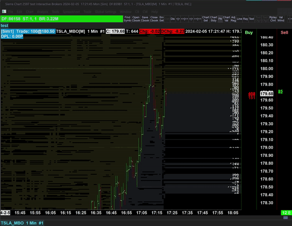

| [2024-02-05 17:25:33] |
| methodtrades - Posts: 48 |
Issue is still occurring in 2597, although a bit different as you can see in the attached GIF. Other levels seem to flash on and off when they are changed.
| [2024-02-06 01:37:26] |
| Sierra_Chart Engineering - Posts: 25070 |
We do not see how we would be able to reproduce that. We do not know what the problem is in your particular case. However, we want you to disable Custom Symbol Settings Values: Global Symbol Settings: Disabling Custom Symbol Settings This is very important to do the above step! If you still have a problem we do not know what the cause is and for whatever reason you cannot use _MBO symbols with Interactive Brokers. And need to use a separate installation of Sierra Chart set to SC Data-All Services. Sierra Chart Support - Engineering Level Your definitive source for support. Other responses are from users. Try to keep your questions brief and to the point. Be aware of support policy: https://www.sierrachart.com/index.php?l=PostingInformation.php#GeneralInformation For the most reliable, advanced, and zero cost futures order routing, use the Teton service: Sierra Chart Teton Futures Order Routing Date Time Of Last Edit: 2024-02-06 01:38:47
