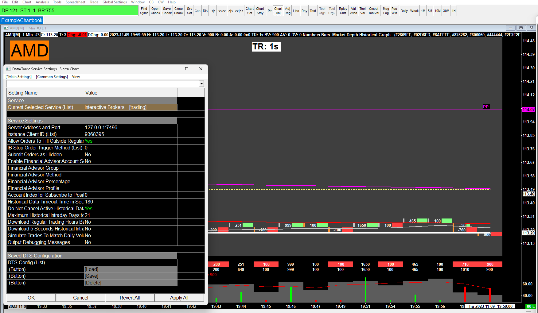

Hi! so im subbed for integrated services and consolidated tape plus nasdaq totalview. i still only can see historycal data not live. i changed my data settings from SC data to IB and connected my IB account (it says im connected) and i still can see delayed data. what went wrong?
[2023-11-10 07:05:51]
Close all of the Chartbooks with "File >> Close All Chartbooks".
Open a single chart for the symbol you have an issue with through "File >> Find Symbol". Tell us that symbol of the chart. Tell us about *one* symbol only.
[2023-11-10 07:30:55]
User962106 - Posts: 19
here you can see my settings IB connected. i dont want to trade on sierra only see the live data on my chart.
please try to help/solve before market opens its asap
thanks
Date Time Of Last Edit: 2023-11-10 07:31:25
imageddd.png / V - Attached On 2023-11-10 07:30:40 UTC - Size: 136.58 KB - 259 views
[2023-11-10 07:59:11]
In this case follow these instructions:
To access historical and streaming market data independent from your Trading service. Follow these instructions.
Set "Global Settings >> Data/Trade Service Settings >> Current Selected Service" to "SC Data-All Services".
Press "OK"
And then translate the symbols in your Chartbooks and Sierra Chart using this "Edit' menu command:
Edit Menu: Edit >> Translate Symbols To Current Service (Translate Symbols to Current Service)
You can then use the data provided by Sierra Chart independent of your trading service.
Use the same symbol, which in this case is AMD.
If you want market depth then use the symbol AMD-NQTV
You can use both at the same time.

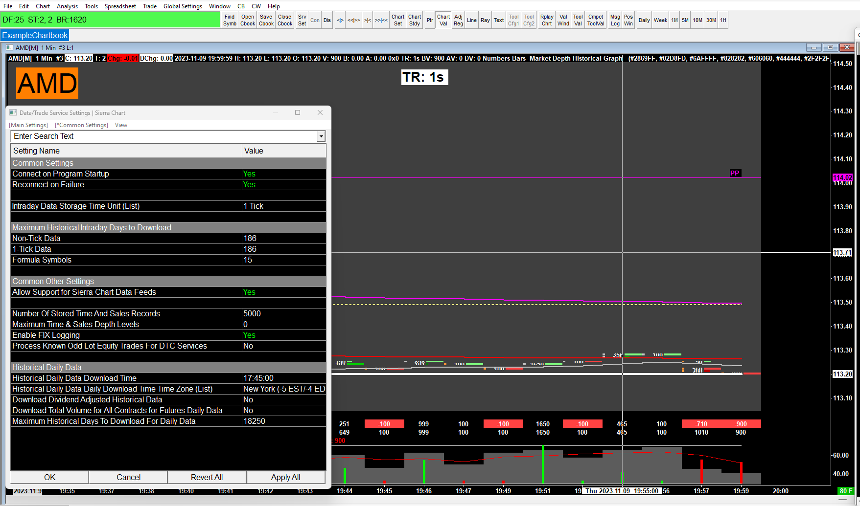

[2023-11-10 08:12:10]
set to SC data as you can see on the pic but its the same. its now 03:10 am in new york and the last data on chart is 19:10.
so streamin still doesnt work
imageFFF.png / V - Attached On 2023-11-10 08:11:38 UTC - Size: 129.94 KB - 194 views
[2023-11-10 14:39:22]
Are you still having an issue. The market was closed at the time.
Make sure the Time Zone for that chart is set to US Eastern Time:
Time Zone Setting: Using Different Time Zone in Individual Charts
Date Time Of Last Edit: 2023-11-10 14:39:46
[2023-11-10 23:37:30]
no, if there is volume it works fine thank you!
