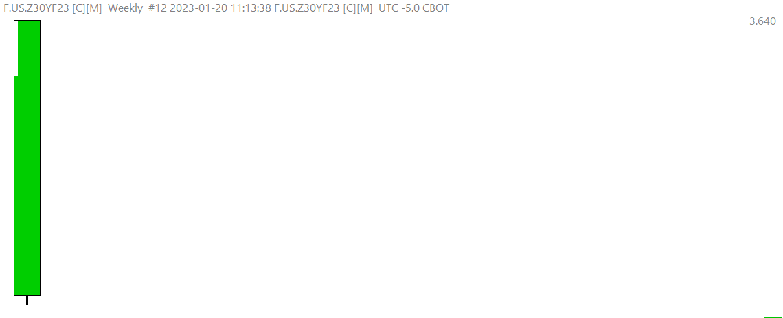

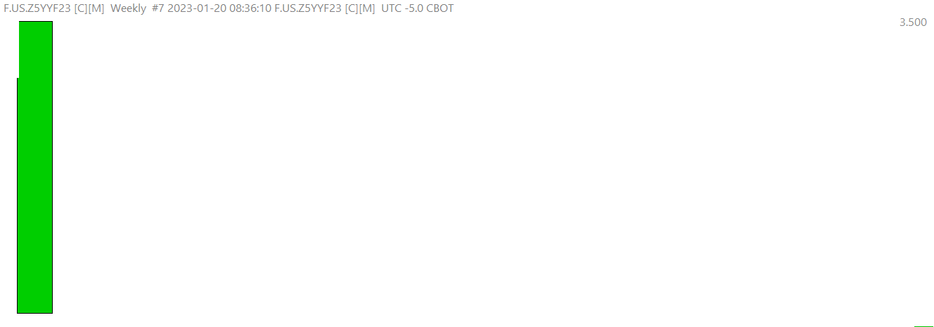

| User871209 - Posts: 99 |
Thanks for your reply, I followed the procedure to the end and it showing about 6 candles more but that is it. Shows after process: Weekly Candles 13 Daily Candles 59 https://www.sierrachart.com/image.php?Image=1674236381502.png In settings/symbol / continuous contract I have selected Conitnunous futures contract - date rule rollover. What else can I do to be able to get at least a full chart worth of candles? The same process for done for F.US.Z5YYF23 + F.US.Z30YF23 does not help at all here, showing one candle only: https://www.sierrachart.com/image.php?Image=1674236782764.png https://www.sierrachart.com/image.php?Image=1674236799123.png Once again thank you. Regards, Date Time Of Last Edit: 2023-01-20 17:46:53

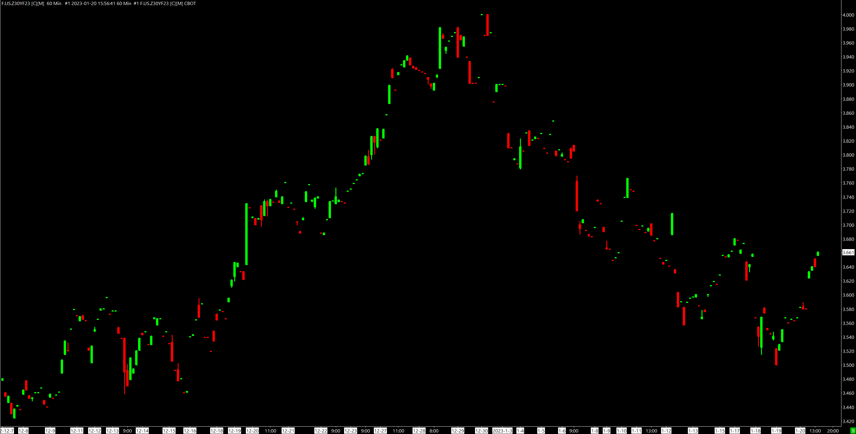

John, I re-ran the procedure as you mentioned and it still for some reason doesn't work, I try to run all other charts from this group of Micro CBOT but same deal. The Daily of Weekly candle comes out only 1 and in the 60 minutes, it is not finalized data. https://www.sierrachart.com/image.php?Image=1674253295536.png No idea what could be the issue, I have the other 10 charts open without from Nymex, CME, Comex, etc, and no issues there. |

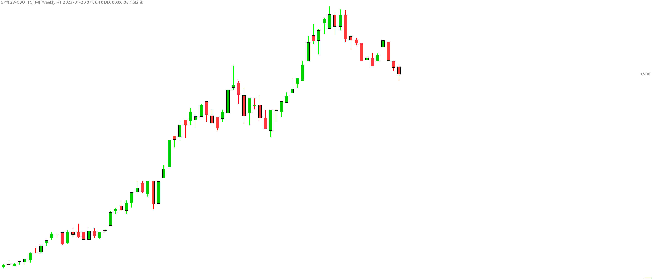

| Sierra_Chart Engineering - Posts: 25039 |
What is wrong with this chart?: https://www.sierrachart.com/image.php?Image=1674253295536.png Before taking our time first contact the exchange and do not ask us. It is their data. There is nothing wrong with it. And we would not use weekly with these micro yield symbols, these are relatively new contracts, and there is not much history. This is an example what we see for a continuous daily chart contract chart: https://www.sierrachart.com/image.php?Image=1674442543753.png However, this is what we see for weekly: https://www.sierrachart.com/image.php?Image=167444258315.png Sierra Chart Support - Engineering Level Your definitive source for support. Other responses are from users. Try to keep your questions brief and to the point. Be aware of support policy: https://www.sierrachart.com/index.php?l=PostingInformation.php#GeneralInformation For the most reliable, advanced, and zero cost futures order routing, use the Teton service: Sierra Chart Teton Futures Order Routing Date Time Of Last Edit: 2023-01-23 02:57:52
