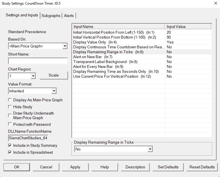

tick counter is the study countdown timer
i have attached a screenshot of the settings for the study
if i make changes to a chart-book in the main instance and want the same in the 2nd instance i.e. back-testing instance i will have to delete the entire instance or is there a way to copy the changed chart-book from main instance to the back-testing instance?

The countdown timer in this case could be different if the two charts have something different in their settings. For instance, if the Session Times are different or if the option for New Bar at Session Start is different between the two charts. Since this is a Number of Trades chart, it could also be a difference in the setting for Combine Trades into Original Summary Trade.
The first thing to do is to ensure the settings are the same between the charts.

The settings were same between charts, i guess i just needed to close the platform and restart it and the problem got solved :)
The problem would have most likely been to what is explained at step 2 here:
Working With Charts: Resolving Differences of Chart Bars Between Charts
A restart was not needed.
