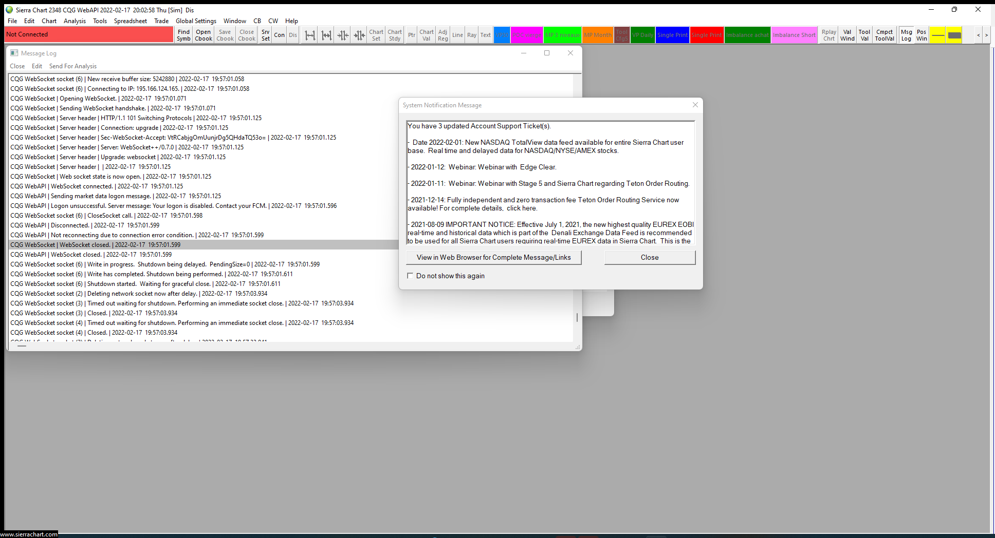

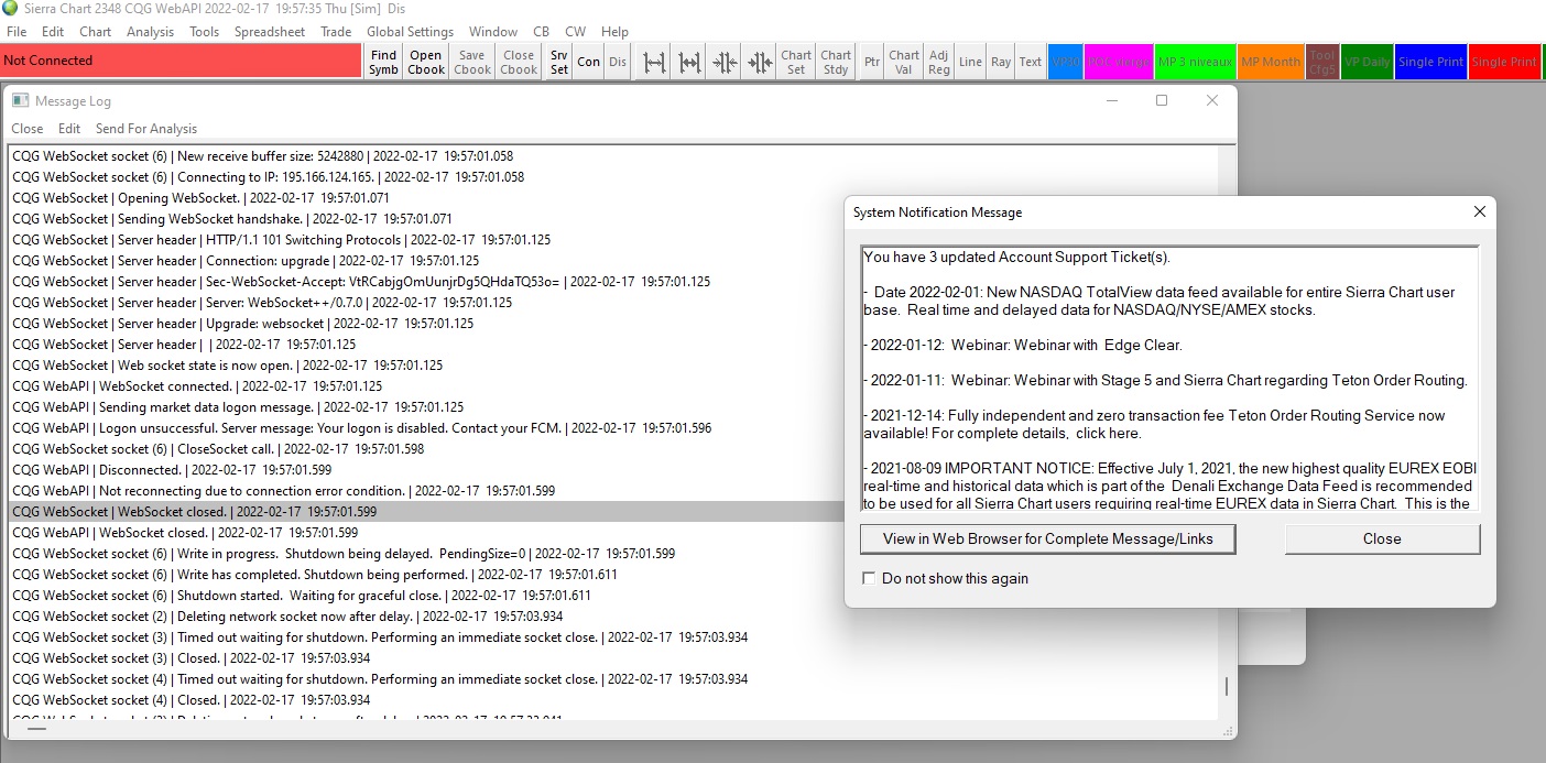

I can succed to connect Sierra Chart.
Please find below a screen print of my Sierra chart window
https://www.sierrachart.com/image.php?Image=1645128186220.png
Could you help so solve my connexion pb please?
regards

John - SC Support - Posts: 48356
The following line in your Message Log is what is important:
CQG WebAPI | Logon Unsuccessful. Server message: Your logon is disabled. Contact your FCM
As it states, your CQG login has been disabled for some reason. You need to contact your broker and ask them why this occurred.
