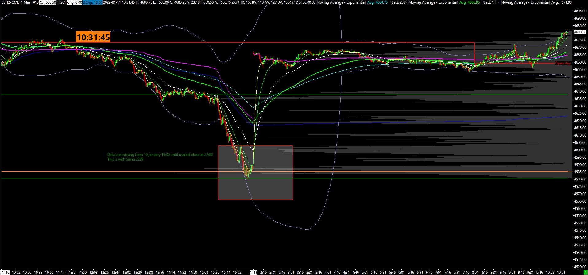

Dear Sierra Chart team,
I have been trying to update to the last sierra chart version ; However, I have noticed that I had to select "Rithmic DTC Trading" instead of rithmic trading. As a result, I can not download my historical data and look at chart properly. For instance, the date doesn't make any sense and i have to load chart from july 2021 to october 2021 which is not usable for me since i do not have access to recent data.
On the other hand, keeping the current version is also not an option (Sierra Chart 2299) since I am loosing the data from the most recent day. For example, I stopped trading yesterday at 4:30 PM CET and I can not access at data from yesterday after 4:30 CET. This is problematic for me and not an option as well. I have checked is this problematic happens wether i used Rithmic 16.55.1.0 or 17.3.1.0
imageESH2-CME 1 Min #13 2022-01-11 10_31_45.722.png / V - Attached On 2022-01-11 09:32:48 UTC - Size: 68.27 KB - 377 views
[2022-01-11 15:13:05]
Sierra Chart is no longer providing Sierra Chart historical data for the old Rithmic bridge connection. We did put out a notice about this through the System Notification Window.
