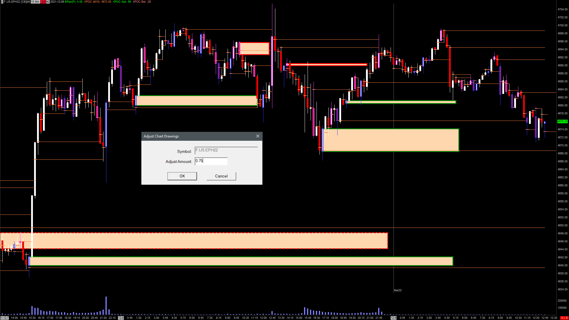

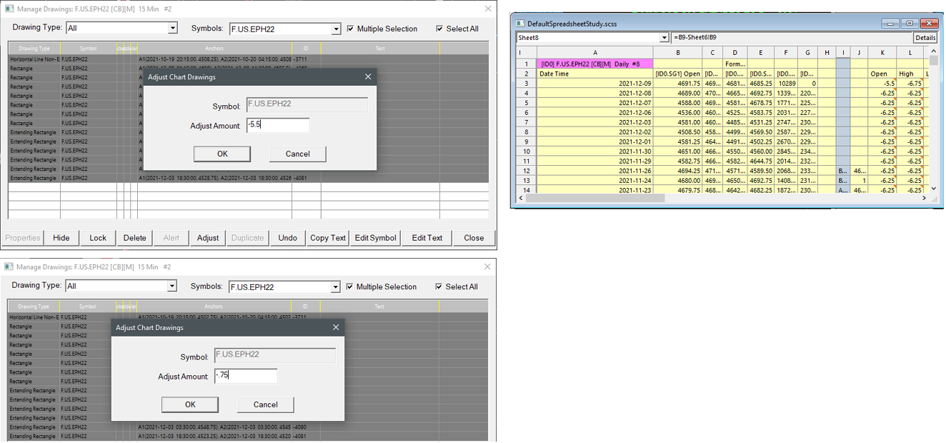

[2021-12-09 05:14:45]
nicktrader - Posts: 817
This morning I did the rollover for the ES. To adjust the levels, I determined the difference value.
The "historical" difference was -5.5. I used this value for the adjustment of the intraday charts, but unfortunately this value did not fit.
I had to adjust again by the value -0.75.
Why did the first value not fit. I think I did everything right by taking the difference for the historical value.
However, I am surprised that the difference value of the previous days would have fit.
Date Time Of Last Edit: 2021-12-09 05:17:34

[2021-12-09 11:38:00]
On Friday after the close of the market, all values were suddenly adjusted and the differences were ZERO.
This does not make sense.
There must be changing values in the historical daily data files, from the data provider causing this and changes with the price difference between contract months.
Pls see pic. I made on two different days a screenshot of the highlighted contract. I used a spreadsheet to collect the data. Datafeed: Denali...
mentioned time in screenshot = MEZ
Date Time Of Last Edit: 2021-12-09 12:02:27
imageES screenshots.png / V - Attached On 2021-12-09 11:37:35 UTC - Size: 23.41 KB - 390 views

[2021-12-10 04:49:23]
Pls see pic.
Today I have to adjust the levels again by the value of 0.75.
Yesterday, I initially had the "start value" of 5.5, but this value did not match the levels. I had to adjust the levels by another 0.75. The total value of 6.25 corresponded to the difference value of the previous days.
Today I have to readjust again by the value 0.75
imageES M15 Levels 211210.png / V - Attached On 2021-12-10 04:48:26 UTC - Size: 49.55 KB - 312 views

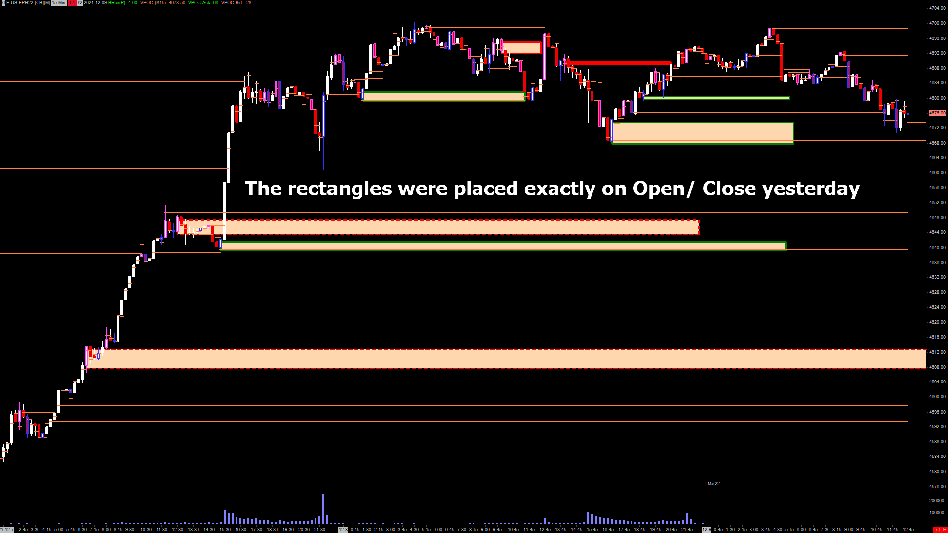

[2021-12-10 04:58:51]
post hoc...
imageES after adjustment 211210.png / V - Attached On 2021-12-10 04:58:24 UTC - Size: 52.2 KB - 377 views

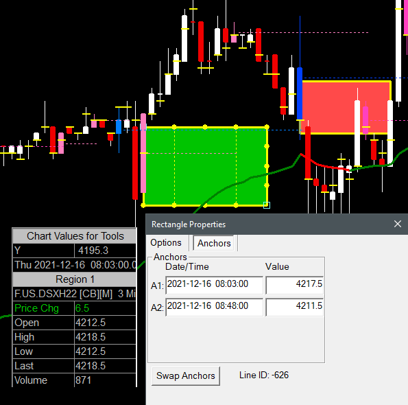

[2021-12-17 10:42:44]
I have done the rollover for FESX today. Every single step I tried to document.
I noticed that I have determined a different difference value which is different from your documentation. Therefore, I suspect that I have to make another adjustment tomorrow.
Why is today's value different from your documentation?
attachmentProcedure Rollover FESX (English).pdf - Attached On 2021-12-17 10:42:34 UTC - Size: 178.13 KB - 474 views
