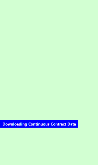

I made sure everything was done as you mentioned in your last post and now I no longer receive an error message. However, the quotes will still not stream and I still can't' get historical data to load. Remember, everything was fine with version 2253. The problems started when I updated to version 2326. Here is a screenshot...
http://www.sierrachart.com/image.php?Image=163665364869.png

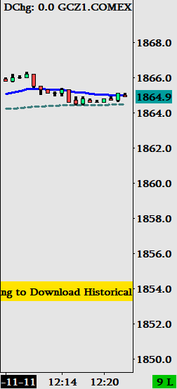

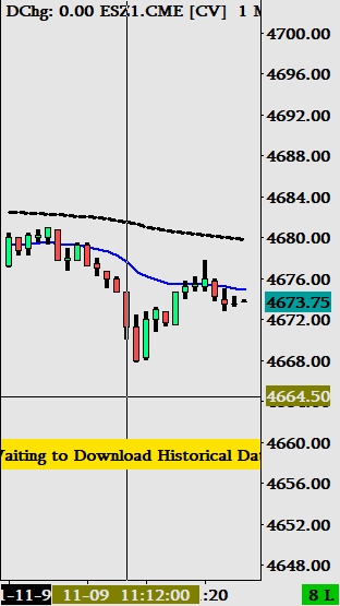

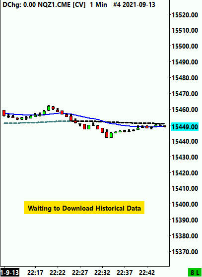

User357195 - Posts: 204
Here are more screenshots, SC John....
http://www.sierrachart.com/image.php?Image=1636654106909.png
http://www.sierrachart.com/image.php?Image=1636654131193.png
http://www.sierrachart.com/image.php?Image=1636654166591.png
