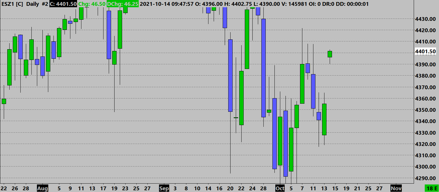

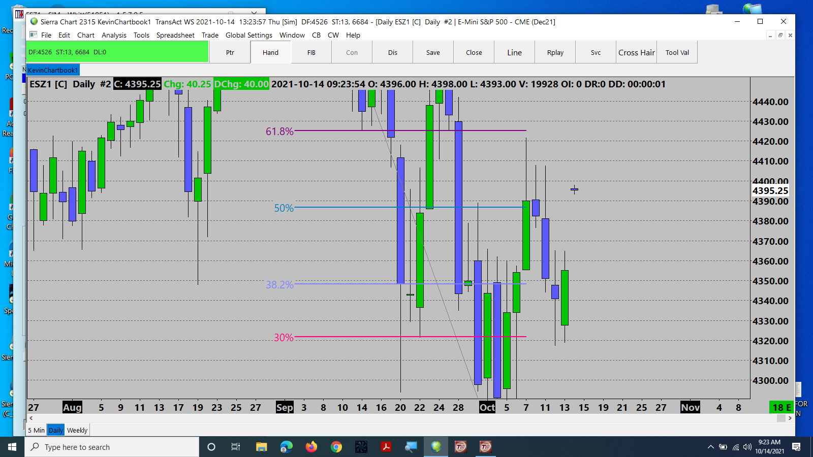

I use a 5 minute chart, daily continuous, and weekly continuous. The 5-min and weekly have no problems; the daily chart is showing a very small range on today's candle (actual range so far is 4354 - 4401.75). See chart here:
http://www.sierrachart.com/image.php?Image=1634219279550.png
I have clicked Edit > Delete all data and download more than once.
I have recreated the Daily chart more than once by first duplicating hte working charts and changing to daily.
The chart is still incorrect, although the it is reflecting price changes (it started as a horizontal line, then progressed to a doji, now reflects a small range).
Thanks in advance for your help.
imageSierra Daily.png / V - Attached On 2021-10-14 13:43:23 UTC - Size: 229.69 KB - 363 views

I checked with TransAct. This problem has occurred a few times in the past (when TransAct was providing Sierra Charts and support). TransAct told me to delete contract files with the .scid extension - I did that, which has always fixed this problem in the past, but it did not fix it this time. TransAct says this is a Sierra Chart problem, that they are getting NO complaints about data.
Yesterday was the beginning of this problem; today, yesterday's candle now has the correct information, but TODAY's candle is now incorrect. I tried the remedies above again today (in fact, I deleted ALL contract files so it would download everything fresh) - but today's candle is still incorrect -- like yesterday, today's candle does not reflect the overnight range for the S&P 500 e-mini, but it updates with the fresh data going forward. And, like yesterday, the TransAct DOM DOES reflect the correct data, as do my 5-min and weekly charts.

I then found this in your help pages: "Current Bar Not Updating in a Historical Chart" (No Historical Chart or Blank Chart | Historical Chart Not Updating | Missing Historical Chart Data: 6.2: Current Bar Not Updating in a Historical Chart) - I followed the instructions. There IS data reflected under Window >> Current Quote Window, but the data is incorrect. Suggestions from this section made no difference.
I right-clicked on the Daily Chart, selected "Edit/Download Data" and corrected the price range for the most recent candle (in this case, today's candle), after which the chart automatically redownloaded the data - the price on the candle once again started over with no data, and filled in as prices evolved, as it does every time I redownload the data.
