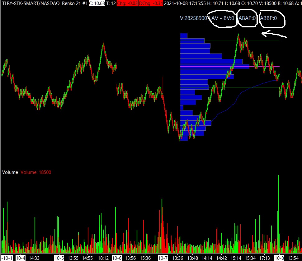

Hello! My problem with the volume was solved, I figured out the correct spelling of the ticker, but I found that the volume profile shows only the volume but does not show the direction of transactions. The volume profile does not see what buy or sell trades were. Why is this happening? Figure below.

The only thing we can say is that it is what the data feed is sending. We can not help with the data from Interactive Brokers.
To ensure that you get the best data, we recommend using the Sierra Chart data feeds. Refer to the following:
Real-Time Exchange Data Feeds Available From Sierra Chart
We are working on a new interface for NASDAQ data to have market depth with the U.S. Equities data. This should be available in a few months. Refer to the status of this project in the following thread:
Upcoming Data Feed Plans 2, New Exchange

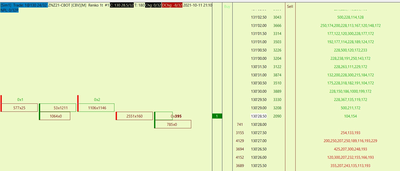

I am using package 12, data with latency (15 minutes), including MOC, exchange tools CME. I understand that this data comes from the data feed of the exchange denali. Or is it not so? Figure below. I have not yet configured real-time data connection subscriptions.
I have a question. Can I receive data for stock exchange shares without a subscription with a 15-minute delay?
imagequestion to sch 4.jpg / V - Attached On 2021-10-11 18:26:20 UTC - Size: 148.94 KB - 359 views
[2021-10-12 14:42:51]
Ok, we understand now. We did not think about the MBO data for the delayed feed.
Yes, the MBO and delayed data is part of the Denali feed, although you can get the delayed data with any package, but not the MBO data.
The stock data is available as historical data that updates at most every 20 minutes and is within 15 minutes of the current time. But it is not streaming data like the delayed Denali data. Refer to the following:
Sierra Chart Historical Data Service
