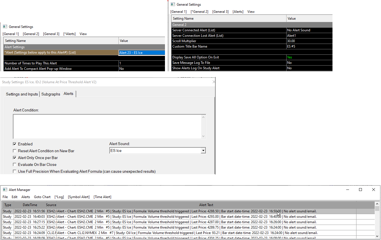

User350416 - Posts: 43
I have the same issue and can't get the Alert Manager window to stop popping out even if I select not to :
- Add alert to compact alert window
- Show alerts on study alert
Please refer to the attached settings screenshot
I'm using sierra chart version 2353
Please let me know what to do
Thank you

[2022-02-23 19:09:35]
On the Volume at Price Threshold Alert V2 you have the Input for Volume Alert Number set to a specific alert. This is what causing the alert to trigger, not the Alerts tab of the study. If you do not want an alert for each time a Volume at Price is printed, then do not select an Alert in that Input. Refer to the information here:
Yes, I actually want that specific alert to be triggered to make a specific sound.
What I don't want is to have the alert window to pop up, as the sound for me is good enough.
How can I make sure the alert windows does not pop up?
Thank you
[2022-02-27 23:22:06]
Refer to this setting:
General Settings Window: Show Alerts Log On Study Alert (Global Settings >> General Settings >> Alerts >> Additional Settings)
