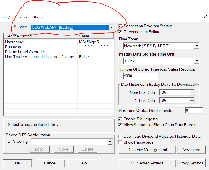

I changed the package from 5 to 11 today, according to the description I also see the [M].
But the strange thing is, why does it work when I selected CQG WebAPI in the Data/Trade Service Settings >> Service >> CQG WebAPI?
Am I still using CQG WebAPI?
And what do I have to set under the service so that I can use Denali?
Looking forward to the answer.
Best regards
Fingerlos Mario

Habakuk2020 - Posts: 10
I repeat myself again, because I still don't have an answer to my specific question.
But I would be happy to send you a screenshot, which is why I am puzzled and ask whether I have the Denali Feed running at all now!
Best regards
Fingerlos Mario

John - SC Support - Posts: 48095
Sierra Chart is setup to allow you to get the data from us and trade with a different trading service.
The specific control for whether to use the data feeds from Sierra Chart is the following:
Data/Trade Service Settings: Allow Support for Sierra Chart Data Feeds (Global Settings >> Data/Trade Service Settings >> Common Settings >> Common Other Settings)
Please answer my question directly, even if you tell me that Sierra Chart allows you to work with another trading service.
Please read my question, I already know the site (I know about the [M]).
CQG WebAPI is set (see screenshot), do I have DenaliFeed running now or do I have to change something else?
Please respond to the question.
If you know about the [M] symbol, then you know that when you have that showing, you are getting the data from us and not from your trading service.
For more information on this topic, refer to the following:
Real-Time Exchange Data Feeds Available From Sierra Chart: Integration with Trading Services
