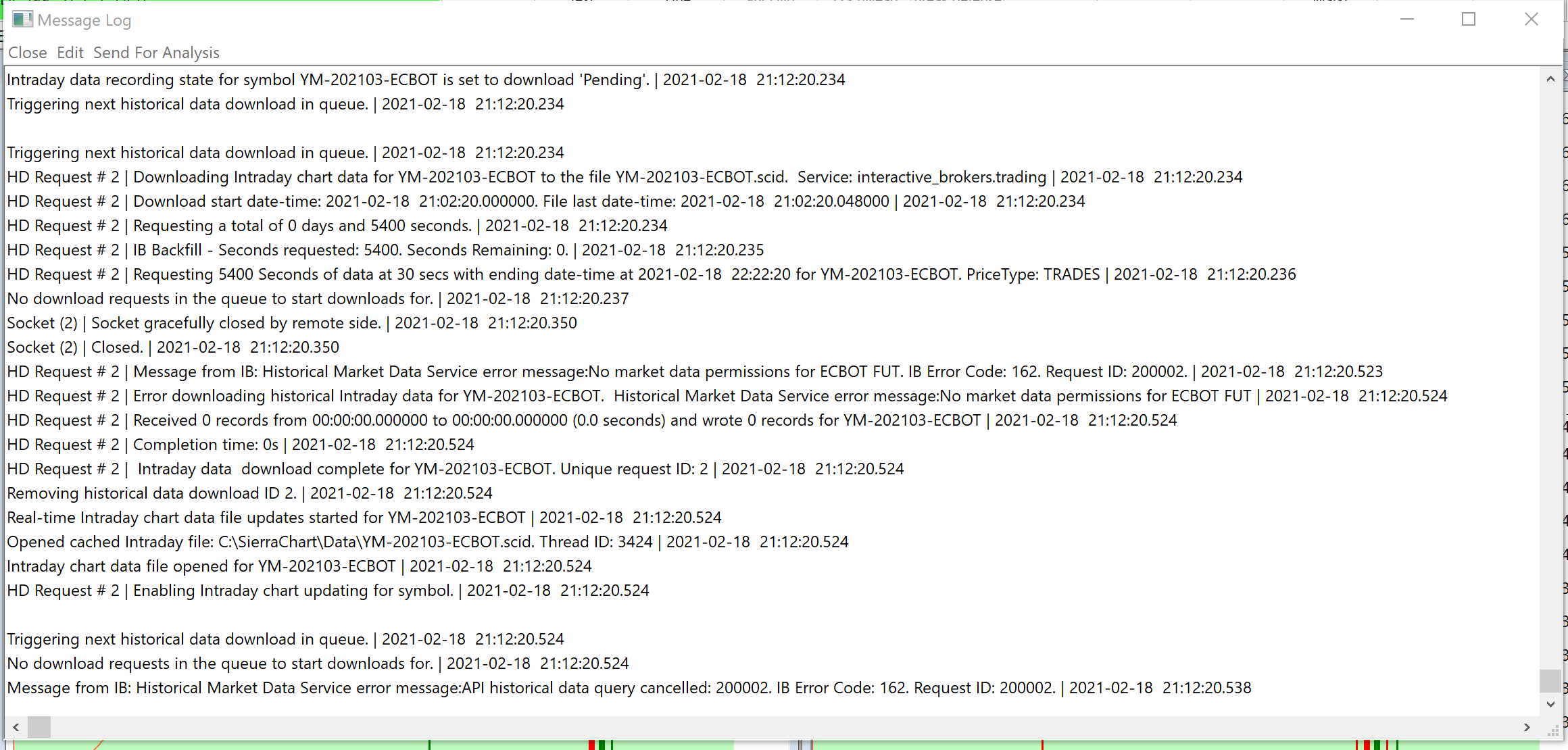

Thanks, I tried th force login, but it didnt work. I checked the messages log, see the attachjed screenshot. Maybe this helps to find the issue. Addditionally, I also use the DAX-202103-DTB-EUR-25[M] datafeed and that one works fine.
Look forward to hear from you.
imageSchermafbeelding 2021-02-18 om 21.16.32.png / V - Attached On 2021-02-18 20:20:04 UTC - Size: 267.89 KB - 366 views

Can you please get us the entire Message Log following these instructions:
Open a chart for the symbol you have an issue with. Tell us that symbol of the chart.

We do not think that is the case. We need to get the message log.
Could you please follow the instructions below.
Reconnect to the data feed:

Software version: 2230 64-bit | 2021-02-22 13:10:54.746
Primary Thread ID: 2804 | 2021-02-22 13:10:54.746
Usage end date: 2021-12-09 | 2021-02-22 13:10:54.746
Enabled for: Sierra Chart Historical Data Service. | 2021-02-22 13:10:54.746
Enabled for: Sierra Chart Real-Time Exchange Data Feed. | 2021-02-22 13:10:54.746
Enabled for: Denali Real-Time Exchange Data Feed. | 2021-02-22 13:10:54.746
Enabled for: Delayed Denali Exchange Data Feed. | 2021-02-22 13:10:54.746
Enabled for exchange: Eurex with Market Depth | 2021-02-22 13:10:54.746
Enabled for exchange: Euronext Equities Delayed | 2021-02-22 13:10:54.746
Enabled for exchange2: CME (Trading Account Required) | 2021-02-22 13:10:54.746
Enabled for exchange2: CBOT (Trading Account Required) | 2021-02-22 13:10:54.746
Enabled for exchange2: COMEX (Trading Account Required) | 2021-02-22 13:10:54.746
Enabled for exchange2: NYMEX (Trading Account Required) | 2021-02-22 13:10:54.746
Enabled for exchange2: EUREX EOBI | 2021-02-22 13:10:54.746
Allow Support for Sierra Chart Data Feeds is enabled. | 2021-02-22 13:10:54.746
Current selected Data/Trading service: Interactive Brokers | 2021-02-22 13:10:54.746
Custom symbol settings values: enabled | 2021-02-22 13:10:54.746
Chart Update Interval: 500 | 2021-02-22 13:10:54.746
Intraday Data Storage Time Unit: 5 | 2021-02-22 13:10:54.746
Time Zone: +01:00:00 (CET+01CEST+01,M3.5.0/02:00,M10.5.0/03:00) | 2021-02-22 13:10:54.746
2021-02-22 12:10:54 Local computer time in UTC | 2021-02-22 13:10:54.746
2021-02-22 13:10:54 Local computer time in SC Time Zone | 2021-02-22 13:10:54.746
2021-02-22 12:09:02 Server time in UTC | 2021-02-22 13:10:54.746
Local computer UTC time and Server UTC time difference: 0 seconds. | 2021-02-22 13:10:54.746
Program path: C:\SierraChart\ | 2021-02-22 13:10:54.746
Data Files path: C:\SierraChart\Data\ | 2021-02-22 13:10:54.746
OS Version Number: 10.0 | 2021-02-22 13:10:54.746
Locale Setting: C | 2021-02-22 13:10:54.746
DLLs: UserContributedStudies_64.dll | 2021-02-22 13:10:54.749
Allowed protected custom studies: | 2021-02-22 13:10:54.749
YM-202103-ECBOT 90 Min #4 | Reloading chart. | 2021-02-22 13:11:26.012
YM-202103-ECBOT 20 Min #1 | Reloading chart. | 2021-02-22 13:11:26.093
YM-202103-ECBOT 7 Min 30 Sec #2 | Reloading chart. | 2021-02-22 13:11:26.150
YM-202103-ECBOT 2 Min #3 | Reloading chart. | 2021-02-22 13:11:26.327
YM-202103-ECBOT 45 Min #5 | Reloading chart. | 2021-02-22 13:11:26.373
YM-202103-ECBOT 7 Min 30 Sec #2 | Out of order timestamps detected. Chart tool drawings and some chart studies may not function properly. Prior Date Time: 2021-02-10 07:37:30. Next Bar Date Time: 2021-02-10 07:30:00. Filename: YM-202103-ECBOT.scid | 2021-02-22 13:11:26.754
YM-202103-ECBOT 20 Min #1 | Out of order timestamps detected. Chart tool drawings and some chart studies may not function properly. Prior Date Time: 2021-02-10 07:40:00. Next Bar Date Time: 2021-02-10 07:20:00. Filename: YM-202103-ECBOT.scid | 2021-02-22 13:11:26.801
YM-202103-ECBOT 90 Min #4 | StartDateTimeForLoadingOrderFills: 00:00:00 | 2021-02-22 13:11:26.842
YM-202103-ECBOT 20 Min #1 | StartDateTimeForLoadingOrderFills: 00:00:00 | 2021-02-22 13:11:27.067
YM-202103-ECBOT 2 Min #3 | Out of order timestamps detected. Chart tool drawings and some chart studies may not function properly. Prior Date Time: 2021-02-10 07:40:00. Next Bar Date Time: 2021-02-10 07:32:00. Filename: YM-202103-ECBOT.scid | 2021-02-22 13:11:27.099
YM-202103-ECBOT 7 Min 30 Sec #2 | StartDateTimeForLoadingOrderFills: 00:00:00 | 2021-02-22 13:11:27.183
YM-202103-ECBOT 45 Min #5 | StartDateTimeForLoadingOrderFills: 00:00:00 | 2021-02-22 13:11:27.458
YM-202103-ECBOT 2 Min #3 | StartDateTimeForLoadingOrderFills: 00:00:00 | 2021-02-22 13:11:27.624
Starting first historical Intraday data download. When complete another download will be done from the primary service. Symbol: YM-202103-ECBOT | 2021-02-22 13:11:53.652
Added historical Intraday data request for YM-202103-ECBOT to the queue. | 2021-02-22 13:11:53.653
Intraday data recording state for symbol YM-202103-ECBOT is set to download 'Pending'. | 2021-02-22 13:11:53.653
Triggering next historical data download in queue. | 2021-02-22 13:11:53.653
HD Request # 3 | Downloading Intraday chart data for YM-202103-ECBOT to the file YM-202103-ECBOT.scid. Service: cbot | 2021-02-22 13:11:53.653
HD Request # 3 | Download start date-time: 2021-02-22 11:58:00.000000. File last date-time: 2021-02-22 13:11:48.000000 | 2021-02-22 13:11:53.654
HD Request # 3 | Disabling Intraday chart updating for symbol. | 2021-02-22 13:11:53.654
HD Request # 3 | Using server: ds21.sierracharts.com port 10150 | 2021-02-22 13:11:53.654
Socket (2) | Creating socket. | 2021-02-22 13:11:53.705
Socket (2) | New receive buffer size: 5242880 | 2021-02-22 13:11:53.705
Socket (2) | Connecting to IP: 216.1.90.129. | 2021-02-22 13:11:53.705
HD Request # 3 | Setting DTC encoding to Binary VLS | 2021-02-22 13:11:53.976
HD Request # 3 | Sending historical data logon request message. | 2021-02-22 13:11:53.976
HD Request # 3 | Requesting Intraday data. Start date-time: 2021-02-22 11:58:00. Record interval: 5. Symbol: YMH21 | 2021-02-22 13:11:54.547
HD Request # 3 | Decompressing data. | 2021-02-22 13:11:54.673
HD Request # 3 | Receiving Intraday data for YM-202103-ECBOT starting at 2021-02-22 11:58:02.439000 | 2021-02-22 13:11:54.684
HD Request # 3 | Truncating file to starting date-time of 2021-02-22 11:58:02.439 | 2021-02-22 13:11:54.684
Socket (2) | CloseSocket call. | 2021-02-22 13:11:54.805
Socket (2) | 0 bytes remaining in receive buffer when socket closed. | 2021-02-22 13:11:54.805
Socket (2) | Shutdown started. Waiting for graceful close. | 2021-02-22 13:11:54.805
Historical data download thread signaled to stop. | 2021-02-22 13:11:54.805
HD Request # 3 | Timestamp of first Intraday data file record written: 2021-02-22 11:58:02.439000 | 2021-02-22 13:11:54.806
HD Request # 3 | Received 638 records from 2021-02-22 11:58:02.439000 to 2021-02-22 13:01:50.839000 (63.8 minutes) and wrote 638 records for YM-202103-ECBOT | 2021-02-22 13:11:54.806
HD Request # 3 | Completion time: 1s | 2021-02-22 13:11:54.815
HD Request # 3 | Intraday data download complete for YM-202103-ECBOT. Unique request ID: 3 | 2021-02-22 13:11:54.815
Removing historical data download ID 3. | 2021-02-22 13:11:54.815
Real-time Intraday chart data file updates started for YM-202103-ECBOT | 2021-02-22 13:11:54.815
Opened cached Intraday file: C:\SierraChart\Data\YM-202103-ECBOT.scid. Thread ID: 2804 | 2021-02-22 13:11:54.815
Intraday chart data file opened for YM-202103-ECBOT | 2021-02-22 13:11:54.815
HD Request # 3 | Enabling Intraday chart updating for symbol. | 2021-02-22 13:11:54.815
YM-202103-ECBOT 90 Min #4 | Flagging to reload Intraday data on download completion. | 2021-02-22 13:11:54.815
YM-202103-ECBOT 20 Min #1 | Flagging to reload Intraday data on download completion. | 2021-02-22 13:11:54.815
YM-202103-ECBOT 7 Min 30 Sec #2 | Flagging to reload Intraday data on download completion. | 2021-02-22 13:11:54.815
YM-202103-ECBOT 2 Min #3 | Flagging to reload Intraday data on download completion. | 2021-02-22 13:11:54.815
YM-202103-ECBOT 45 Min #5 | Flagging to reload Intraday data on download completion. | 2021-02-22 13:11:54.815
Interactive Brokers | Using primary service for historical data for YM-202103-ECBOT | 2021-02-22 13:11:54.815
Added historical Intraday data request for YM-202103-ECBOT to the queue. | 2021-02-22 13:11:54.815
Intraday data recording state for symbol YM-202103-ECBOT is set to download 'Pending'. | 2021-02-22 13:11:54.815
Triggering next historical data download in queue. | 2021-02-22 13:11:54.815
HD Request # 4 | Downloading Intraday chart data for YM-202103-ECBOT to the file YM-202103-ECBOT.scid. Service: interactive_brokers.trading | 2021-02-22 13:11:54.815
HD Request # 4 | Download start date-time: 2021-02-22 13:01:50.000000. File last date-time: 2021-02-22 13:01:50.839000 | 2021-02-22 13:11:54.816
HD Request # 4 | Requesting a total of 0 days and 5404 seconds. | 2021-02-22 13:11:54.816
HD Request # 4 | IB Backfill - Seconds requested: 5404. Seconds Remaining: 0. | 2021-02-22 13:11:54.816
HD Request # 4 | Requesting 5404 Seconds of data at 30 secs with ending date-time at 2021-02-22 14:21:54 for YM-202103-ECBOT. PriceType: TRADES | 2021-02-22 13:11:54.816
No download requests in the queue to start downloads for. | 2021-02-22 13:11:54.816
Socket (2) | Socket gracefully closed by remote side. | 2021-02-22 13:11:54.925
Socket (2) | Closed. | 2021-02-22 13:11:54.926
YM-202103-ECBOT 20 Min #1 | Reloading chart. | 2021-02-22 13:11:55.007
YM-202103-ECBOT 7 Min 30 Sec #2 | Reloading chart. | 2021-02-22 13:11:55.179

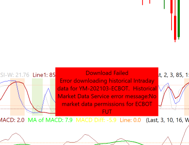

HD Request # 4 | Message from IB: Historical Market Data Service error message:No market data permissions for ECBOT FUT. IB Error Code: 162. Request ID: 200003. | 2021-02-22 13:11:55.183
HD Request # 4 | Error downloading historical Intraday data for YM-202103-ECBOT. Historical Market Data Service error message:No market data permissions for ECBOT FUT | 2021-02-22 13:11:55.183
HD Request # 4 | Received 0 records from 00:00:00.000000 to 00:00:00.000000 (0.0 seconds) and wrote 0 records for YM-202103-ECBOT | 2021-02-22 13:11:55.183
HD Request # 4 | Completion time: 1s | 2021-02-22 13:11:55.183
HD Request # 4 | Intraday data download complete for YM-202103-ECBOT. Unique request ID: 4 | 2021-02-22 13:11:55.183
Removing historical data download ID 4. | 2021-02-22 13:11:55.183
Real-time Intraday chart data file updates started for YM-202103-ECBOT | 2021-02-22 13:11:55.183
Opened cached Intraday file: C:\SierraChart\Data\YM-202103-ECBOT.scid. Thread ID: 2804 | 2021-02-22 13:11:55.184
Intraday chart data file opened for YM-202103-ECBOT | 2021-02-22 13:11:55.184
HD Request # 4 | Enabling Intraday chart updating for symbol. | 2021-02-22 13:11:55.184
Triggering next historical data download in queue. | 2021-02-22 13:11:55.184
No download requests in the queue to start downloads for. | 2021-02-22 13:11:55.184
YM-202103-ECBOT 2 Min #3 | Reloading chart. | 2021-02-22 13:11:55.478
YM-202103-ECBOT 45 Min #5 | Reloading chart. | 2021-02-22 13:11:55.492
YM-202103-ECBOT 90 Min #4 | Reloading chart. | 2021-02-22 13:11:55.524
YM-202103-ECBOT 20 Min #1 | Out of order timestamps detected. Chart tool drawings and some chart studies may not function properly. Prior Date Time: 2021-02-10 07:40:00. Next Bar Date Time: 2021-02-10 07:20:00. Filename: YM-202103-ECBOT.scid | 2021-02-22 13:11:55.555
YM-202103-ECBOT 7 Min 30 Sec #2 | Out of order timestamps detected. Chart tool drawings and some chart studies may not function properly. Prior Date Time: 2021-02-10 07:37:30. Next Bar Date Time: 2021-02-10 07:30:00. Filename: YM-202103-ECBOT.scid | 2021-02-22 13:11:55.741
YM-202103-ECBOT 20 Min #1 | StartDateTimeForLoadingOrderFills: 00:00:00 | 2021-02-22 13:11:55.784
YM-202103-ECBOT 7 Min 30 Sec #2 | StartDateTimeForLoadingOrderFills: 00:00:00 | 2021-02-22 13:11:55.875
YM-202103-ECBOT 2 Min #3 | Out of order timestamps detected. Chart tool drawings and some chart studies may not function properly. Prior Date Time: 2021-02-10 07:40:00. Next Bar Date Time: 2021-02-10 07:32:00. Filename: YM-202103-ECBOT.scid | 2021-02-22 13:11:56.159
YM-202103-ECBOT 45 Min #5 | StartDateTimeForLoadingOrderFills: 00:00:00 | 2021-02-22 13:11:56.347
YM-202103-ECBOT 90 Min #4 | StartDateTimeForLoadingOrderFills: 00:00:00 | 2021-02-22 13:11:56.428
Message from IB: No historical data query found for ticker id:200003. IB Error Code: 366. Request ID: 200003. | 2021-02-22 13:11:56.479
YM-202103-ECBOT 2 Min #3 | StartDateTimeForLoadingOrderFills: 00:00:00 | 2021-02-22 13:11:56.480

And after reconnecting to the datafeed, the message log lokks like this:
Software version: 2230 64-bit | 2021-02-22 18:48:40.249
Primary Thread ID: 1432 | 2021-02-22 18:48:40.249
Usage end date: 2021-12-09 | 2021-02-22 18:48:40.249
Enabled for: Sierra Chart Historical Data Service. | 2021-02-22 18:48:40.249
Enabled for: Sierra Chart Real-Time Exchange Data Feed. | 2021-02-22 18:48:40.249
Enabled for: Denali Real-Time Exchange Data Feed. | 2021-02-22 18:48:40.249
Enabled for: Delayed Denali Exchange Data Feed. | 2021-02-22 18:48:40.249
Enabled for exchange: Eurex with Market Depth | 2021-02-22 18:48:40.249
Enabled for exchange: Euronext Equities Delayed | 2021-02-22 18:48:40.249
Enabled for exchange2: CME (Trading Account Required) | 2021-02-22 18:48:40.249
Enabled for exchange2: CBOT (Trading Account Required) | 2021-02-22 18:48:40.249
Enabled for exchange2: COMEX (Trading Account Required) | 2021-02-22 18:48:40.249
Enabled for exchange2: NYMEX (Trading Account Required) | 2021-02-22 18:48:40.249
Enabled for exchange2: EUREX EOBI | 2021-02-22 18:48:40.249
Allow Support for Sierra Chart Data Feeds is enabled. | 2021-02-22 18:48:40.249
Current selected Data/Trading service: Interactive Brokers | 2021-02-22 18:48:40.249
Custom symbol settings values: enabled | 2021-02-22 18:48:40.249
Chart Update Interval: 500 | 2021-02-22 18:48:40.249
Intraday Data Storage Time Unit: 5 | 2021-02-22 18:48:40.249
Time Zone: +01:00:00 (CET+01CEST+01,M3.5.0/02:00,M10.5.0/03:00) | 2021-02-22 18:48:40.249
2021-02-22 17:48:40 Local computer time in UTC | 2021-02-22 18:48:40.249
2021-02-22 18:48:40 Local computer time in SC Time Zone | 2021-02-22 18:48:40.249
2021-02-22 17:42:34 Server time in UTC | 2021-02-22 18:48:40.249
Local computer UTC time and Server UTC time difference: 3 seconds. | 2021-02-22 18:48:40.249
Program path: C:\SierraChart\ | 2021-02-22 18:48:40.249
Data Files path: C:\SierraChart\Data\ | 2021-02-22 18:48:40.249
OS Version Number: 10.0 | 2021-02-22 18:48:40.249
Locale Setting: C | 2021-02-22 18:48:40.249
DLLs: UserContributedStudies_64.dll | 2021-02-22 18:48:40.250
Allowed protected custom studies: | 2021-02-22 18:48:40.250
Interactive Brokers | Connecting to 127.0.0.1:7497 | 2021-02-22 18:49:46.822
IB TWS socket (1) | Creating socket. | 2021-02-22 18:49:46.822
IB TWS socket (1) | New receive buffer size: 5242880 | 2021-02-22 18:49:46.823
IB TWS socket (1) | Connecting to IP: 127.0.0.1. | 2021-02-22 18:49:46.823
Interactive Brokers | Sending API sign: API | 2021-02-22 18:49:47.333
Interactive Brokers | Sending client version: v100..136 +PACEAPI. Waiting for acceptance. | 2021-02-22 18:49:47.333
Interactive Brokers | TWS server version: 136 | 2021-02-22 18:49:47.344
Interactive Brokers | TWS time: 20210222 18:49:46 CET | 2021-02-22 18:49:47.344
Interactive Brokers | Connected. Sending Start API command. | 2021-02-22 18:49:47.603
Interactive Brokers | Waiting for account information. | 2021-02-22 18:49:47.603
Next valid order ID: 1 | 2021-02-22 18:49:47.609
Message from IB: Market data farm connection is OK:usfarm.nj. IB Error Code: 2104. Request ID: -1. | 2021-02-22 18:49:47.609
Message from IB: Market data farm connection is OK:cashfarm. IB Error Code: 2104. Request ID: -1. | 2021-02-22 18:49:47.609
Message from IB: Market data farm connection is OK:usfarm. IB Error Code: 2104. Request ID: -1. | 2021-02-22 18:49:47.609
Message from IB: HMDS data farm connection is OK:ushmds. IB Error Code: 2106. Request ID: -1. | 2021-02-22 18:49:47.610
Message from IB: Sec-def data farm connection is OK:secdefil. IB Error Code: 2158. Request ID: -1. | 2021-02-22 18:49:47.610
IB Account information received. | 2021-02-22 18:49:47.610
Interactive Brokers | Received 1 Trade Accounts from TWS. | 2021-02-22 18:49:47.610
Interactive Brokers | Connected to Demo or Simulated account. | 2021-02-22 18:49:47.610
Interactive Brokers | Connected to server complete. | 2021-02-22 18:49:47.610
Triggering next historical data download in queue. | 2021-02-22 18:49:47.610
Notice: Not connected to Live trading account to receive CME realtime futures data at non-professional fees. | 2021-02-22 18:49:47.610
No download requests in the queue to start downloads for. | 2021-02-22 18:49:47.610
Next valid order ID: 1 | 2021-02-22 18:49:47.612
Interactive Brokers | Requesting Trade Positions snapshot and updates (IB account data updates (6)) for account: DU32* | 2021-02-22 18:49:52.781
Interactive Brokers | Received Trade Positions download end message for account DU32* | 2021-02-22 18:49:52.802
Interactive Brokers | Begin Trade Positions processing. | 2021-02-22 18:49:52.802
Interactive Brokers | Received Trade Positions for all accounts. Performing final processing. | 2021-02-22 18:49:52.802

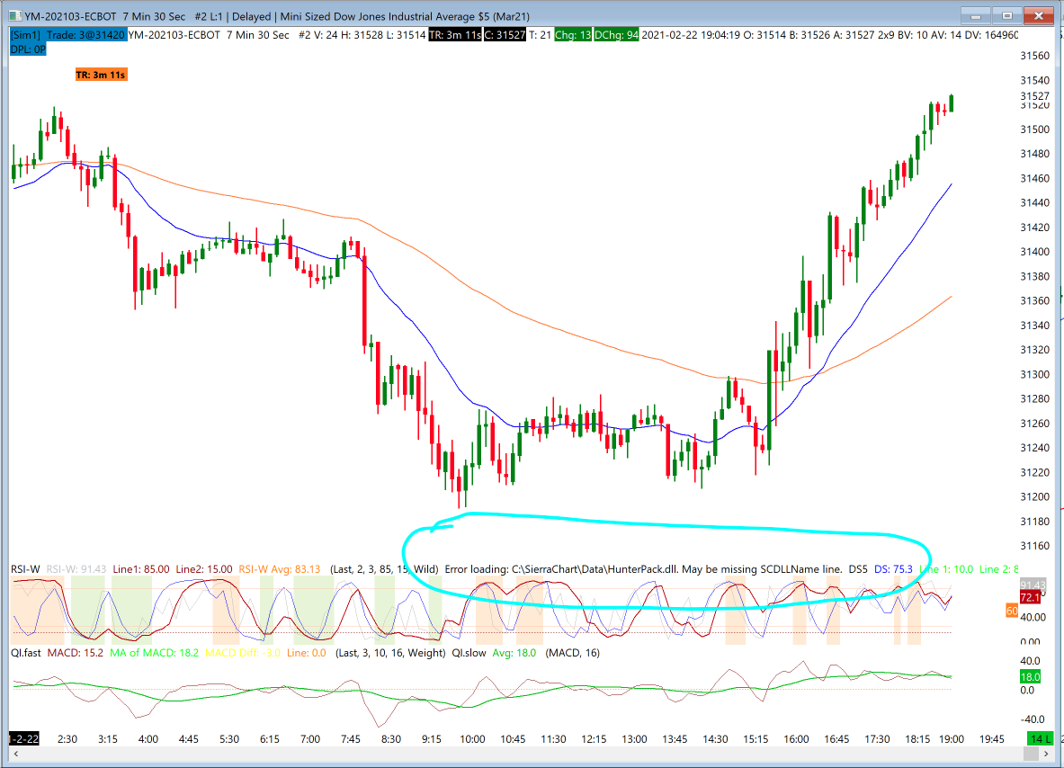

[2021-02-22 18:08:45]
User418920 - Posts: 31
Maybe the error message in the chart has something to do with it? See attached screenshot.
