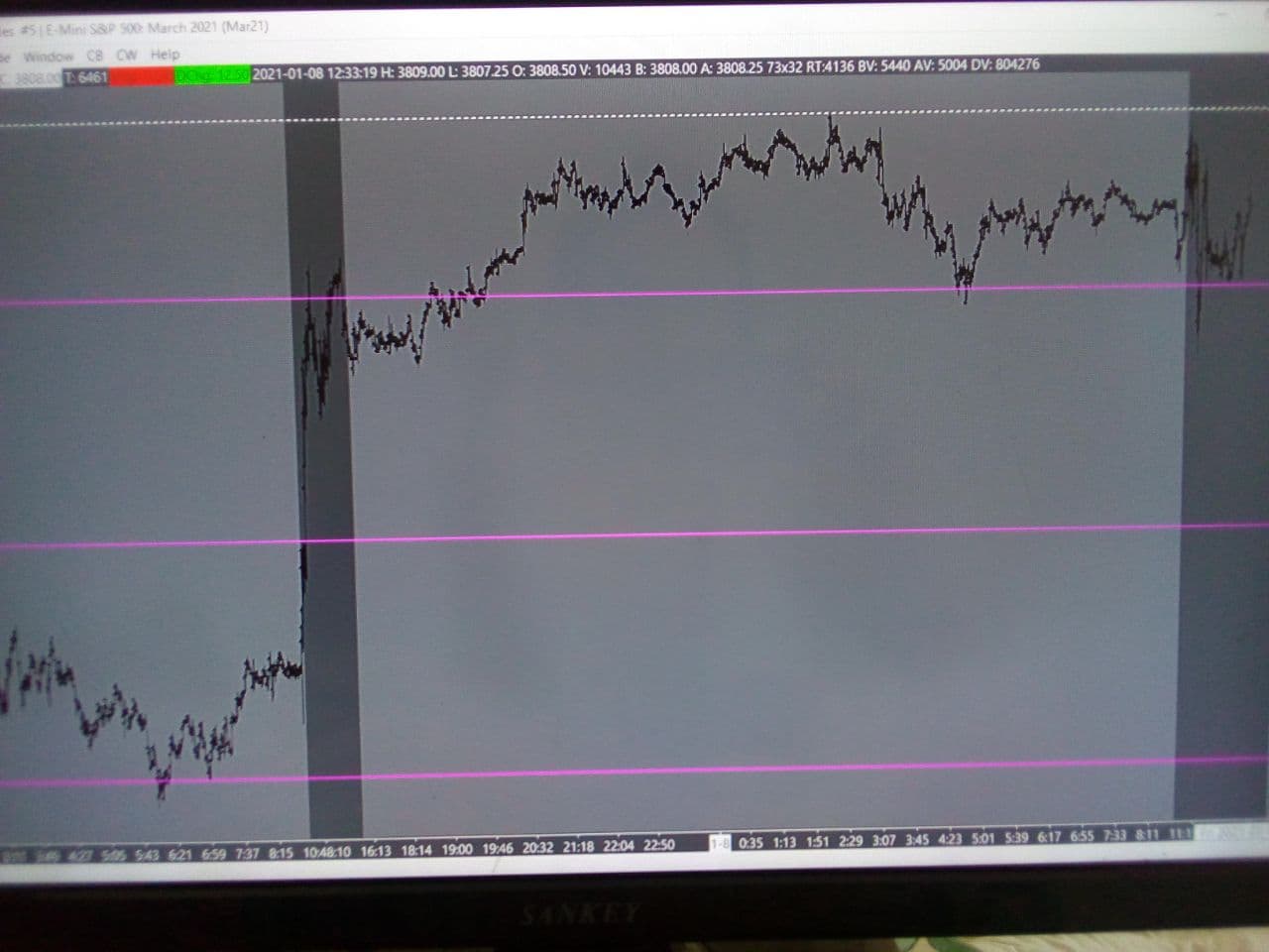

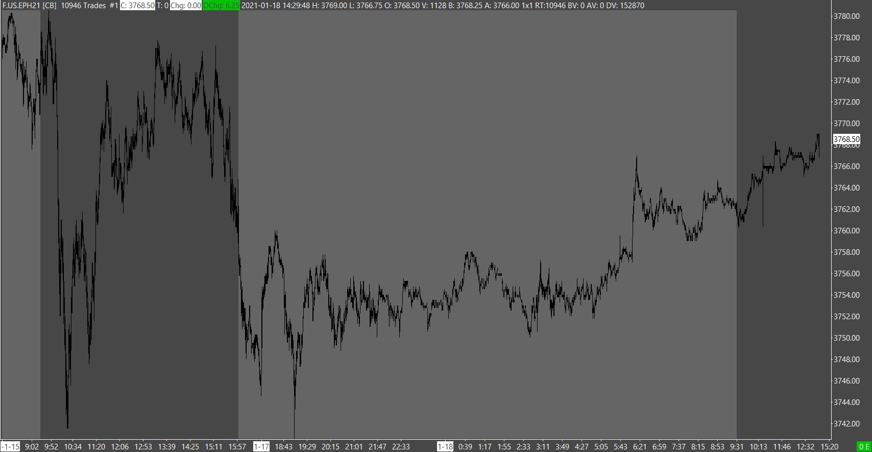

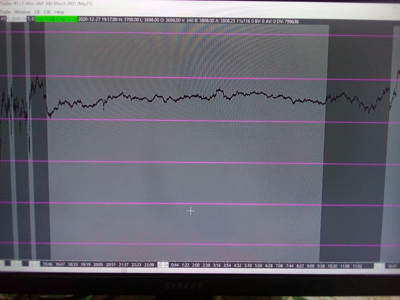

Saludos desde el 23 de Diciembre tube cambios el como veo mi pre mercado y la sesión cash, el pre mercado se ve mucho mas grande, esto esta afectando mi análisis.
Les voy a pasar unas imagenes para que sepan de que les estoy hablando. En las imagenes el color gris claro corresponde al pre mercado y el color gris oscuro corresponde a la sesion cash.
imagephoto_2021-01-08_12-28-31.jpg / V - Attached On 2021-01-12 18:19:53 UTC - Size: 236.83 KB - 351 views

Greetings from December 23, I have changed how I see my pre market and the cash session, the pre market looks much bigger, this is affecting my analysis.
I'm going to give you some pictures so you know what I'm talking about. In the images the light gray color corresponds to the pre market and the dark gray color corresponds to the cash session.
What is the timeframe of the chart?
What are your Session Times and Time Zone set to?

Saludos el periodo de tiempo de las imágenes que envié es un grafico de 10946 transacciones.
Los horarios de sesión son de 9:30am a 4:00pm hora de Nueva York

Greetings the time period of the images that I sent is a graph of 10946 transactions.
Session times are 9:30 am to 4:00 pm New York time
We assume you are using the Evening Session option to define your Pre-Market. If this is correct, then make sure that your Session Times are entered properly. Given what you stated for the Day Session Times, make sure your times are entered as follows:
Day Session Start: 09:30:00
Day Session End: 15:59:59
Evening Session Start: 16:00:00
Evening Session End: 09:29:59
For more information, refer to the following:
Chart Session Times
We also recommend using the option New Bar at Session Start if you are not already doing so. Otherwise, the bar will not close until the full number of trades has completed even if it crosses between Evening and Day sessions. Refer to the information here:
Chart Settings: New Bar at Session Start (Chart >> Chart Settings >> Session Times >> Intraday Chart Session Times menu)
