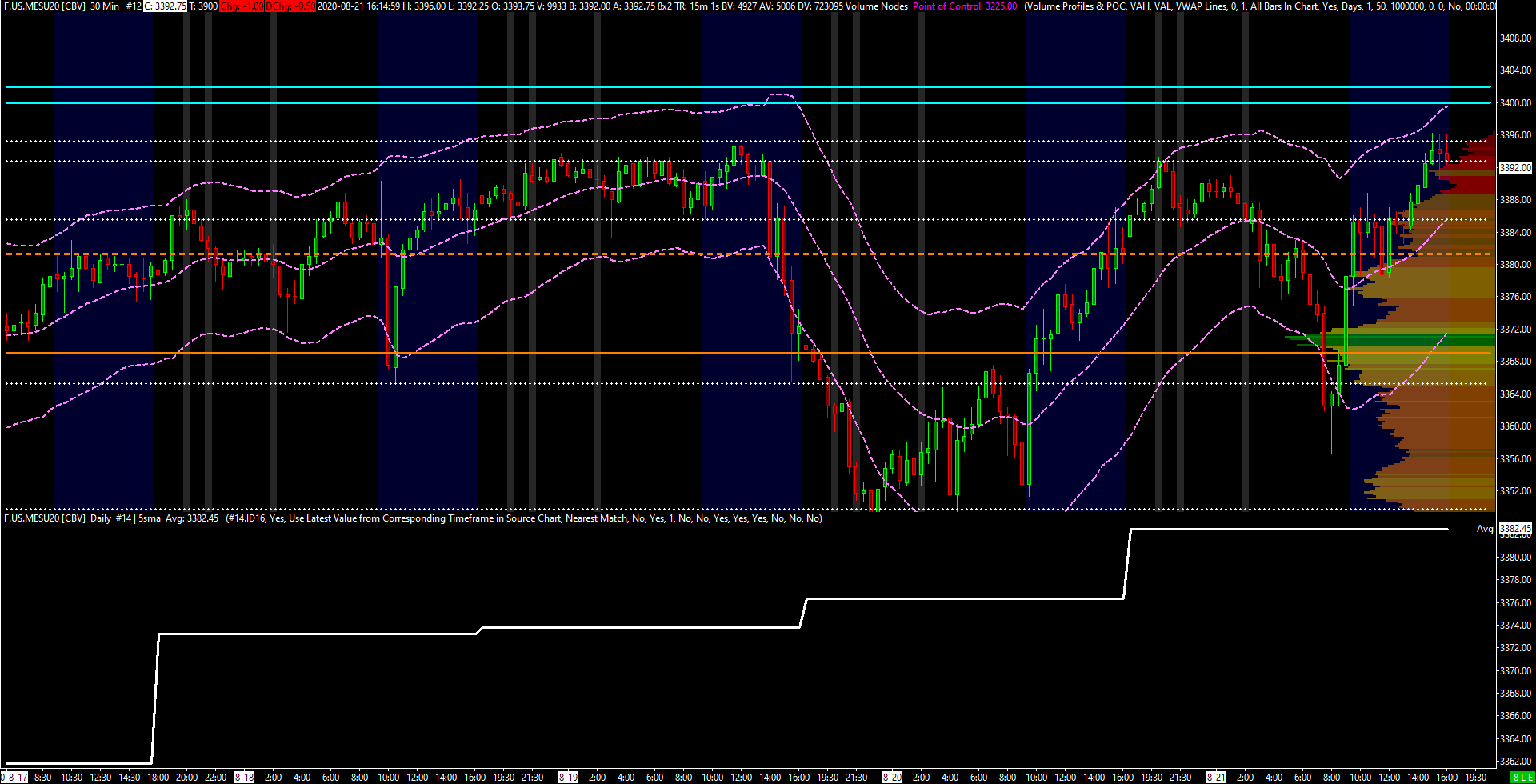

Tonight I have been trying to overlay a study from one chart to another (in the same chart book). What I want to achieve is that my moving averages & keltner from off my daily chart overlay onto my 30 min chart. I use the study/price overlay add the study, select the source chart in settings then choose the appropriate studies. I have attached a picture as to what happens when I do this. I want for example the 200sma from off the daily overlaid onto my 30 min chart, this is adding the study underneath. What am I doing wrong ? Picture shows the keltner & 100sma but not overlaid over the candles but separate, underneath.

[2020-08-25 00:43:12]
You need to set the region for the Study/Price Overlay to be Region 1. Refer to the information here:
Chart Studies: Settings and Inputs Tab >> Chart Region

User350698 - Posts: 35
