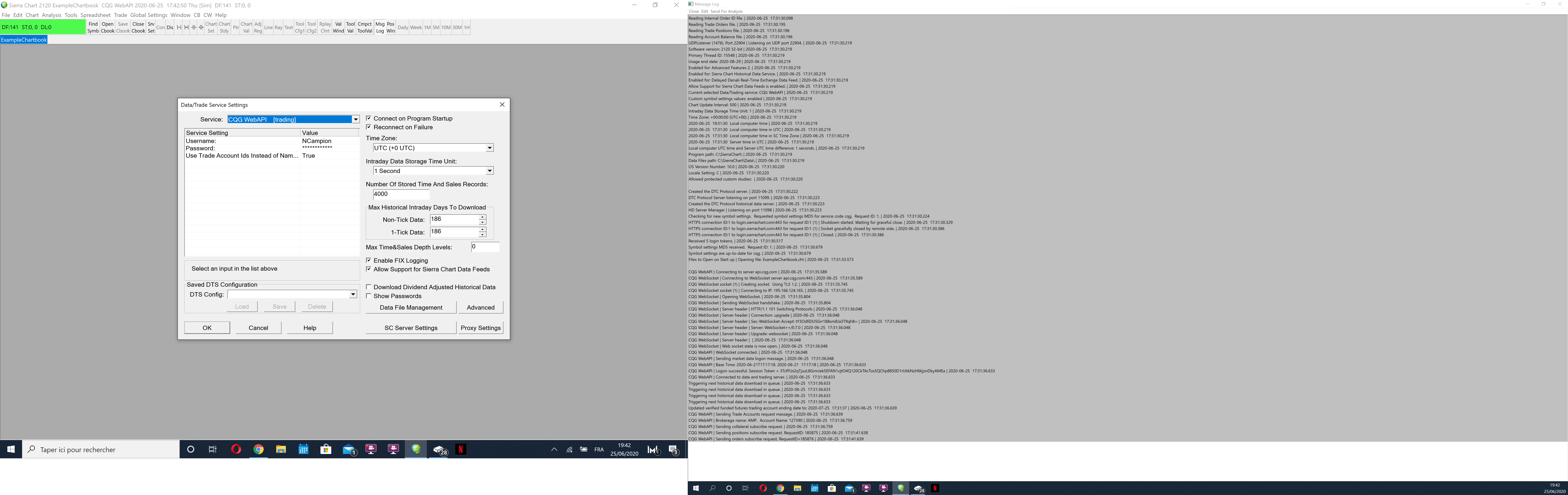

Yesterday in the middle of the day I had a problem on my plateform. I was in a trading session in simulation mode like I'm doing since a month and all my board juste crash and disapears. When I tried to reopened it I get an error message saying that I didn't have the data from the market. I'm currently with AMP as a broker and CQG for the market data. So I tried to contact them and they told me that they couldn't do anything because for them I was still connected to sierra chart. So I contact AMP too who told me to refer to CQG. But I'm really thinking that the problem is coming from sierra because all my chartbook are gone when I open the plateform is like the fisrt time that I opened it. And when try to reconnect my self to my account CQG into sierra I get a error message saying that it can't be done due to a current session. So after seeing your explanation I copy all the line that I have on my message log and put it there. I also make you some screenshot of my board.
I really don't understand why I get this problem I'm on my desk every day since the end of May and never have this kind of issue. Could you please came back me quickly ?

imageSIERRA PICTURE.png / V - Attached On 2020-06-26 08:44:50 UTC - Size: 1.45 MB - 392 views
imageSIERRA PICTURE 2.png / V - Attached On 2020-06-26 08:44:55 UTC - Size: 1.36 MB - 310 views
imageSIERRA PICTURE 3.png / V - Attached On 2020-06-26 08:45:00 UTC - Size: 1.54 MB - 309 views

I can't find my old chartbook even by following your instruction. Even the software has change I don't have my tool at the same place, I don't have the connecte/disconnect button at the same place..
Did you make an update on sierra ? If yes does it possible to get back the old version ? because I had a lot of trouble to get to know your plateform and I really dont want to do all again.
Couln't you just put back my version and my chart back directly ? I don't know but I paied for a service for 3 month I used it for a month without a problem. Yesterday your platform crash I loss every thing I have to do it all once again.....
[2020-06-26 11:25:22]
User736389 - Posts: 5
All my chartbook was saved under the name 'Formation.GTC' but know when I tried to open it first I get an error message due to the symbols saying that he doesn't recognize the symbols. But that is not the big issue. The biggest problem is that when I open it I don't get my old chartbook. I used to have 3 different things the TPO profile chart, the DOM and the Intraday chart of the Euro Bund but know I only have the chart of the euro Bund and is not the chart that I made is just the basic chart that you provide at the beginning
