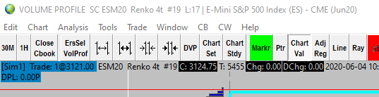

User677721 - Posts: 3
Finished setting up following all the steps.
I do not see an M symbol on my chart.
my symbols are coming as ESM20 without the -cme.
Jibin.
Date Time Of Last Edit: 2020-06-04 15:11:42
imageSierra.PNG / V - Attached On 2020-06-04 15:11:24 UTC - Size: 13.15 KB - 337 views
[2020-06-04 17:28:50]
Make sure that the option for Allow Support for Sierra Chart Data Feeds is enabled on the Data/Trade Service Settings window (File >> Data/Trade Service Settings).
Also follow these instructions to get us your Message Log:
Open a chart for the symbol you have an issue with. Tell us that symbol of the chart.
Additionally:
The reason you are not getting real-time data from the CME Group of exchanges is that you activated the Non-Professional exchange fees, but you have not verified that you have a live, funded, futures trading account, which the CME needs in order to allow you data at the lower priced fees.
Refer to the following for instructions on how to connect once a month to your *live funded* trading account to qualify for the lower-priced exchange fees:
If you do not have a funded trading account or one with a supported trading service, then refer to this solution:
Easy Solution to CME Funded Trading Account Requirement
We recommend using the above solution in any case to avoid this problem in the future.
