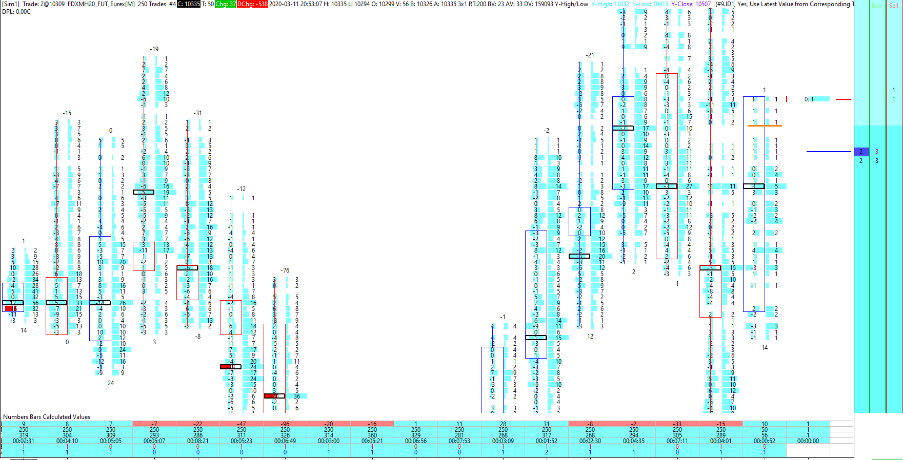

Hello cih I have a question: When I start on my sierra chart computer, I have no order book for two prices on the respective limit page.

We need to understand this better. Go to the chart for the symbol you have an issue with and open the market depth window with File >> Open Market Depth Window. Position the market depth window over the chart and then post an image of the chart including overlays:

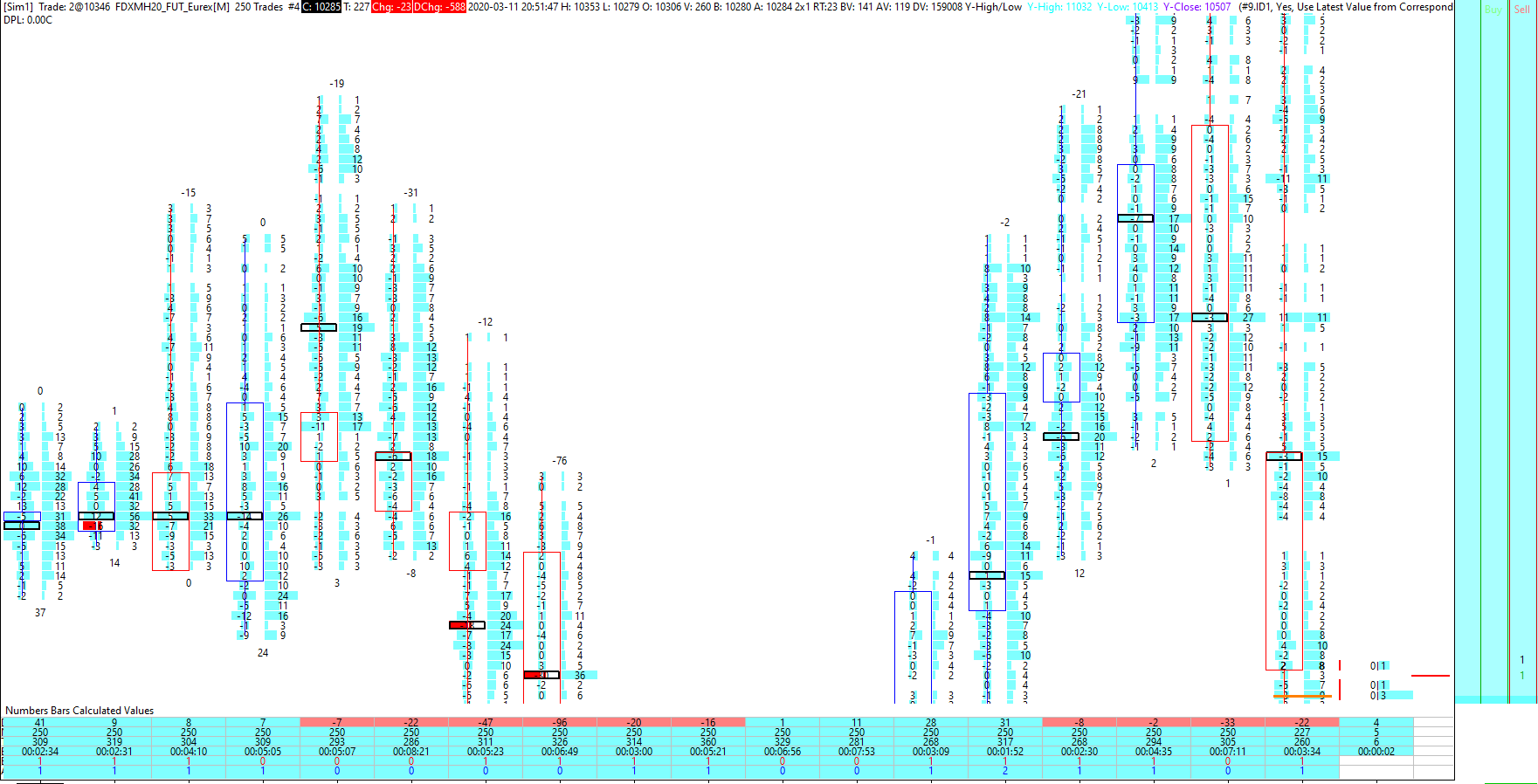

Hallo ich habe das "Market depth window" offen und habe ein screen image gemacht . Ich hoffe ich habe alles richtig gemacht .http://www.sierrachart.com/image.php?Image=1583956309607.png
[2020-03-11 19:53:17]
User871865 - Posts: 11
http://www.sierrachart.com/image.php?Image=1583956389650.png
[2020-03-11 19:53:50]
Links im Orderbuch sind nur zwei preise . Warum ?

[2020-03-27 21:28:19]
SC Data - All Services | Market Depth data has been rejected for symbol: FDXMM20_FUT_Eurex. Low bandwidth option enabled. | 2020-03-27 21:40:30.291
The above is the problem. You need to disable the low bandwidth option:
Real-Time Exchange Data Feeds Available From Sierra Chart: Low Bandwidth Option
This is also explained here:
File Menu: Not Receiving the Full Number of Market Depth Levels
Date Time Of Last Edit: 2020-03-27 21:29:39
