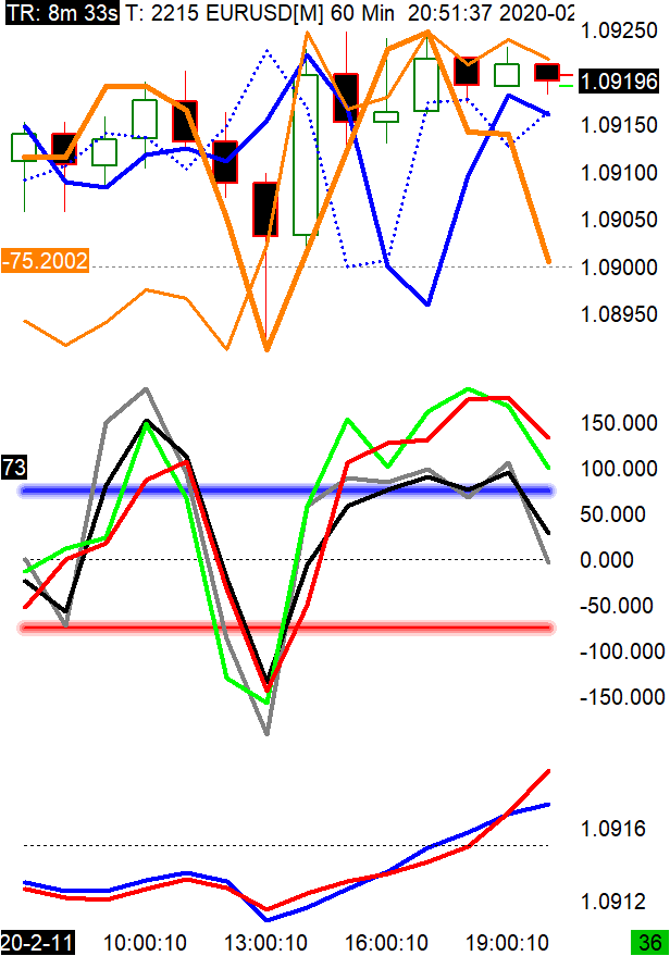

We use Green Charts in my company and yesterday we woke up and all the 64 bit charts had to be upgraded to version 2033 or higher because the custom studies stopped working. That was fixable. But somehow the region dividing lines between our different charts had disappeared. I tried checking the box under Charts>Advanced Settings>Display Region Dividing Lines but that does not work on our custom charts. Do you know why this has changed overnight and can it be fixed and returned to our charts? I haven't found anything in our studies that shows this dividing line and like I say it was removed from the charts sometime between Sunday night and Monday morning. I have attached a picture of a typical chart with the dividing lines missing, one above the middle chart and one below that chart. It seems they should have lined up with the dividing lines that separate the regions on the Interactive Scale. No one here seems to know what happened or how to fix this. Thanks for your help.

Already set that to Black under Global Settings > Graphics Settings. Didn't help and that wouldn't account for everyone else's computers having the same missing lines. This is not just my computer but everyone else at the company found the same problem Monday morning. I think it is an error that is affecting one of our studies but I don't know where to look or what was changed in the programming that made our dividing lines disappear. Does the image I sent from GreenCharts look at all familiar or maybe someone in support knows what to look for in the study? All I see under Studies to Graph is CalcOrder 1 through 18 and since the older versions of GreenChart are now showing the same problem, I can't compare this newest version to version 1852 which most traders were running before the required upgrade to 2033 for 64 bit users. Any ideas of where to start looking?

This is one of our basic charts. We are missing two black dividing lines that were above and below the middle chart. These lines showed the top and bottom of the range for the indicators in that part of the chart. It has happened in the old versions 32 bit and 64 bit and all the new versions. It happened on my charts when I rebooted my computer on Monday morning. Everyone else started noticing it about the same time. Something is missing in our studies or maybe one of our study collections. I have attached one of the basic chartbooks (6 Major) and will try and add one of the original chartbooks that downloads when we update (EURUSD Simple Linked). I hope this helps because our support team is on a cruise this week and we are fending for ourselves.

I found these pictures of our charts before the lines disappeared and our studies changed. You can clearly see them above and below the middle indicators. These lines were also adjustable in our studies as I believe we could change the color and the width/size of the lines. I hope this helps with your determination of the problem.

I am sorry to disagree with you but how did everyone's charts in my company lose that dividing line at the same time? It makes no sense that everyone's dividing line option got disabled on Monday morning. And if you look at the lines on the charts I sent, they do not go all the way across like the dividing line. There is space between the end of the lines and the sides of the charts. And they are a thicker line. It was not your dividing line option it was part of one of our studies that got disabled with a new version of Green Charts. I will talk to my support people and have them contact you to figure out which study was changed. Thanks for the advice anyway but I checking that option doesn't fix our problem.

I just sent a report to our support people and told them where I think the problem lies. I think it is in the GreenChart_64.dll. I found an old copy of this file and copied it into my GreenChart/Data folder. I then made it read only because when I start GreenCharts I keep getting a new version of this file (from your server?). And this fixed our indicators.
The dividing lines came back and my charts looked like they did before Monday. Also noticed that in our studies ID:1 has two lines that read SG1 and SG2 and these are the missing dividing lines. But in version 2033 and later of GreenCharts, these are listed as Ignore under Draw Style instead of Line like they were before the upgrade.
