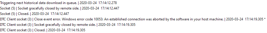

I believe that denali data feed is activated now but my charts are not printing new bars?
[2020-03-24 14:16:21]
User900297 - Posts: 22
This is my message log.
imageScreenshot_5.png / V - Attached On 2020-03-24 14:16:15 UTC - Size: 10.95 KB - 358 views
[2020-03-24 14:24:58]
Reconnect to the data feed:
[2020-03-24 14:35:41]
Software version: 2065 64-bit | 2020-03-24 17:30:15.790
Enabled for: Sierra Chart Historical Data Service. | 2020-03-24 17:30:15.790
Enabled for: Denali Real-Time Exchange Data Feed. | 2020-03-24 17:30:15.790
Enabled for: Delayed Denali Real-Time Exchange Data Feed. | 2020-03-24 17:30:15.790
Enabled for exchange2: CME | 2020-03-24 17:30:15.790
Allow Support for Sierra Chart Data Feeds is disabled. | 2020-03-24 17:30:15.790
Current selected Data/Trading service: SC Futures Order Routing/Data | 2020-03-24 17:30:15.790
Custom symbol settings values: enabled | 2020-03-24 17:30:15.790
Chart Update Interval: 500 | 2020-03-24 17:30:15.790
Intraday Data Storage Time Unit: 1 | 2020-03-24 17:30:15.790
Time Zone: +03:00:00 (TR+03) | 2020-03-24 17:30:15.790
2020-03-24 17:30:15 Local computer time | 2020-03-24 17:30:15.790
2020-03-24 14:30:15 Local computer time in UTC | 2020-03-24 17:30:15.790
2020-03-24 17:30:15 Local computer time in SC Time Zone | 2020-03-24 17:30:15.790
2020-03-24 14:06:17 Server time in UTC | 2020-03-24 17:30:15.790
Local computer UTC time and Server UTC time difference: 0 seconds. | 2020-03-24 17:30:15.790
Program path: C:\SierraChart\ | 2020-03-24 17:30:15.790
Data Files path: C:\SierraChart\Data\ | 2020-03-24 17:30:15.790
OS Version Number: 10.0 | 2020-03-24 17:30:15.790
Locale Setting: C | 2020-03-24 17:30:15.790
DLLs: UserContributedStudies.dll, UserContributedStudies_64.dll | 2020-03-24 17:30:15.790
File >> Disconnect selected. | 2020-03-24 17:30:25.467
DTC Client socket (1) | CloseSocket call. | 2020-03-24 17:30:25.468
DTC Client socket (1) | Shutdown started. Waiting for graceful close. | 2020-03-24 17:30:25.468
DTC Client socket (2) | CloseSocket call. | 2020-03-24 17:30:25.478
DTC Client socket (2) | Shutdown started. Waiting for graceful close. | 2020-03-24 17:30:25.478
SC DTC Delayed Exchange Data | Disconnected from the server. | 2020-03-24 17:30:25.478
SC Futures Order Routing/Data | Disconnected. | 2020-03-24 17:30:25.478
DTC Client socket (1) | Socket gracefully closed by remote side. | 2020-03-24 17:30:25.637
DTC Client socket (1) | Closed. | 2020-03-24 17:30:25.637
SC Futures Order Routing/Data | Connecting to the server futurestrading2.sierracharts.com. Port 11098 | 2020-03-24 17:30:39.603
DTC Client socket (1) | Creating socket. Using TLS 1.2. | 2020-03-24 17:30:39.719
DTC Client socket (1) | Connecting to IP: 208.185.224.129. | 2020-03-24 17:30:39.719
SC Futures Order Routing/Data | Connected to server. | 2020-03-24 17:30:39.882
SC Futures Order Routing/Data | Starting socket receive thread. | 2020-03-24 17:30:39.882
SC Futures Order Routing/Data | Sending encoding request to server: Binary VLS | 2020-03-24 17:30:39.882
SC Futures Order Routing/Data | Setting DTC encoding to Binary VLS | 2020-03-24 17:30:40.379
SC Futures Order Routing/Data | Sending logon request message. | 2020-03-24 17:30:40.379
SC Futures Order Routing/Data | Received logon response. | 2020-03-24 17:30:40.547
SC Futures Order Routing/Data | Server Name: SC DTC Server. | 2020-03-24 17:30:40.547
SC Futures Order Routing/Data | Server protocol version: 8. Client protocol version: 8 | 2020-03-24 17:30:40.547
SC Futures Order Routing/Data | Successfully connected. Connected to SC DTC Protocol server. Service=trading_technologies.trading|SymbolSettings=trading_technologies_v2.trading. | 2020-03-24 17:30:40.547
SC Futures Order Routing/Data | Trading is supported. | 2020-03-24 17:30:40.547
SC Futures Order Routing/Data | Order cancel and replace is supported. | 2020-03-24 17:30:40.547
SC Futures Order Routing/Data | OCO Orders supported. | 2020-03-24 17:30:40.547
SC Futures Order Routing/Data | Bracket Orders supported. | 2020-03-24 17:30:40.547
SC Futures Order Routing/Data | Connected to data and trading server. | 2020-03-24 17:30:40.547
Triggering next historical data download in queue. | 2020-03-24 17:30:40.547
Updated verified funded futures trading account ending date to: 2020-04-13 14:30:41 | 2020-03-24 17:30:40.547
Using SC exchange feed2. Symbol: NQ?##_FUT_CME | 2020-03-24 17:30:40.558
Mapping NQM20_FUT_CME to NQM20. Service code: cme | 2020-03-24 17:30:40.558
SC DTC Delayed Exchange Data | Starting real-time market data updates for: NQM20_FUT_CME (NQM20). ID: 1 Service code: cme | 2020-03-24 17:30:40.558
SC DTC Delayed Exchange Data | Connecting to the server ds21.sierracharts.com. Port 10044 | 2020-03-24 17:30:40.558
SC DTC Delayed Exchange Data | Requesting security definition data for: NQM20_FUT_CME (NQM20). ID: 1 | 2020-03-24 17:30:40.558
Using SC exchange feed2. Symbol: MNQ?##_FUT_CME | 2020-03-24 17:30:40.558
Mapping MNQM20_FUT_CME to MNQM20. Service code: cme | 2020-03-24 17:30:40.558
SC DTC Delayed Exchange Data | Starting real-time market data updates for: MNQM20_FUT_CME (MNQM20). ID: 2 Service code: cme | 2020-03-24 17:30:40.558
SC DTC Delayed Exchange Data | Requesting security definition data for: MNQM20_FUT_CME (MNQM20). ID: 2 | 2020-03-24 17:30:40.558
Added historical Intraday data request for NQM20_FUT_CME to the queue. | 2020-03-24 17:30:40.558
Intraday data recording state for symbol NQM20_FUT_CME is set to download 'Pending'. | 2020-03-24 17:30:40.558
Triggering next historical data download in queue. | 2020-03-24 17:30:40.558
DTC Client socket (3) | Creating socket. | 2020-03-24 17:30:40.558
DTC Client socket (3) | Connecting to IP: 216.1.90.129. | 2020-03-24 17:30:40.558
Delaying start of download for NQM20_FUT_CME | 2020-03-24 17:30:40.561
Using SC exchange feed2. Symbol: ES?##_FUT_CME | 2020-03-24 17:30:40.575
Mapping ESM20_FUT_CME to ESM20. Service code: cme | 2020-03-24 17:30:40.575
SC DTC Delayed Exchange Data | Starting real-time market data updates for: ESM20_FUT_CME (ESM20). ID: 3 Service code: cme | 2020-03-24 17:30:40.575
SC DTC Delayed Exchange Data | Requesting security definition data for: ESM20_FUT_CME (ESM20). ID: 3 | 2020-03-24 17:30:40.575
Using SC exchange feed2. Symbol: MES?##_FUT_CME | 2020-03-24 17:30:40.575
Mapping MESM20_FUT_CME to MESM20. Service code: cme | 2020-03-24 17:30:40.575
SC DTC Delayed Exchange Data | Starting real-time market data updates for: MESM20_FUT_CME (MESM20). ID: 4 Service code: cme | 2020-03-24 17:30:40.575
SC DTC Delayed Exchange Data | Requesting security definition data for: MESM20_FUT_CME (MESM20). ID: 4 | 2020-03-24 17:30:40.575
Added historical Intraday data request for ESM20_FUT_CME to the queue. | 2020-03-24 17:30:40.575
Intraday data recording state for symbol ESM20_FUT_CME is set to download 'Pending'. | 2020-03-24 17:30:40.575
Triggering next historical data download in queue. | 2020-03-24 17:30:40.575
SC DTC Delayed Exchange Data | Connected to server. | 2020-03-24 17:30:40.727
SC DTC Delayed Exchange Data | Starting socket receive thread. | 2020-03-24 17:30:40.727
SC DTC Delayed Exchange Data | Sending encoding request to server: Binary VLS | 2020-03-24 17:30:40.727
SC DTC Delayed Exchange Data | Setting DTC encoding to Binary VLS | 2020-03-24 17:30:40.900
SC DTC Delayed Exchange Data | Sending logon request message. | 2020-03-24 17:30:40.900
SC DTC Delayed Exchange Data | Received logon response. | 2020-03-24 17:30:41.521
SC DTC Delayed Exchange Data | Server Name: SC Realtime Server. | 2020-03-24 17:30:41.521
SC DTC Delayed Exchange Data | Server protocol version: 8. Client protocol version: 8 | 2020-03-24 17:30:41.521
SC DTC Delayed Exchange Data | Successfully connected. | 2020-03-24 17:30:41.521
SC DTC Delayed Exchange Data | Trading is not supported. | 2020-03-24 17:30:41.521
SC DTC Delayed Exchange Data | Restarting real-time data updates for symbol: ESM20_FUT_CME -> ESM20 | 2020-03-24 17:30:41.521
SC DTC Delayed Exchange Data | Restarting real-time data updates for symbol: MESM20_FUT_CME -> MESM20 | 2020-03-24 17:30:41.521
SC DTC Delayed Exchange Data | Restarting real-time data updates for symbol: MNQM20_FUT_CME -> MNQM20 | 2020-03-24 17:30:41.521
SC DTC Delayed Exchange Data | Restarting real-time data updates for symbol: NQM20_FUT_CME -> NQM20 | 2020-03-24 17:30:41.521
Opened cached Depth file: C:\SierraChart\Data\MarketDepthData\ESM20_FUT_CME.2020-03-24.depth | 2020-03-24 17:30:41.710
SC DTC Delayed Exchange Data | Received security definition for symbol ESM20_FUT_CME | 2020-03-24 17:30:41.710
SC DTC Delayed Exchange Data | Received security definition for symbol MESM20_FUT_CME | 2020-03-24 17:30:41.710
SC DTC Delayed Exchange Data | Received security definition for symbol MNQM20_FUT_CME | 2020-03-24 17:30:41.710
SC DTC Delayed Exchange Data | Received security definition for symbol NQM20_FUT_CME | 2020-03-24 17:30:41.710
DTC Client socket (2) | Close event error. Windows error code 10053: An established connection was aborted by the software in your host machine. | 2020-03-24 17:30:44.422 *
DTC Client socket (2) | Socket gracefully closed by remote side. | 2020-03-24 17:30:44.422
DTC Client socket (2) | Closed. | 2020-03-24 17:30:44.422
Requesting market depth updates for: ESM20_FUT_CME if supported. | 2020-03-24 17:30:45.542
Requesting market depth updates for: NQM20_FUT_CME if supported. | 2020-03-24 17:30:45.542
SC DTC Delayed Exchange Data | Clearing market depth for ESM20_FUT_CME | 2020-03-24 17:30:45.763
SC DTC Delayed Exchange Data | Clearing market depth for NQM20_FUT_CME | 2020-03-24 17:30:45.763
HD Request # 7 | Downloading Intraday chart data for NQM20_FUT_CME to the file NQM20_FUT_CME.scid. Service: cme | 2020-03-24 17:30:46.435
HD Request # 7 | Download start date-time: 2020-03-24 17:20:16.000 | 2020-03-24 17:30:46.435
HD Request # 7 | Using server: ds21.sierracharts.com port 10149 | 2020-03-24 17:30:46.435
Socket (2) | Creating socket. | 2020-03-24 17:30:46.435
Socket (2) | Connecting to IP: 216.1.90.129. | 2020-03-24 17:30:46.436
HD Request # 7 | Setting DTC encoding to Binary VLS | 2020-03-24 17:30:46.811
HD Request # 7 | Sending historical data logon request message. | 2020-03-24 17:30:46.811
HD Request # 7 | Requesting Intraday data. Start date-time: 2020-03-24 17:20:16. Record interval: 1. Symbol: NQM20 | 2020-03-24 17:30:47.429
HD Request # 7 | Decompressing data. | 2020-03-24 17:30:47.599
HD Request # 7 | Receiving Intraday data for NQM20_FUT_CME starting at 2020-03-24 17:20:16 | 2020-03-24 17:30:47.781
Socket (2) | CloseSocket call. | 2020-03-24 17:30:47.781
Socket (2) | Shutdown started. Waiting for graceful close. | 2020-03-24 17:30:47.781
Historical data download thread signaled to stop. | 2020-03-24 17:30:47.781
HD Request # 7 | Timestamp of first Intraday data file record written: 2020-03-24 17:20:16 | 2020-03-24 17:30:47.781
HD Request # 7 | Received 627 records from 2020-03-24 17:20:16.000 to 2020-03-24 17:30:44.000 (10.5 minutes) and wrote 627 records for NQM20_FUT_CME | 2020-03-24 17:30:47.782
HD Request # 7 | Completion time: 1s | 2020-03-24 17:30:47.785
HD Request # 7 | Intraday data download complete for NQM20_FUT_CME. Unique request ID: 7 | 2020-03-24 17:30:47.785
Removing historical data download ID 7. | 2020-03-24 17:30:47.785
Real-time Intraday chart data file updates started for NQM20_FUT_CME | 2020-03-24 17:30:47.785
Opened cached Intraday file: C:\SierraChart\Data\NQM20_FUT_CME.scid | 2020-03-24 17:30:47.785
Intraday chart data file opened for NQM20_FUT_CME | 2020-03-24 17:30:47.785
HD Request # 7 | Enabling Intraday chart updating for symbol. | 2020-03-24 17:30:47.785
Triggering next historical data download in queue. | 2020-03-24 17:30:47.785
HD Request # 8 | Downloading Intraday chart data for ESM20_FUT_CME to the file ESM20_FUT_CME.scid. Service: cme | 2020-03-24 17:30:47.786
HD Request # 8 | Download start date-time: 2020-03-24 17:20:16.000 | 2020-03-24 17:30:47.786
HD Request # 8 | Using server: ds23.sierracharts.com port 10150 | 2020-03-24 17:30:47.786
Socket (4) | Creating socket. | 2020-03-24 17:30:47.786
Socket (4) | Connecting to IP: 216.1.90.130. | 2020-03-24 17:30:47.786
Socket (2) | Socket gracefully closed by remote side. | 2020-03-24 17:30:47.951
Socket (2) | Closed. | 2020-03-24 17:30:47.951
HD Request # 8 | Setting DTC encoding to Binary VLS | 2020-03-24 17:30:48.209
HD Request # 8 | Sending historical data logon request message. | 2020-03-24 17:30:48.209
HD Request # 8 | Requesting Intraday data. Start date-time: 2020-03-24 17:20:16. Record interval: 1. Symbol: ESM20 | 2020-03-24 17:30:48.965
HD Request # 8 | Decompressing data. | 2020-03-24 17:30:49.154
HD Request # 8 | Receiving Intraday data for ESM20_FUT_CME starting at 2020-03-24 17:20:16 | 2020-03-24 17:30:49.374
Socket (4) | CloseSocket call. | 2020-03-24 17:30:49.374
Socket (4) | Shutdown started. Waiting for graceful close. | 2020-03-24 17:30:49.374
Historical data download thread signaled to stop. | 2020-03-24 17:30:49.374
HD Request # 8 | Timestamp of first Intraday data file record written: 2020-03-24 17:20:16 | 2020-03-24 17:30:49.374
HD Request # 8 | Received 629 records from 2020-03-24 17:20:16.000 to 2020-03-24 17:30:45.000 (10.5 minutes) and wrote 629 records for ESM20_FUT_CME | 2020-03-24 17:30:49.375
HD Request # 8 | Completion time: 2s | 2020-03-24 17:30:49.378
HD Request # 8 | Intraday data download complete for ESM20_FUT_CME. Unique request ID: 8 | 2020-03-24 17:30:49.378
Removing historical data download ID 8. | 2020-03-24 17:30:49.378
Real-time Intraday chart data file updates started for ESM20_FUT_CME | 2020-03-24 17:30:49.378
Opened cached Intraday file: C:\SierraChart\Data\ESM20_FUT_CME.scid | 2020-03-24 17:30:49.379
Intraday chart data file opened for ESM20_FUT_CME | 2020-03-24 17:30:49.379
HD Request # 8 | Enabling Intraday chart updating for symbol. | 2020-03-24 17:30:49.379
Triggering next historical data download in queue. | 2020-03-24 17:30:49.379
Socket (4) | Socket gracefully closed by remote side. | 2020-03-24 17:30:49.563
Socket (4) | Closed. | 2020-03-24 17:30:49.563
[2020-03-24 14:42:53]
Enable Global Settings >> Data/Trade Service Settings >> Allow Support for Sierra Chart Data Feeds
Then Reconnect:
[2020-03-24 14:49:54]
It seems working now, thank you.
