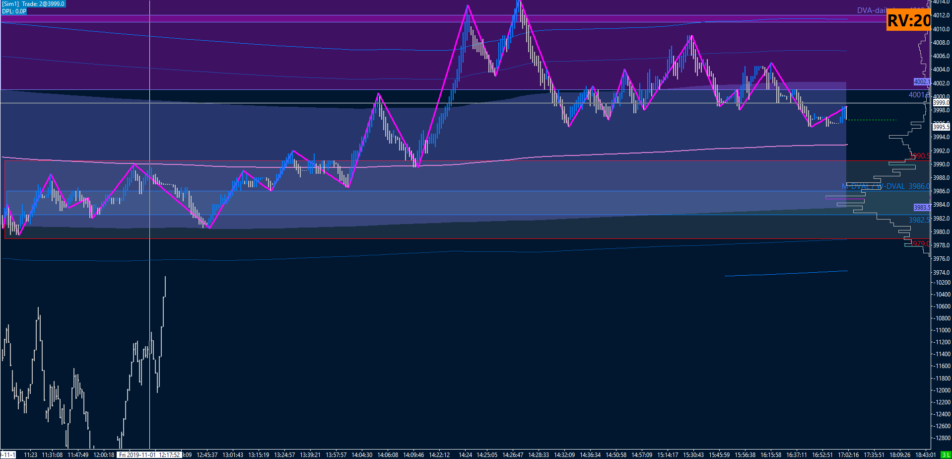

I´m not receiving the data for BMF. The charts are not been build.
I took a screen image: http://www.sierrachart.com/image.php?Image=1572871664469.png
Thank you.

As asked i´m sending the message log copy. I´m getting this problem only in the XDZ19 symbol form BMF.

[2019-11-05 17:06:09]
This was a Barchart data service problem. It has been resolved but there is some missing data. We will patch the missing data in the evening.

[2019-11-13 12:11:41]
User420291 - Posts: 44
Good morning. I´m having the same problem, but now it's on BMF symbol: UMZ19.
But now doesnt appear that im receiving the data.
Could you check please?
Thank you.
[2019-11-13 12:43:53]
Obviously Barchart is incompetent in this area. We will take care of the problem now. We apologize for their incompetence.
[2019-11-14 12:03:59]
Good morning, same problem again, in the same symbol.
[2019-11-14 12:15:02]
We have resolved this and we have sent the following message to Barchart in regards to this:
This problem is happening again yesterday and today. Please take care of this issue. We have some additional details. At this time, the data feed stopped providing any messages including heartbeats:
The data feed was lost. There was no activity for at least 10.0 minutes. | 2019-11-13 23:42:48.108
Connection to the external service has been lost. | 2019-11-13 23:42:48.108
After we reconnected, there were only 169 symbols on the feed and the new symbols were not delivered on the incremental feed. Please monitor for this. This is causing users trouble every morning now.
Until Barchart gets the issue resolved we have implemented a temporary patch.
Date Time Of Last Edit: 2019-11-14 12:20:30
[2019-11-14 12:15:59]
To download the missing data in the charts, follow the instructions here:
We have patched the missing data all the way back to Monday.
[2019-11-21 12:02:42]
Same problem again, but now its happening in DOLZ19 and UMZ19 symbols.
[2019-11-21 13:59:45]
This is now resolved.
We are looking into why it continues to happen because Barchart said they did resolve this.
Follow the instructions here to download missing data:

[2019-11-22 12:03:25]
Good morning, once agian the DOLZ19 and UMZ19 symbols are not working. Its becoming a serious problem for me.
Could you check again?
thank you.
[2019-11-22 12:45:46]
We are telling Barchart about this again. We have told Barchart that this is an unacceptable problem . We know it is a major issue. It is their responsibility to take care of it. There is nothing we can do at the moment until they resolve it now. We have asked Barchart to provide you a statement about the problem.
Date Time Of Last Edit: 2019-11-22 12:49:59
