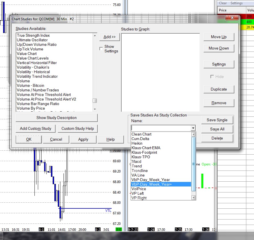

[2019-08-02 07:56:02]
kdpleiser2 - Posts: 12
Good morning dear service people. I do not want to annoy you but I copied everything exactly as directed but I do not see the new StdyCllct in the left window Analysis. If I look under "SaveStudies" it is there, but I do not get it in the left window to take it from there to the chart. So it exists in the directory .. \ Data and it is also displayed under "Save Studies" but not under "Studies Available" or "Add Custom Studies". What am I doing wrong???? THANK YOU for your great effort with me.
imageHeldental_135 2019-08-02 09.50.jpg / V - Attached On 2019-08-02 07:55:25 UTC - Size: 158.52 KB - 440 views
[2019-08-02 09:09:58]
imageHeldental_135 2019-08-02 09.50.jpg / V - Attached On 2019-08-02 07:50:58 UTC - Size: 158.52 KB - 480 views
[2019-08-02 14:39:02]
John - SC Support - Posts: 48552
In order to use the Study Collection select the Analysis pulldown menu in Sierra Chart, then down towards the bottom of that pulldown menu is the list of Study Collections available to you. You should see the one that you downloaded in there. Just select it from that pulldown menu and it will add it to your chart.
This is explained a little better in this section of the documentation:
Study Collections: Applying a Study Collection to a Chart
